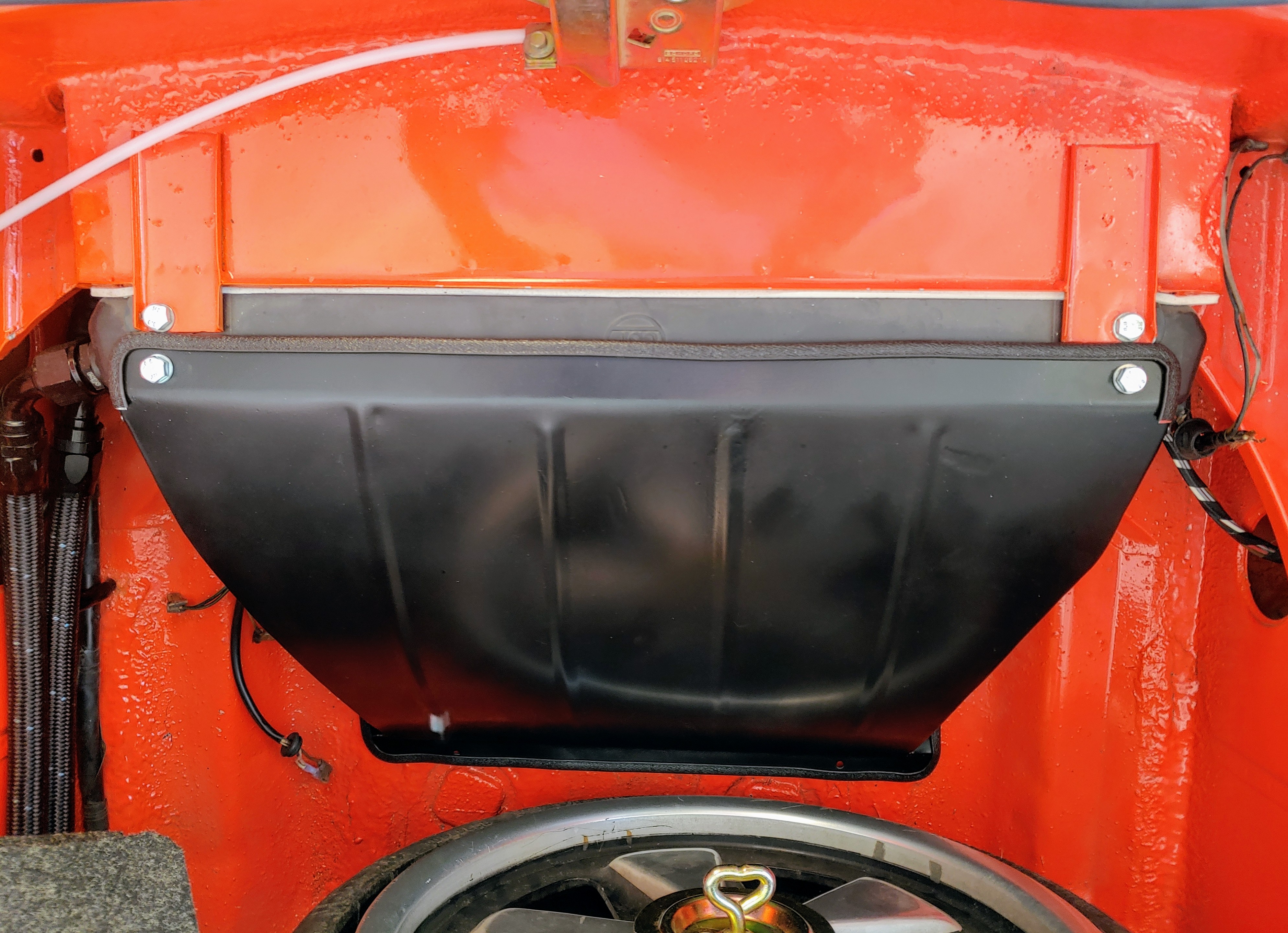

Looking for the correct front oil cooler, preferable Setrab, to mount in front. The Patrick Motorsports one is 21.5 x 4.25, so I am guessing that is the maximum size I can go. Looking for a cheaper or direct alternative rather than spend $450 on the PMS one.

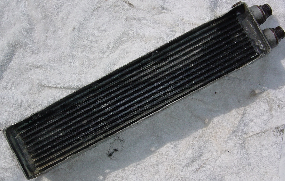

Retroracer

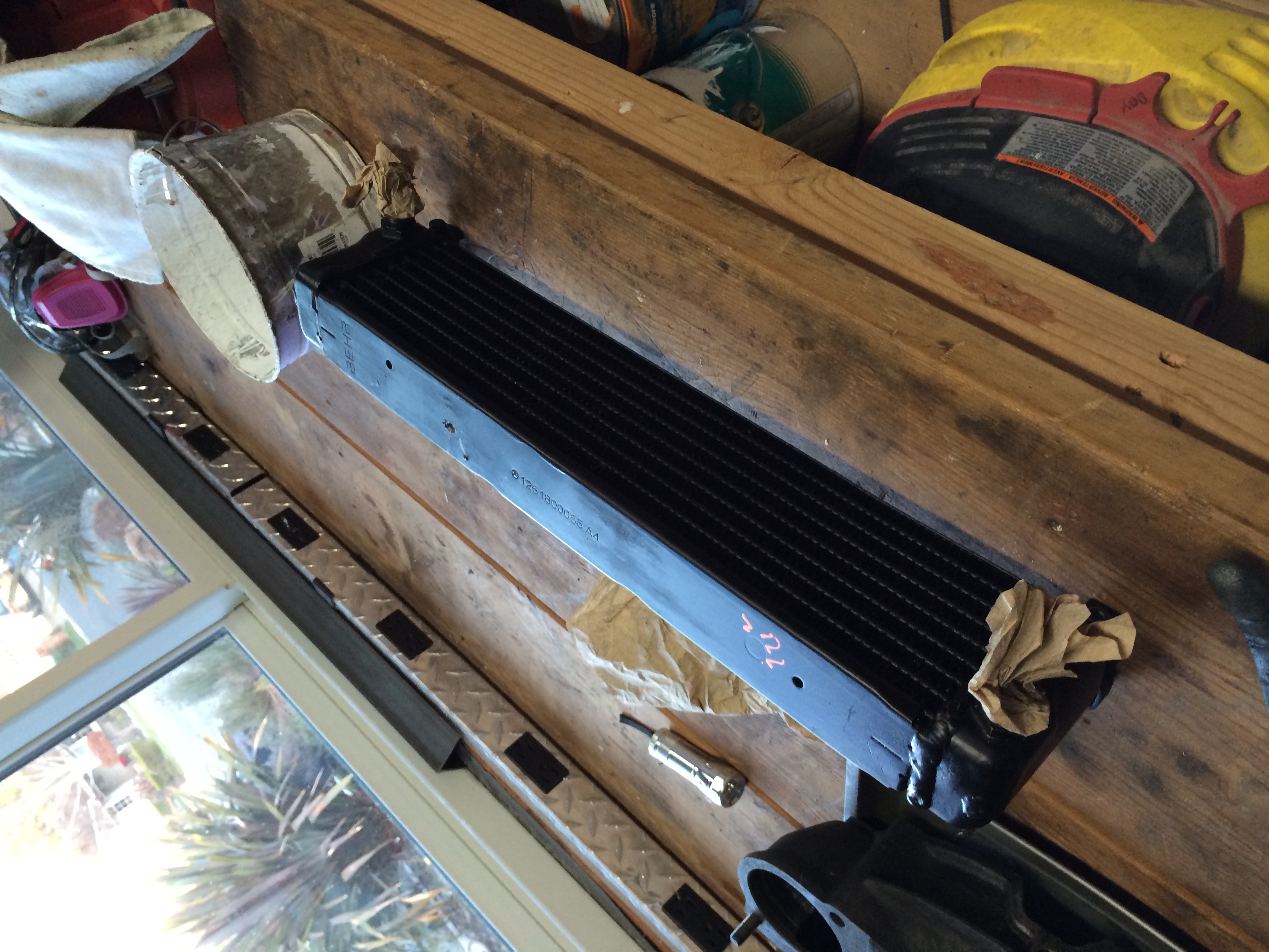

Hey - I extracted one from a Mercedes 300D in the local pick n pull. It sits vertically in the Mercedes, but fits nicely (horizontally) in the GT style front mount shroud area. The fittings are each end and metric, and you'll have to fab up your own mounts, but otherwise its a functional, high "value for money" option. Made by Behr as well, keeping that Germanic flavor to your freshly cooled oil.
FYI,
- Tony

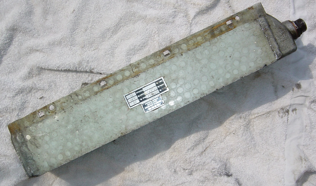

Retroracer

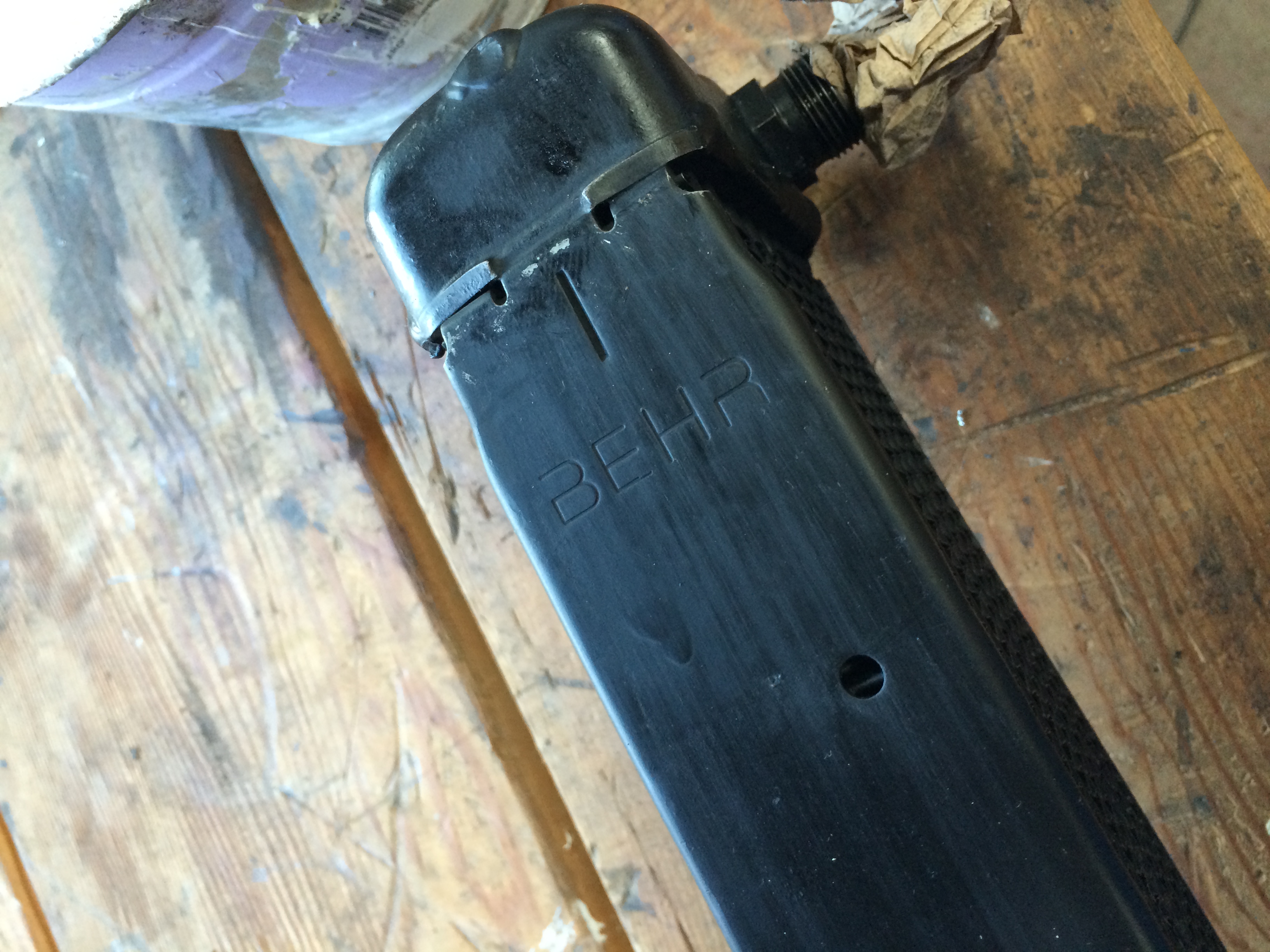

Another pic:
- Tony

Tony, what are the dimensions of this Mercedes 300D oil cooler. Any particular years.

Youre on to something with the Behr 300D cooler. Dimensions check out and used on EBay under $100, even new aluminum version only $250. Much better. Thanks
RFoulds
QUOTE(davep @ Aug 31 2020, 04:48 PM) *
What I found was Behr part #1261800065. 4” tall by 17.5” wide cooling area. Tanks look to be about 1.5 inch so overall width 20.5” approx.

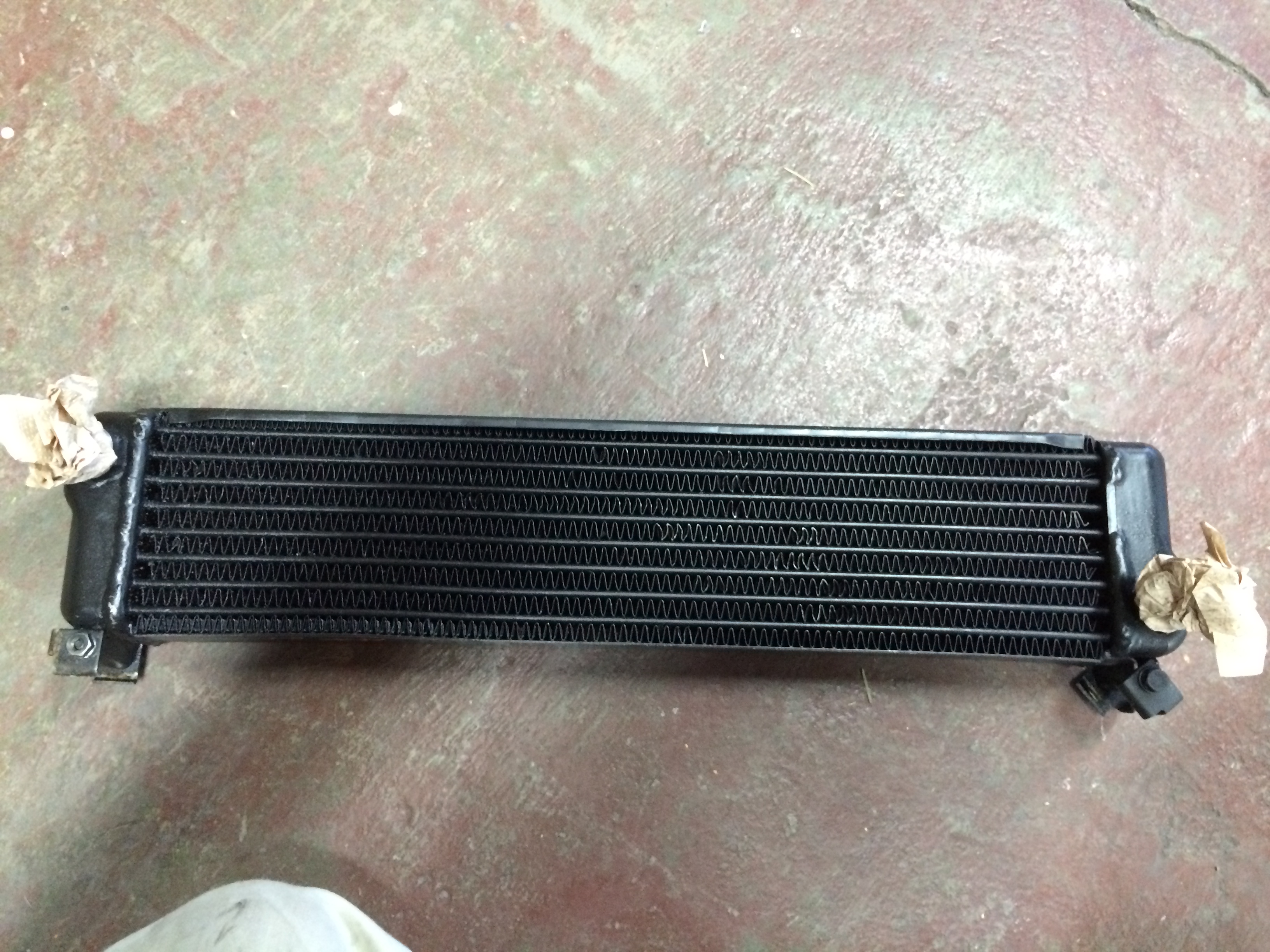

Montreal914

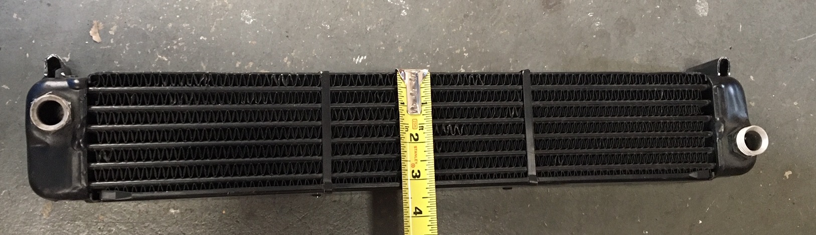

I got a couple of MBZ ones from Bruce Stone. I chose the smaller one (6 pass) of the two so it fits under the shelf, as you can see in the mock up below. Not sure yet if I will be using the fittings it came with, or AN that would be welded on the end tanks.
This one will be use on a 4 cylinder car.

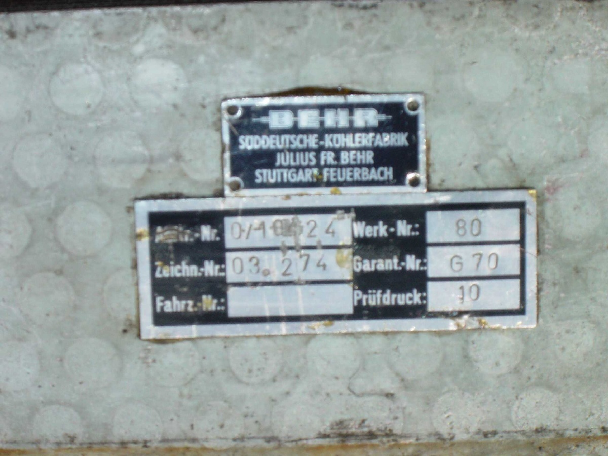

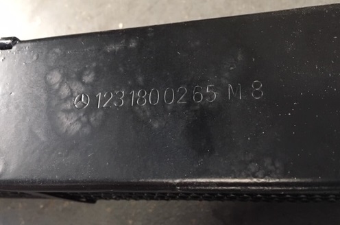

Retroracer
@Montreal914 - looks like a smaller version of the one I have. Attached shot shows part number as well:
@davep - the dimensions are (roughly) 20" wide and 4" high. It fits in nicely in a GT shroud without having to make cuts.
- Tony
