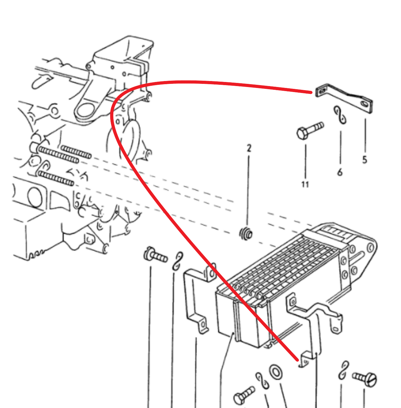

The outside bracket has a welded arm on the top. This loose piece goes at the bottom and further braces the oil cooler. Only installed on the 2.0 engines that I know of.
ctc911ctc
After writing this I figured it out - here is a map of the parts installation

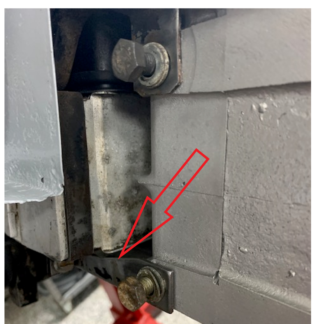

And the part installed - had to bend the tin a bit to get it in place.
