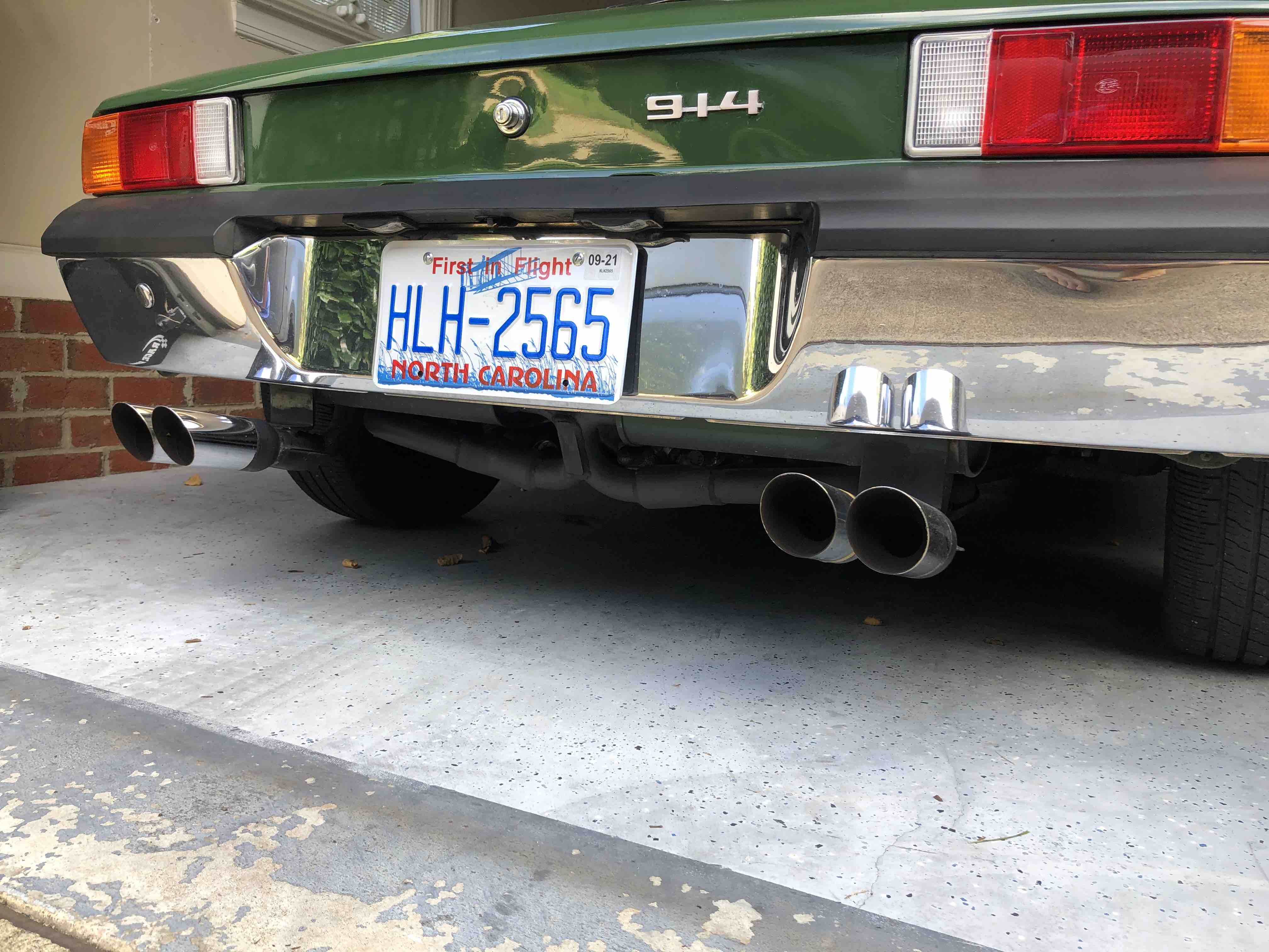

I have a 71 with a Monza exhaust system.
I want to take the Monza off and put a stock system in place so I can use the stock rear valence with the hole for the tip so the car looks totally stock.
There seems to be infinite systems available. I want stock sound to go with the look too.

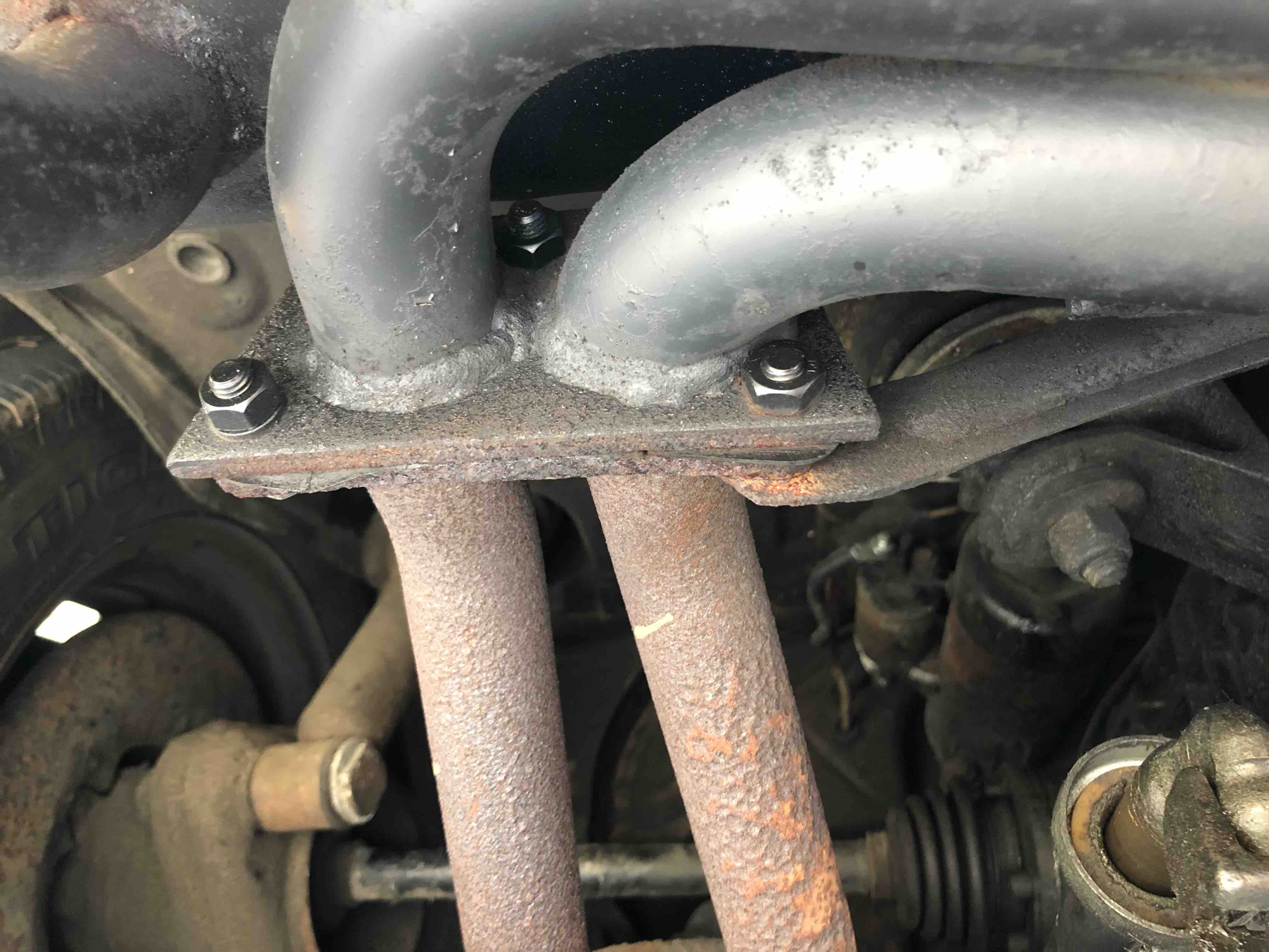

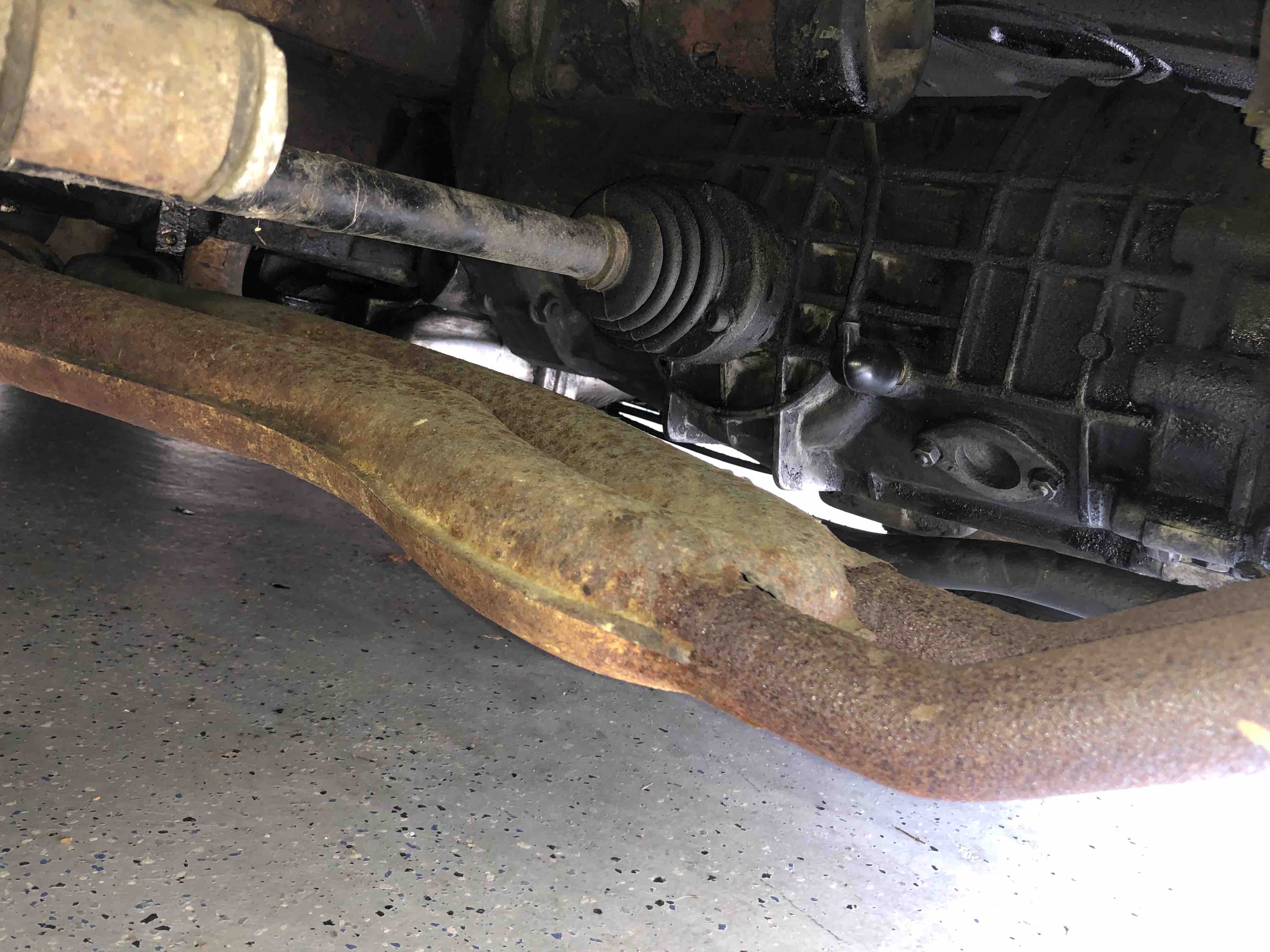

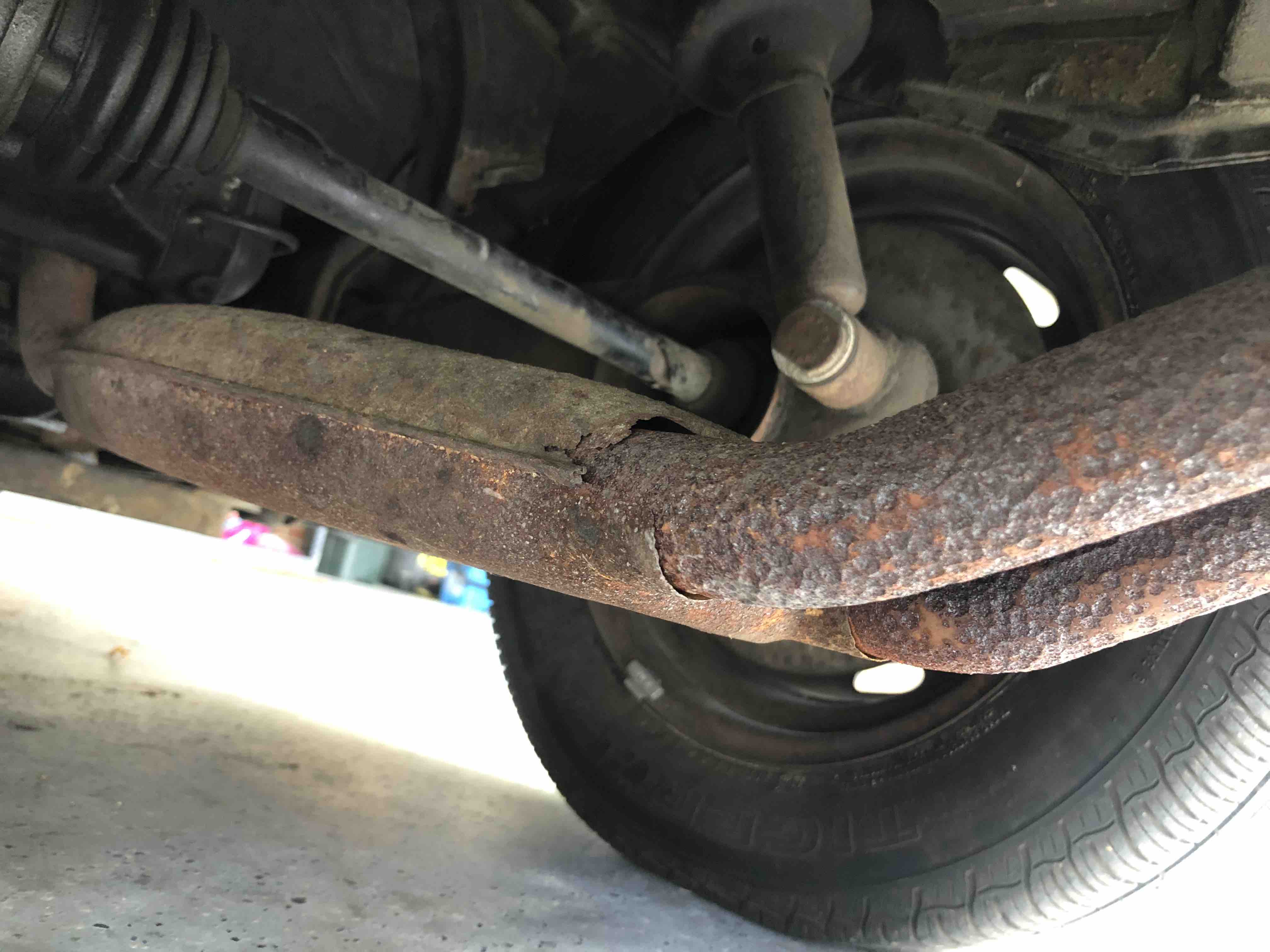

Here are some pictures.
Would also like your feedback on the condition of my heat exchangers. Are they shot?
If yes, please advise as above with as much specific sourcing info as possible.

Yes, the heat exchangers are probably shot.
I would get stainless steel heat exchangers and muffler.
1.7 heat exchangers sell for 200-400
I sell the 1.7 stainless steel side exhaust muffler for $550.
Lighter and better performance than the old Monza muffler (I had one on my car years ago) and should last a lifetime.

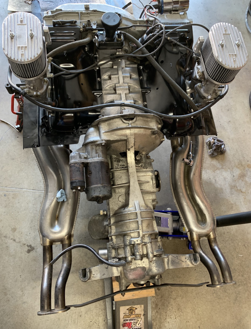

I think 2 members here are selling a 1.7/1.8 SS H.E. for around $350.
like this one
ndfrigi
QUOTE(ndfrigi @ Sep 29 2020, 09:00 AM) *
like this one
link of one of our member here from SoCal for the H.E.
https://orangecounty.craigslist.org/pts/d/f...7172902488.html
