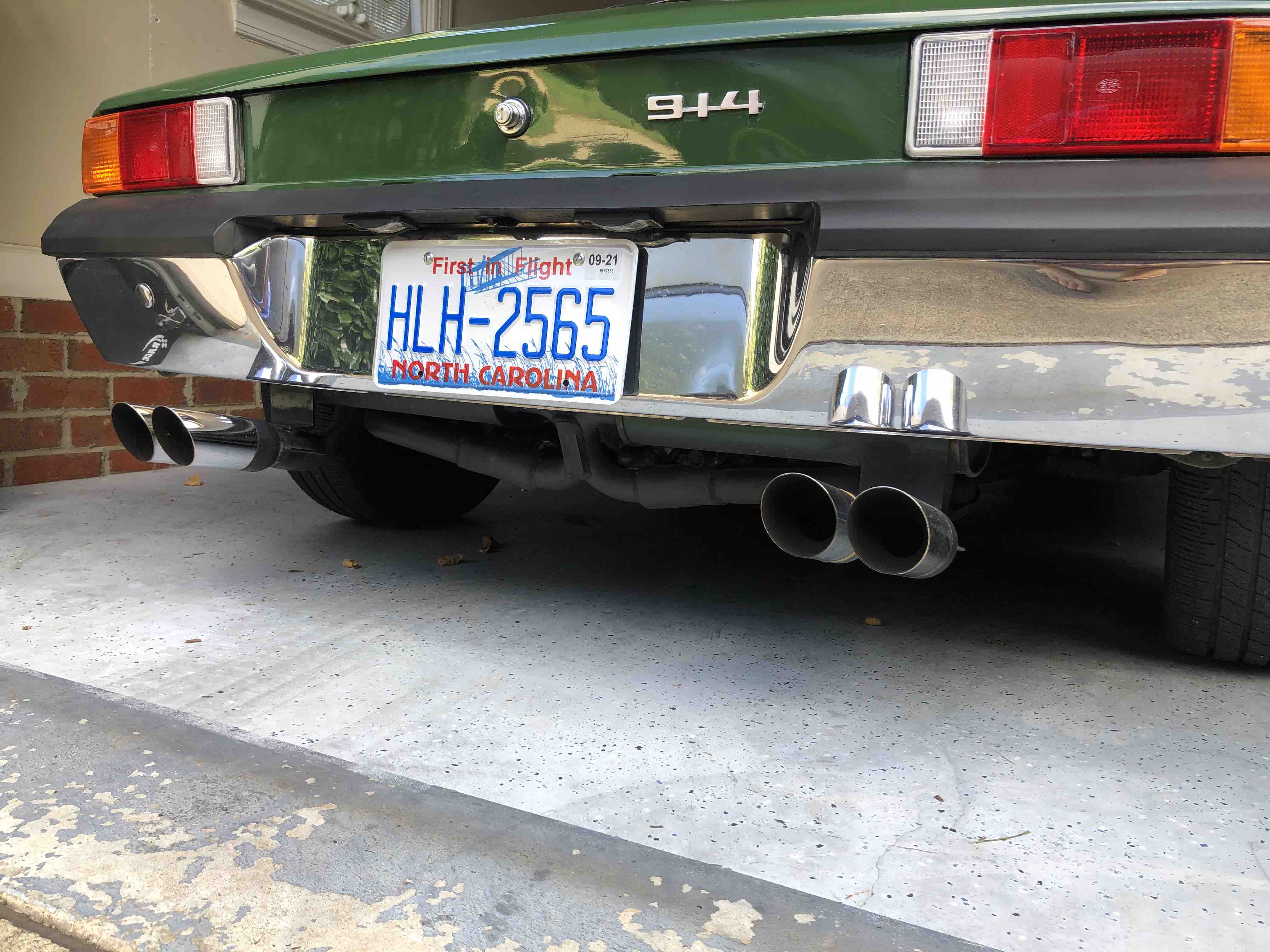

Hi everyone I am very excited to take my Irish (forest) Green 71 currently with ridiculous Monza exhaust back to stock.
I have a Dansk muffler on order but I need to sort the valence.
Has anyone had any experience with the AutoAtlanta fiberglass rear valence?
http://www.autoatlanta.com/Porsche-Fibergl...N-RMIT1412.html
I know the hole is not precut but is it marked on the inside of the piece where to cut the hole? If it is, how do you cut fiberglass? If not, how do you figure out where to cut the hole?
The early valences with the hole are hard to find and very expensive if you can find one so this seems like a good alternative assuming the hole cutting process is not too complex.
As always, any advice is welcome.
