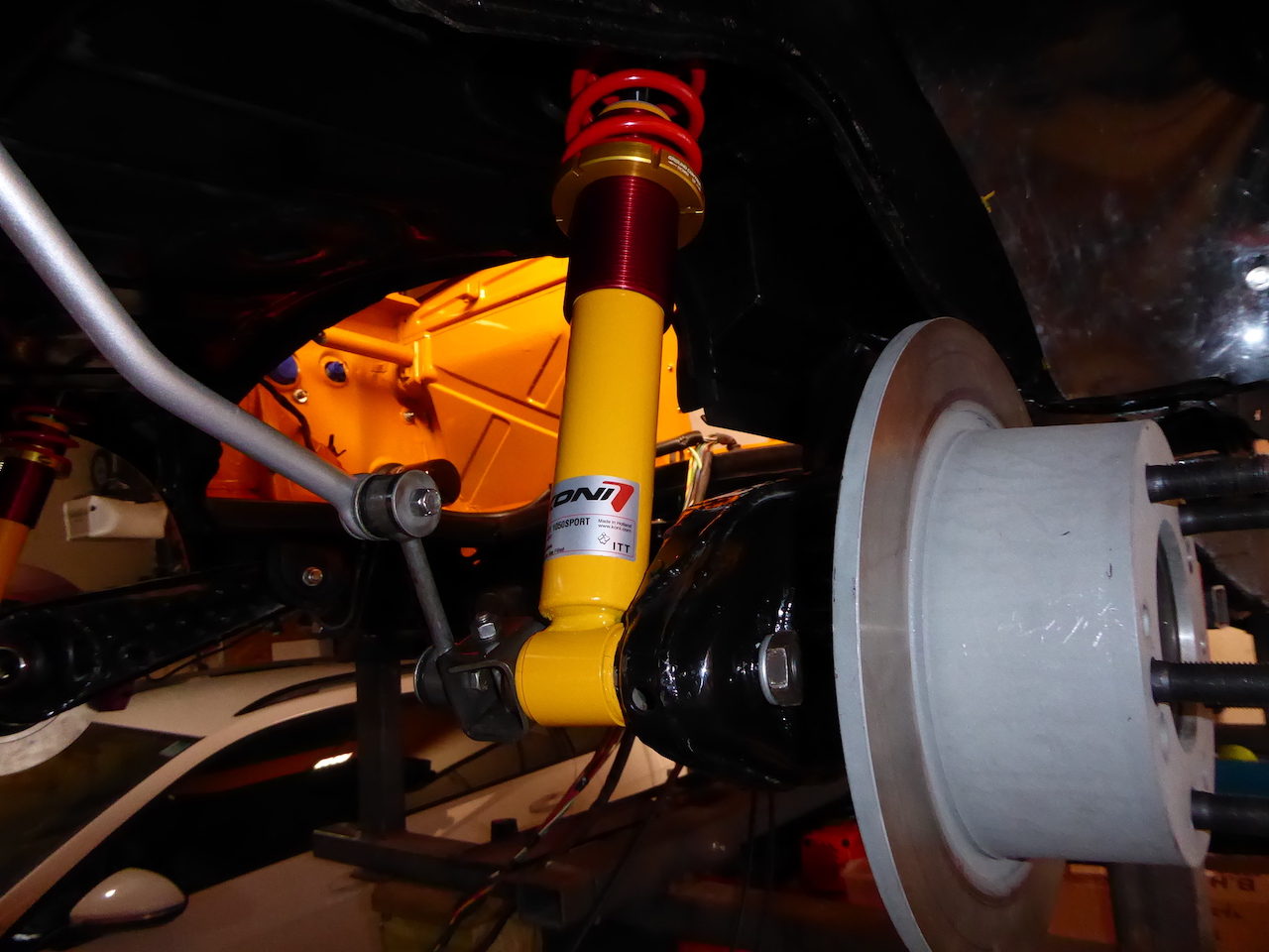

I would just change out the rear if you already have a leak. I purchased ground control, really nice product and great service. You'll be able to set ride high, corner balance etc. Best, MarkClick to view attachment
