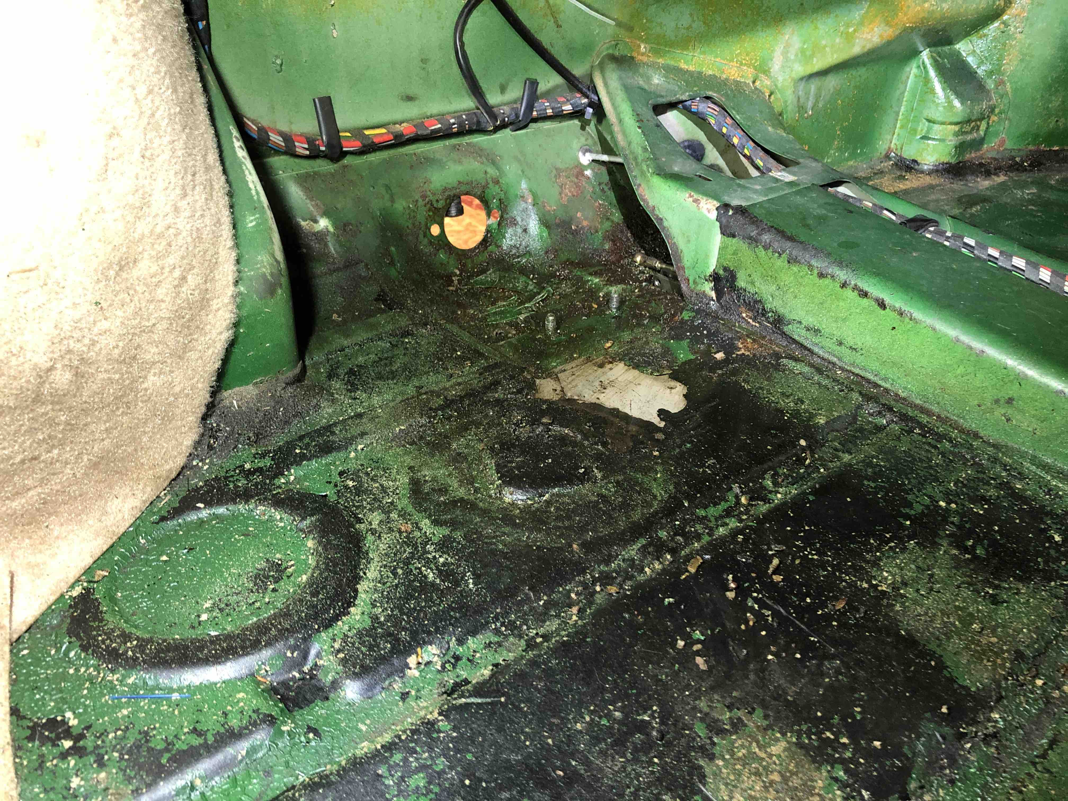

I'm writing in this post to ask about my current problem, which is that my drivers side floorpan is full of brake fluid, bubbling paint and basically a huge mess.
The master cylinder failed and so now I need to clean up the pan before I install my new pedal set (from Bruce) and master cylinder.
I'm a total newb so here's what I'm thinking and please tell me if you know better.
I'm thinking about sopping up what brake fluid I can, going over the pan with some brake cleaner to really clean it up, then stripping the paint with paint stripper, cleaning the bare metal with wurth clean prep then painting it with rustoleum flat black paint.
Please let me know if there is a better way to do this.
I, of course, want to prevent further corrosion and to protect the floor.
