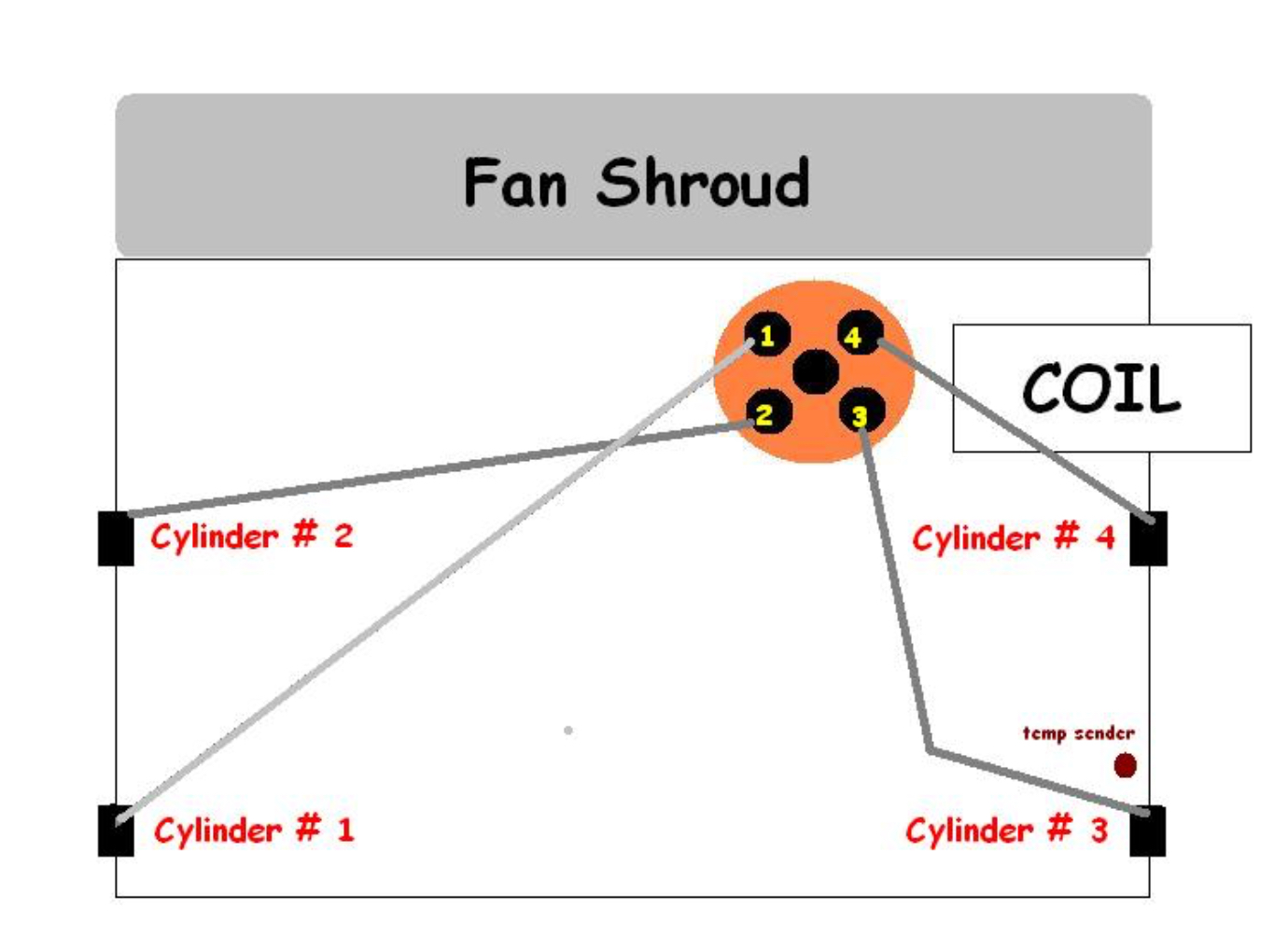

Once you know you're on TDC of compression stroke, the distributor variances can be chased down. They can go as far as having the camshaft mis-timed to the crankshaft. Can extend up to the intermediate shaft to the crank gear being mis positioned. And finally, the distributor to the intermediate shaft. Heck, I've even seen a rotor misinstalled and not seated properly on a friends Bug and he couldn't figure out why it didn't run.

If in that position, when #1 is at TDC, the rotor points to #3 spark plug tower on the distributor cap. Car still runs fine if the spark plug wires are in the correct firing order relative to that position. A better way to explain it would be to say the rotor, instead of pointing at around 11:00, would be pointing around 5:00. I had a different carbed 914 10 years or more ago that was like this. Ran great. I never changed it. And expecting the rotor to be at an exact clock position is kind of a crap shoot anyway, because timing advance or retard will change the position of the dizzy.

Found this here from a prior post, useful to help visualize.
