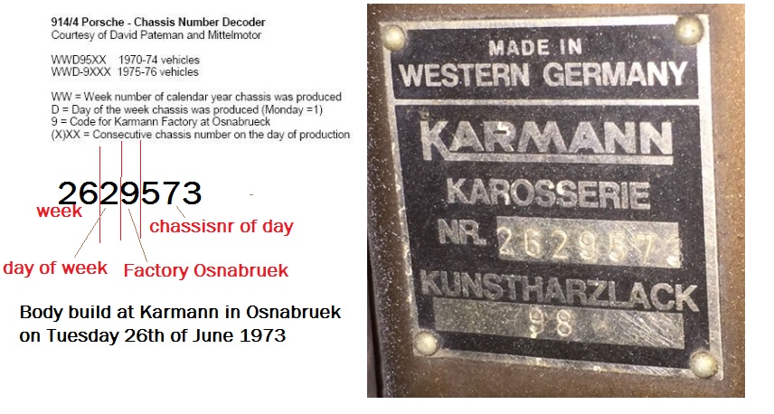

Hi Ben, I used my Karmann Tag as example, hope it helps a bit to get closer to the date !

Arno914
Nov 26 2020, 09:27 AM
Hi,
as far as I am informed, it is the last 2 digits that count the number of produced cars on that very day.
If in some cases more than 99 cars were built on a specific day, the number "95" changes to "96".
262|95|73 means, it is the 73rd car built on the second day of the 26th week. (262|96|73 would be car #173)
Please correct me if I am wrong. Does anybody have a "96" on that plate?
Arno

davep
Nov 26 2020, 07:17 PM
Thanks for the heads up. Yes, for the 914/4, the Karmann # is a pretty good start for the production date. BUT, this is the date that the body was produced, not when the running car was completed. I am certain the Karmann # was on the body well before the VIN was stamped into it. Corresponding with Werner I understand that Mittelmotor says the last two digits were the running total for the week, but this is wrong, it is the running total for the day. And yes, the base was 9500 for the early years, and then changed to base 9000. I have a lot of examples of 96xx, so there were often runs of more than 100 per day. I have some really odd data for the last couple of years, but I think that some of that is in error. I do like to get combos of VIN, Karmann # and if possible compliance date code. Another # that may help is a parallel to the Karmann # which is the production # handwritten in crayon on the underside of the dash. In many cases the Karmann # and the production # are identical but not always. You just have to stand on your head to find it, and hope it is still legible.
These #'s are on a 914/6 as well, but the format is completely different, and has no real relation to a date. If you want my help, then email with enough info to make it possible.

plutothepointer
Nov 27 2020, 02:51 PM
if you can't find a Karman production number on your car you might find cars with a VIN close to yours. That might help you to determine the month of build. Dave can probably help you there.
On my car the production number reads out to 22 August. The car is punched to be produced in September. That is okay if the production of its body started on 22nd August, than it is likely that the car was completed in September. In those days the production of a car took longer than it does today.

Arno914
Dec 4 2020, 01:03 AM
As far as I have learned, John´s car was the 116th built on that very day according to the "96" instead of the "95" on the plate. Makes some sense, since 1973 was the year with the highest 914 output from the Karman factory.
