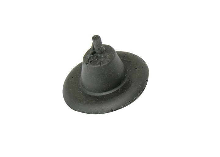

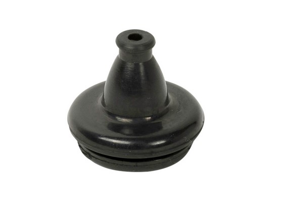

There are two reproduction grommets from our well-known vendors offered as replacements for the oil temp sender seal on the taco plate (part #311949149A) but which one is most correct to the original? confused24.gif

Thanks, yep that's the only other thread I could find too but didn't help much on ID'ing the correct original boot. I'm sure either will work but I'd like to get as close to original as I can. I've also done a google image search on the part# and all I get are picks of either of these two reproductions. Obviously they can't both be right.

They are all the same, top one is just a bad picture

Montreal914
Having bought rubber parts from both places, I'd say the pictures are pretty accurate. laugh.gif

Thanks George, that clears things up, but yeah, the bad pic is what comes up on your site. huh.gif

And we couldn't find a good original to make it from ant made what we could from pictures and actually measured the parts to make sure they would fit correctly. Ours may not be a 100% identical to the original but it was made with our best guess and fit checked. We do not have voids in our castings as we actually spent the money and made an injection tool. We had used catalyzed rubber in the past and the voids (air bubbles) become problematic.
Mikey914
Also we made the hole for the wire smaller to allow it to seal around the wire. May not be 100% "correct" but solves a problem
