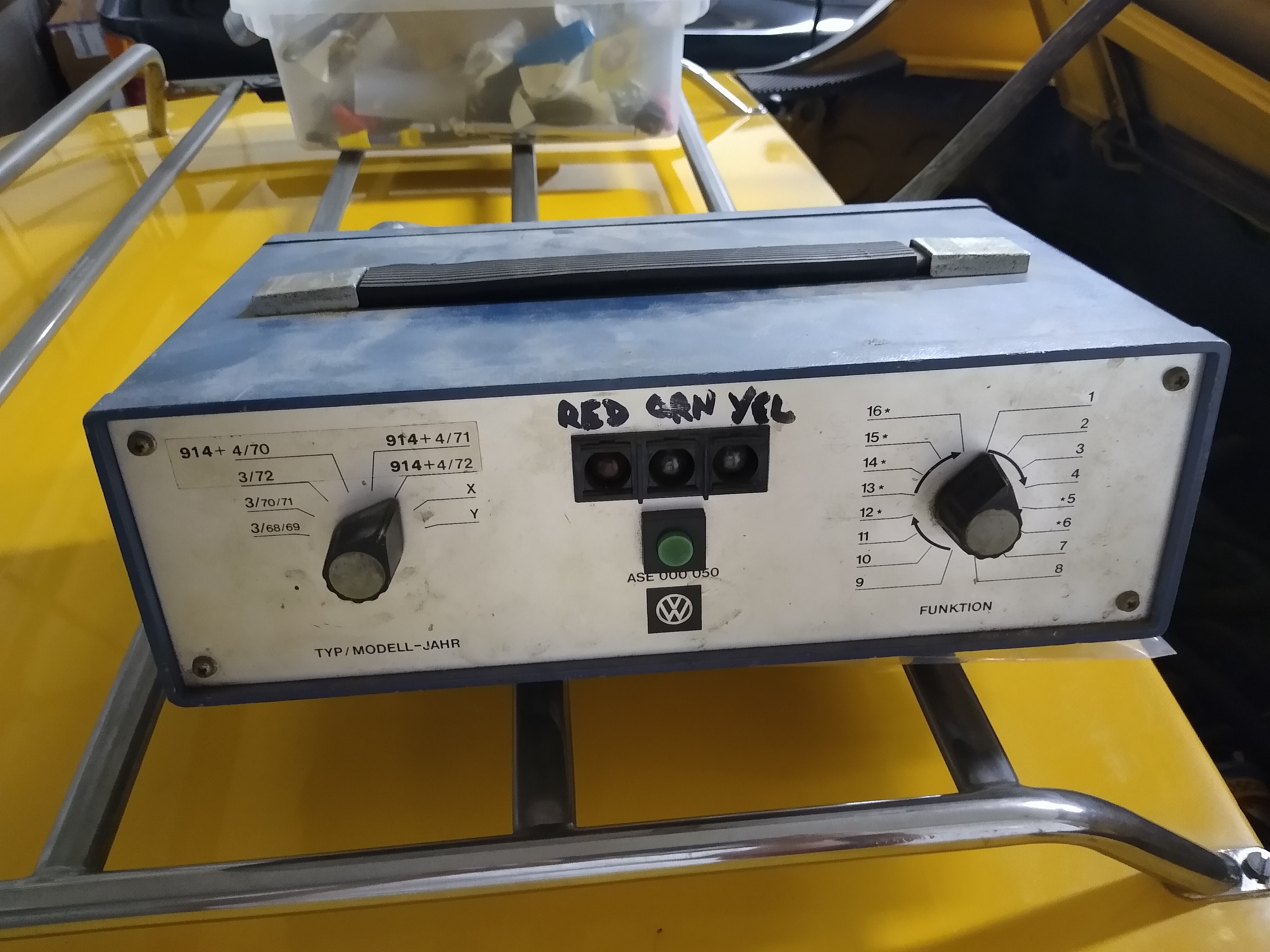

They are both fuel injection ECUs. The larger one is for Djet and is for a 73 2.0. The smaller is Ljet. They used to make testers for both, but can be hard to come by. I have a tester for Djet ECUs if you really want to test it. It's rare that they go bad though. Usually issues arise from either a mismatched ECU to engine and pressure sensor, or if someone opened the ECU and made adjustments.
This is what the Djet tester looks like. It has a plug that sandwiches between the ECU and the wiring harness.
