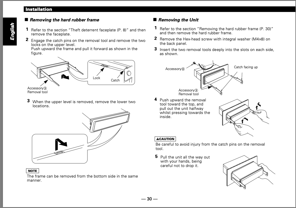

I found some destructions for Kenwood of that era.

Sometimes I have able to get them to release with a thick feeler gauge, a thin screwdriver, or making a rough tool from sheet metal.

I believe That trim plate is clipped on. Squeeze the upper ends to while pulling toward you. Then you be pushing some shims in at the sides of the exposed stereo.
That underside pic shows it’s a slide in mount that surrounds the circumference of the stereo chassis.
1. Remove front trim plate
2. Disconnect antenna and wire harness
3. Push Two pieces of flat sheet stock (tin can thickness) to disengage the shroud sides of the stereo
4. Push from the bottom of the stereo after the two shims have been pushed in about 1/2 to 3/4” inches
5. Stereo should slide out towards you.
6. Remove that rectangular frame
BTDT on the different stereo head units I’ve changed out over the years.

Oh yeah, I found that after realizing the face plate comes off. Thanks a lot, I appreciate the help!
