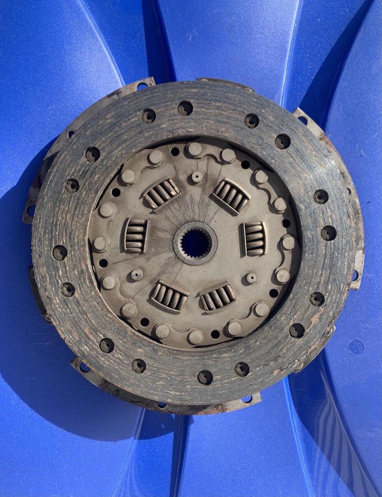

No chance the disc got flipped ?
wndsrfr
Tighten the cable until you can just barely depress it with your hand grip at the spot between the pulley and the cable end....see if that releases the clutch... that's a starting point. After that, drive it some and then do final adjustment to engage at 25% from the floor and still have a bit of travel at the top ..
jaredmcginness
QUOTE(rgalla9146 @ Dec 4 2020, 12:30 PM) *
Any chance the disc got flipped ?
I believe the clutch disc only goes on the pressure plate one way, could be mistaken.
If not, I suppose it could be wrong the whole time? I've never driven the car. So it may have never worked, haha.
I could provide a photo of the clutch on the plate, if someone could confirm.
Here it is:
IPB Image

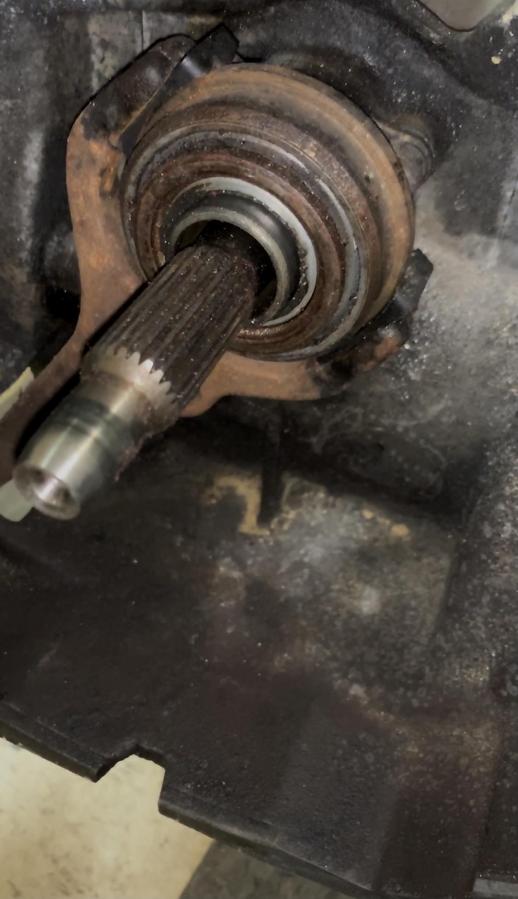

Any chance throw-out bearing is on backwards on fork.
jaredmcginness
Here is a video of the actuation - for what it is worth. Not sure if this will help show the travel.
Eitherway, maybe helpful for someone who has not seen how it functions.
Clutch Cable Video
Here is a picture of the throw-out bearing from last year, before I cleaned it. If this helps determine if it is backwards.
IPB Image
I am glad I take photos of all this crap.
