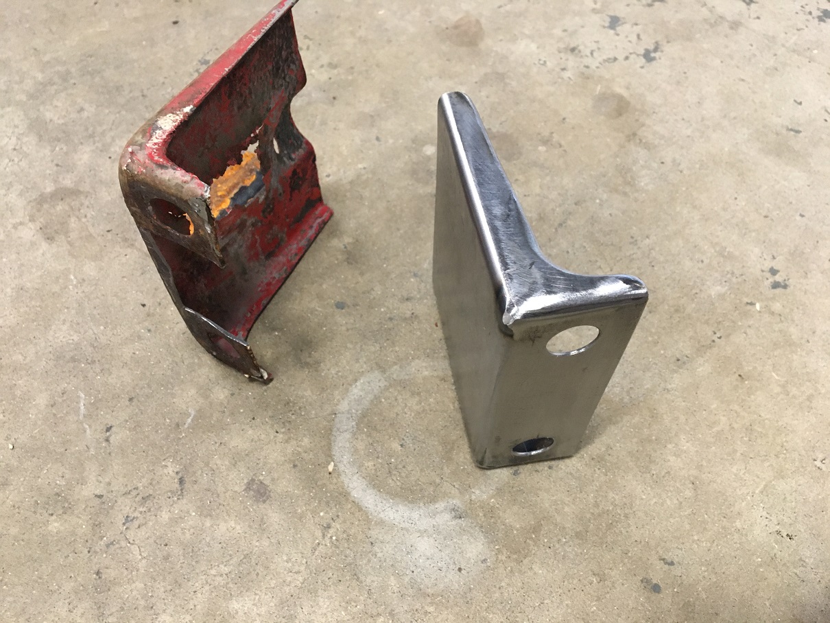

I did the body repair piece and the angled bracket using my trusted hack saw, hammer, vise, and little MIG welder. smile.gif

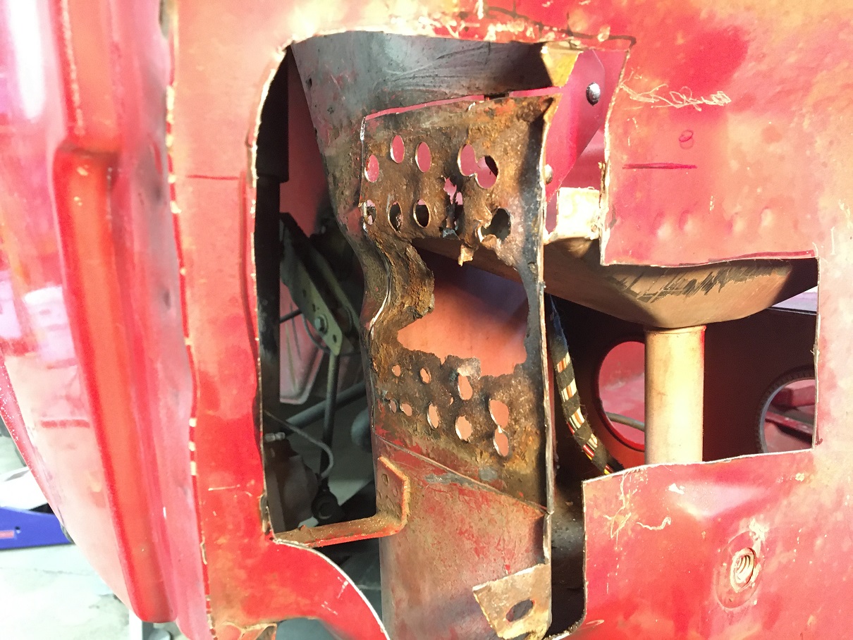

That is about the amount of rust I will need to cut out. Will drop the front suspension and wheels first.
Stuckon914
Need to cut to clean

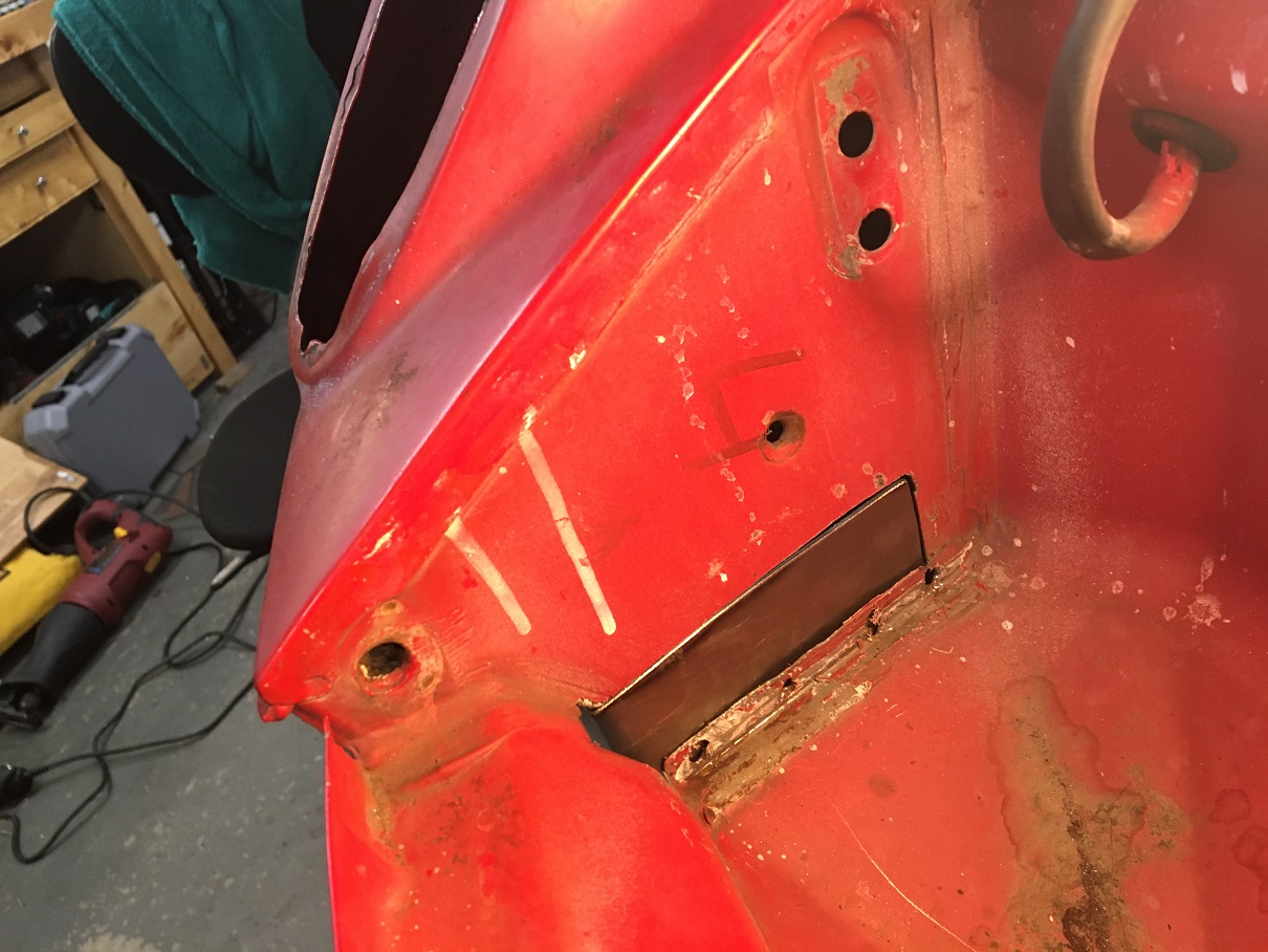

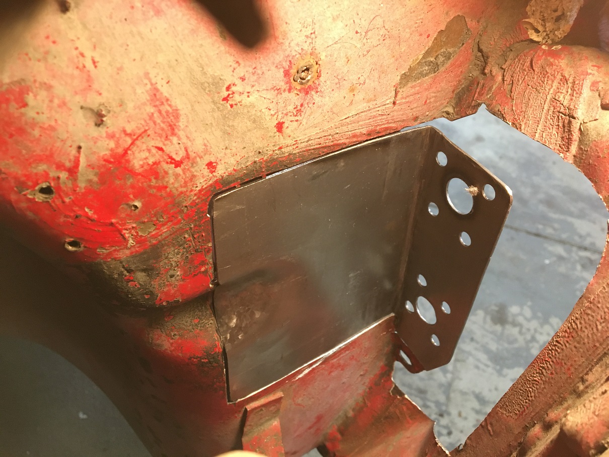

Done with suspension on and wheel removed.
Here is what the inner wheel metal looked like once separated from the bracket (done on the bench to see the condition).
You are actually in the headlight box at this point, but its manageable as far as access. The cutting out can be a pain if you have limited tools like I do.
Seen here is the upper part of the inner fender repair piece.
