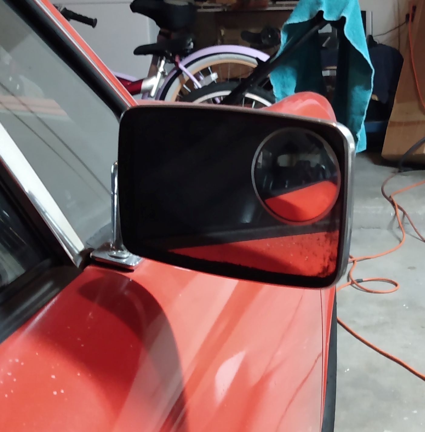

mark04usa
Feb 8 2021, 12:37 PM
After I bought my car at the Porsche dealer I worked at in 1976, I noticed that the 914 parts manual indicated L/R fitment for the outside mirror, which meant it could be used for left or right side. (The factory parts book also listed the convex right side mirror.) I measured and drilled and found the captive nuts in place and mounted a mirror right up.
Add a 1" convex round mirror to the right side one and you will have an excellent view.
