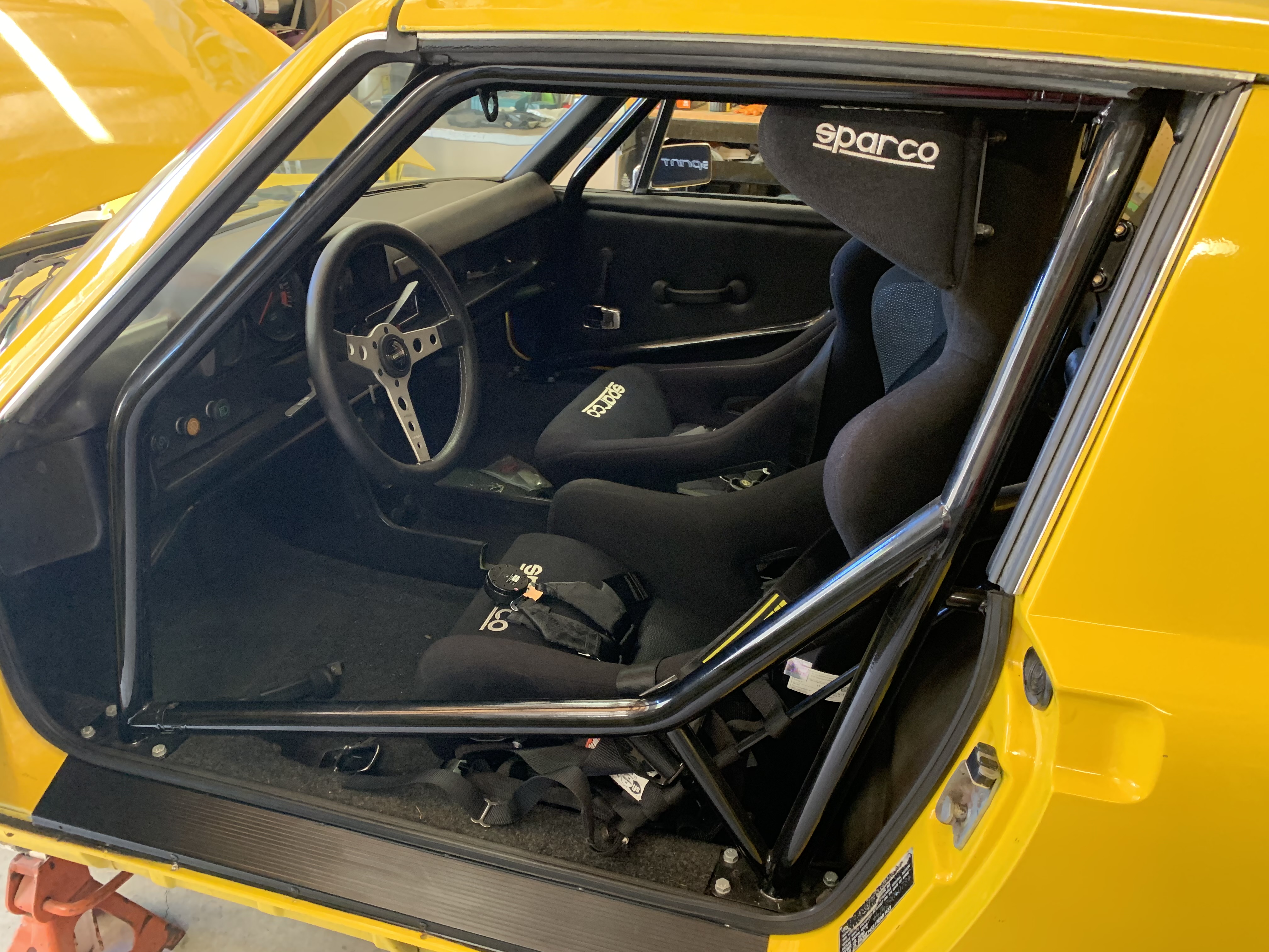

QUOTE(VegasRacer @ Apr 8 2021, 07:58 AM)
Maybe these pictures will help. Photos are not my car. I have a full cage.
Something like the last two pics. My brother is 6'01'' so he needs the leg room.
I'm waiting to hear back from McMark.

QUOTE(Luke M @ Apr 8 2021, 08:42 AM)
That car belongs to
@1stworks

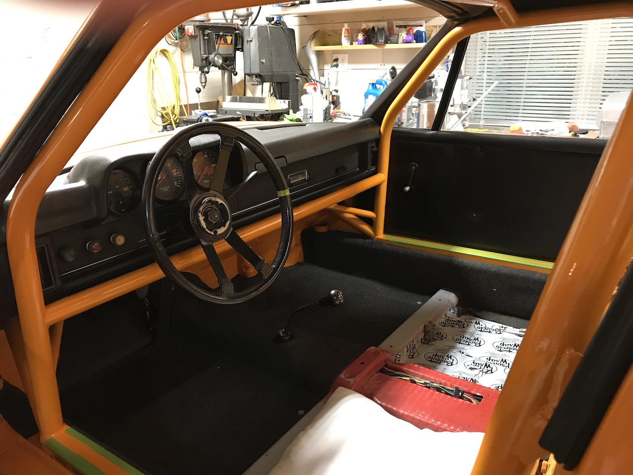

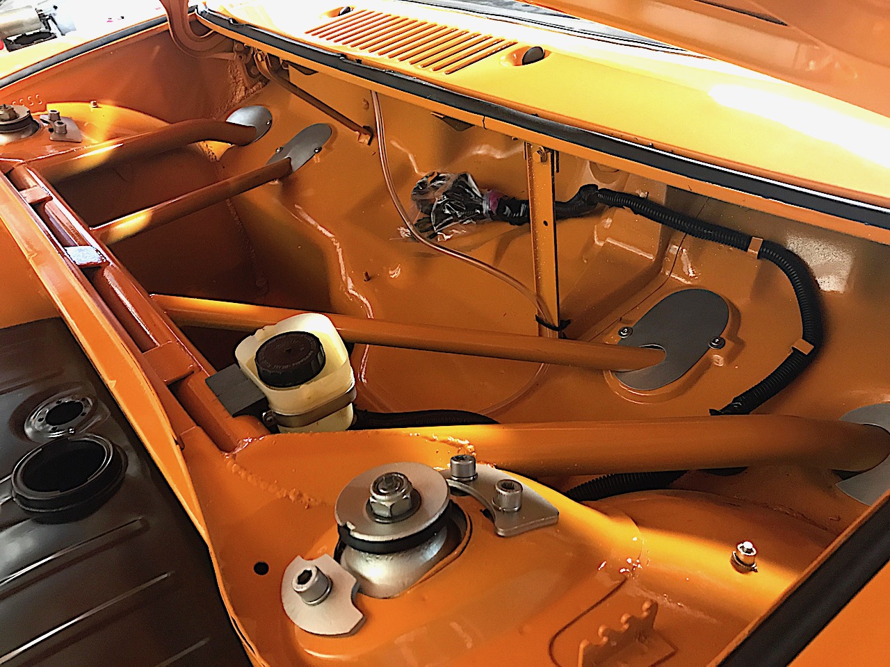

Mine is a user friendly cage extended to suspension points. Mark
Click to view attachment Click to view attachment
Luke M
Apr 9 2021, 07:16 AM
A full cage is out at this point. Leaning towards Mark's cage with maybe a tweek or two to it. Like this one but with some bent side supports to make it easier to get in/out. Seams like the seat would be able to go back a little farther.

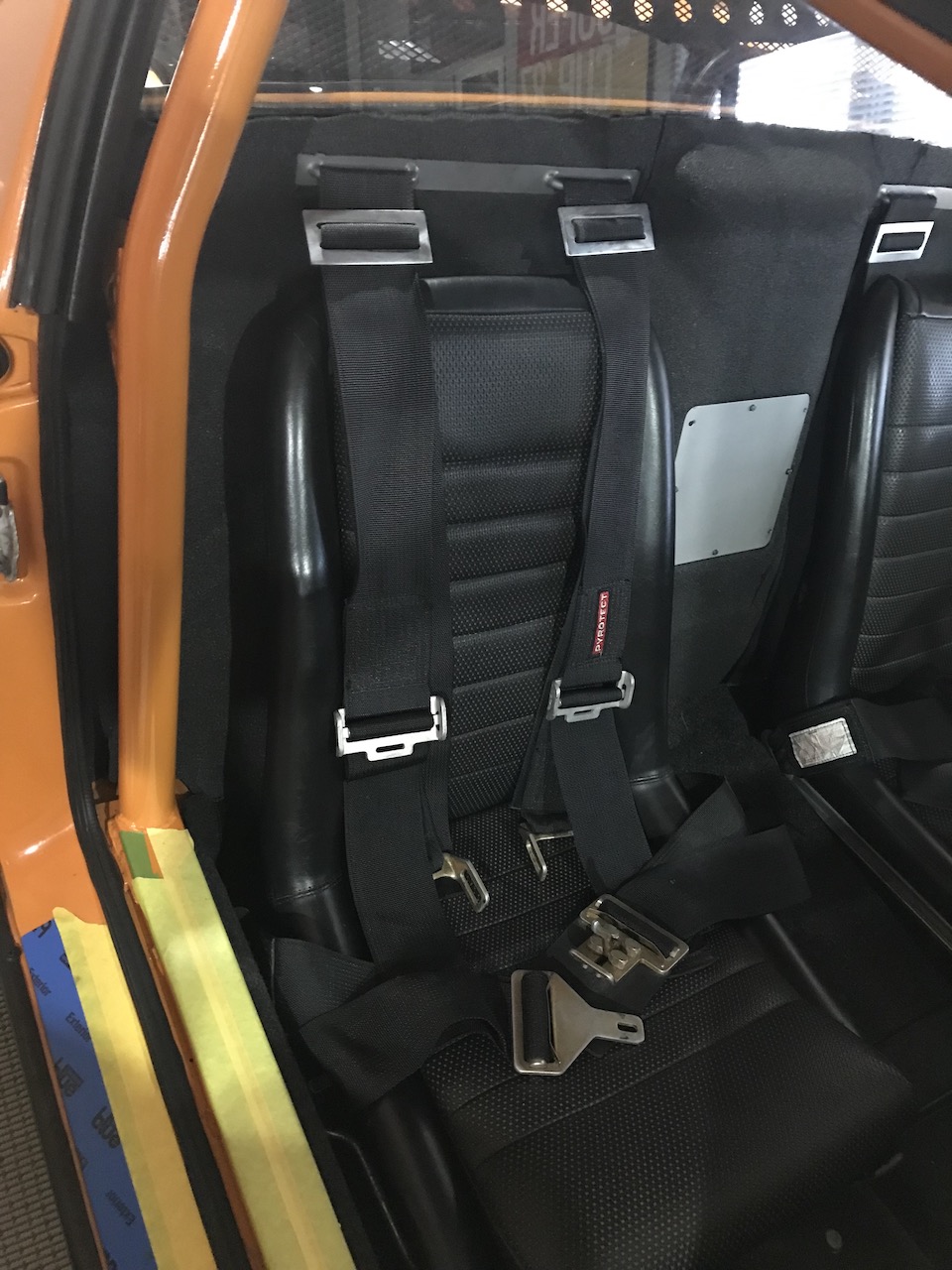

mlindner
Dec 11 2023, 10:13 AM
Also 6' and seat gos back all the way. I did just last winter moved the front bar six inch closer to the front wind shield. Best, Mark
