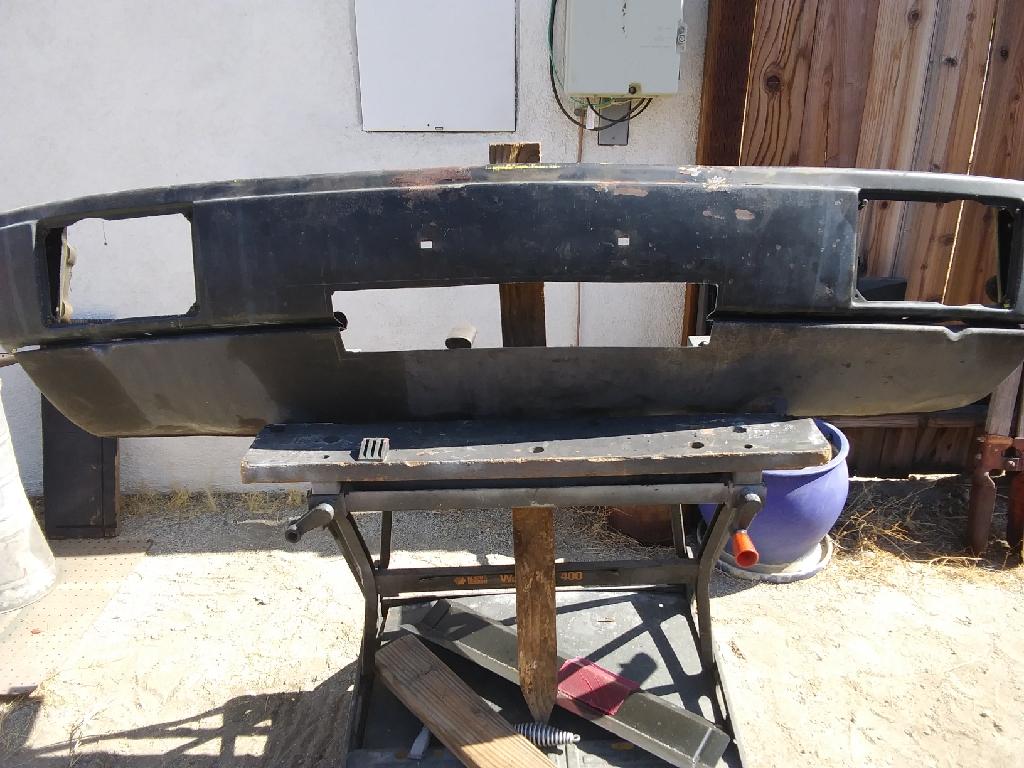

Hi I'd like to see how you dood it!
I just started hacking on my valance and I'm looking for inspiration.

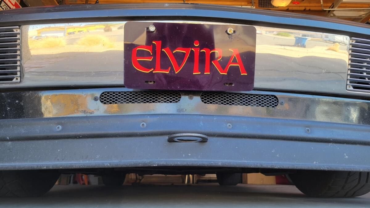

I just bought a front valance similar to yours but in fiberglass. For the race track in hotter weather out here I cut out all the holes to one big opening and adding stainless square mesh / rat wire. The expanded metal is all flattened which I felt would not allow for very laminar flow. I need all the help I can get with cooling

Here's how I do the inside. Did it similar with a 3.6 build.

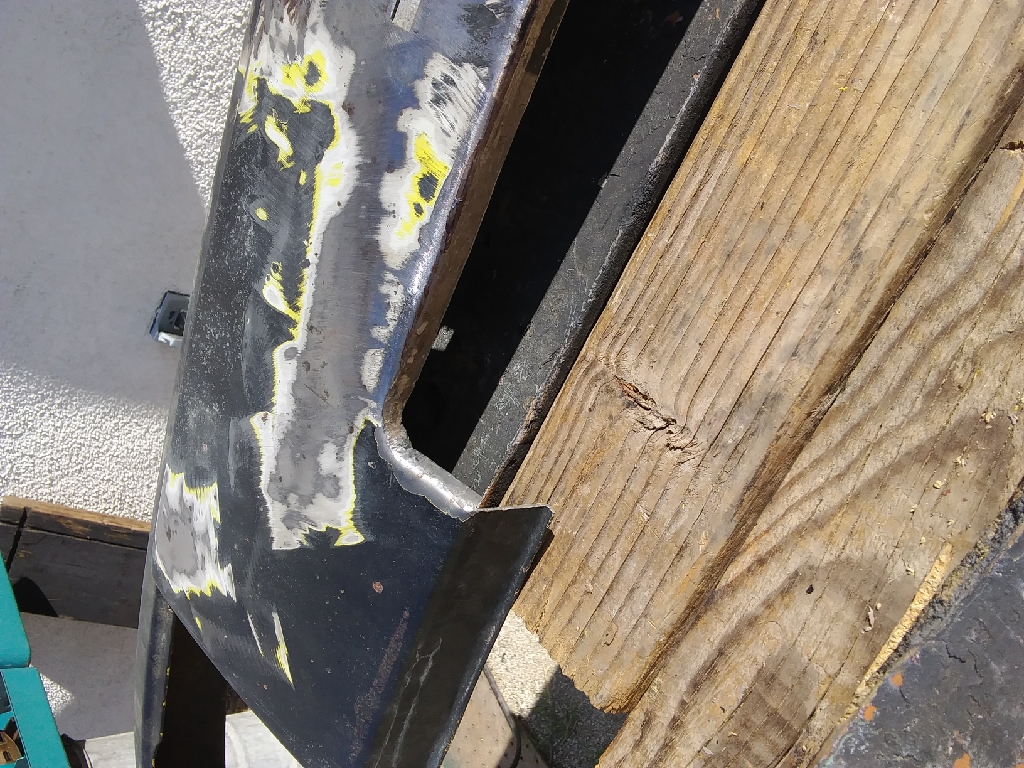

I cut the hole 1/2" smaller than what I was shooting for.
Click to view attachment I used hammers a slap and dollies to roll the metal over, trying to get a pressed factory look.
Click to view attachmentThen welded a plenum on for the finish. Gave it the break to follow the factory stiffening breaks.
Click to view attachment Need to make it pretty now. Steel is real!

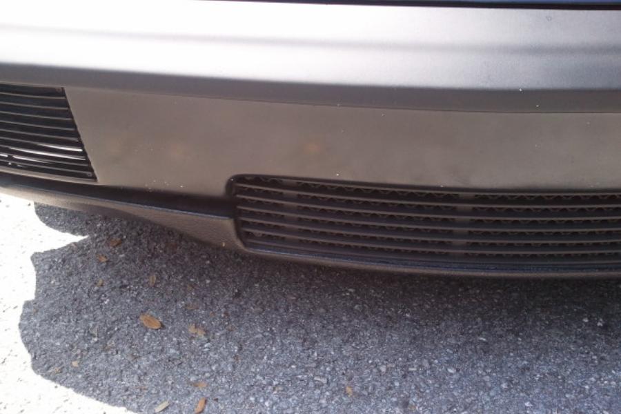

May 15 2021, 06:01 PM
Below is a pic that you can read the contours of the inlet somewhat - the louvered inlet is nice as it picks up the fog light cover details

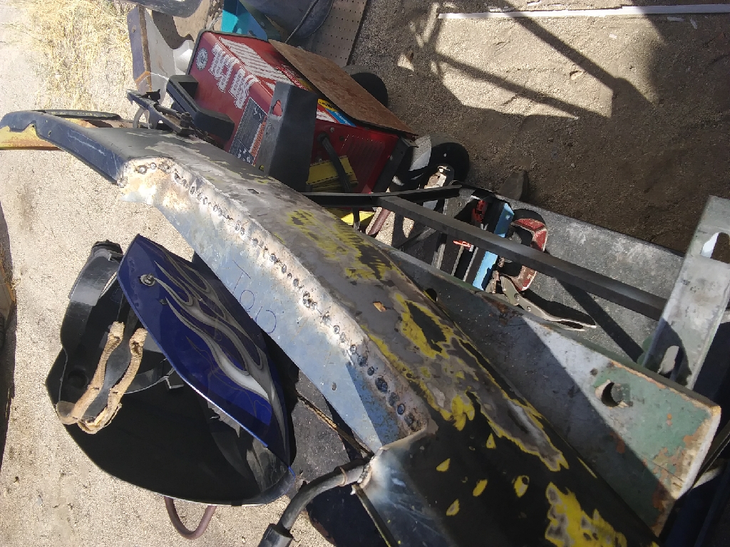

Mark Henry
May 16 2021, 06:40 AM
My valance so far....more of a pouting lip.
I think I almost have enough structure to take it back off.

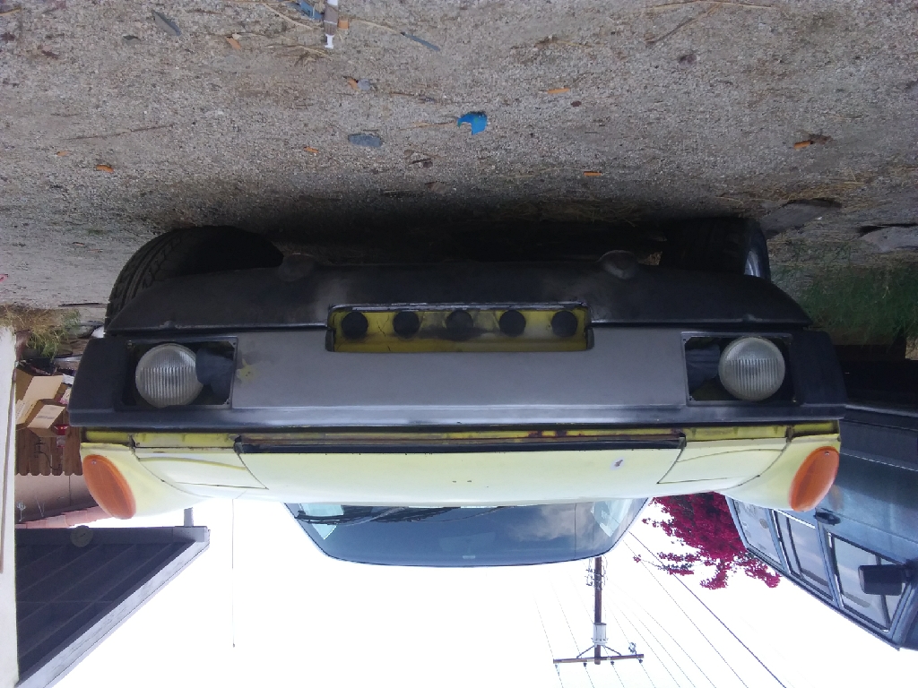

Mark Henry
May 16 2021, 06:47 AM
Another angle.
Shivers
May 16 2021, 07:01 AM
That actually looks pretty good.
