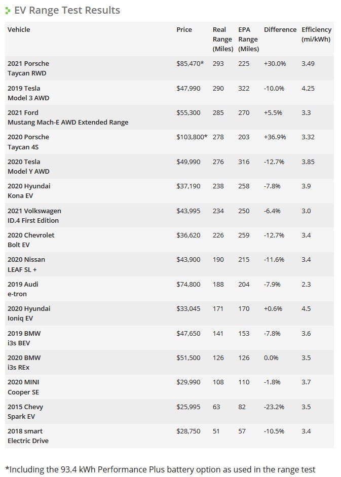

For fun I found this list of real world range tests @ 70 mph and compared with charging station distances in my area. Note that Porsche is once again the king of understating their capabilities.
One of my favorite drives is down through Yellowstone NP out to Cooke City and over Beartooth Pass to Red Lodge. There are 11 cars on this list that would easily get me from home to the charging station in Red Lodge and that is the farthest distance between stations I'd be likely to drive for regional pleasure driving (or even cross-country driving for that matter).
The biggest obstacle now to switching the family truckster for EV is charge times. ID.4 (that I've been eyeballing) charges to 60 mile range in 10 minutes and to 80% charge in 38 minutes. That would tack on a lot of time to cross country trips. They get closer to my goals every year though.
https://insideevs.com/reviews/443791/ev-range-test-results/
Shivers
"There are variables simply out of our control like wind, traffic, and weather. However, we do our best to control what we can. We always set the tires to the manufacturer's recommended pressure, we crosscheck the speedometer with a GPS for accuracy, we charge up to 100 percent and enter the highway either immediately or within a couple of miles. Then we drive at a constant 70 mph and in long loops so we end up basically where we started. "
Ok, sounds real worldly to me. I guess I'm less of a long loop driver and more of a squiggly line kind of guy. Besides, I don't care how many playing cards you put in the spokes, it won't sound the same. wink.gif

bbrock
QUOTE(Shivers @ May 18 2021, 03:21 PM) *
I'm confused. Are you saying that those variable out of their control do not affect the range of ICE vehicles? confused24.gif
