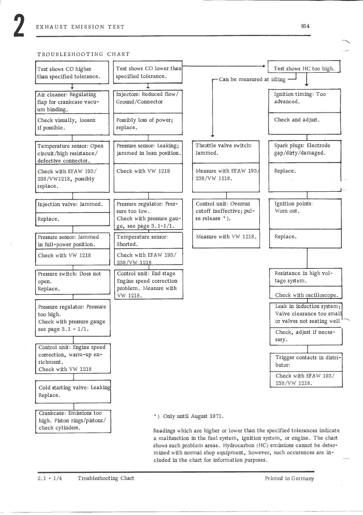

do you have a factory manual?
good for step by step check.
you need access to an exhaust gas analyser.
tips about car being fully warmed up at at operating temp before test good advice.
