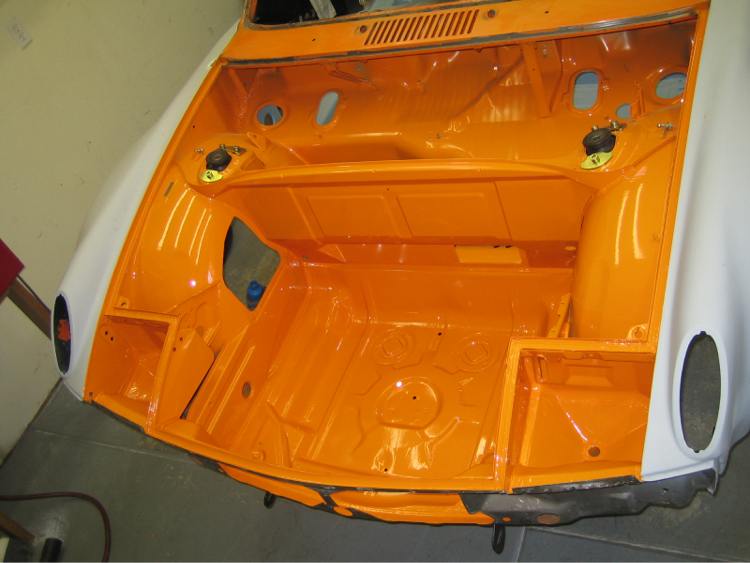

euro911
Post some pix of your front trunk.
Do you already have exhaust vents in the wheel wells?
If so, you may need to fabricate ducting to the vents - aluminum sheeting, fiberglass or carbon/fiber confused24.gif

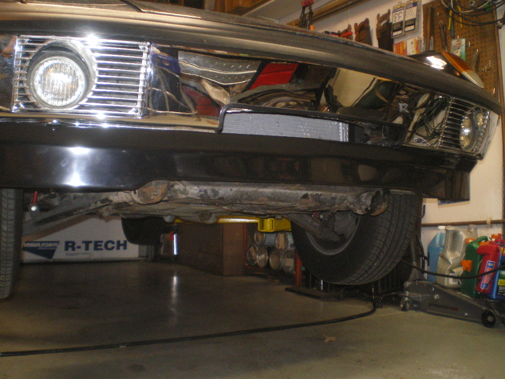

Here is my trunk opening. This is the first time I have driven it with the temps this hot outside. The AC blew cold, maybe add a heat shield and see if that benefits it. Or, just not drive it when it is this hotClick to view attachment
76-914
Hard to tell from that pic but it looks like the opening is too large. Try reducing it a little with a piece of cardboard or a piece of scrap metal to see if that helps. Also, you can measure the holes and determine the area of each in square inches.

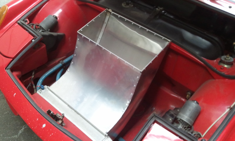

Out the top, best way to vent the hot air:
http://www.914world.com/bbs2/index.php?s=&...t&p=1898832
