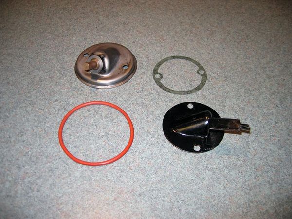

Sorry about that !! Too many T’s. So can I add a taco plate and install a sender unit ?
IPB Image
If not you will have a blank plate in its place.
Im biased, so Id consider the billet unit I offer over the OE piece unless you want to keep it all original. smile.gif
