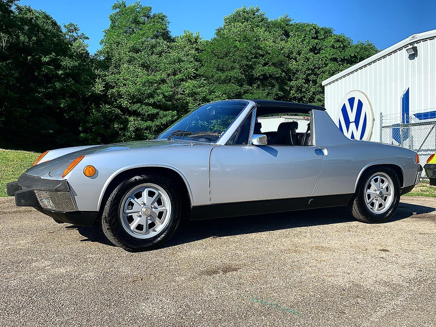

Here's what she looks like:

Car looks great, btw.
