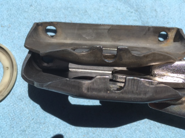

If you replaced the stop plate I should warn you the part from Porsche is out of spec causing it to bind. The slot needs to be extended.
