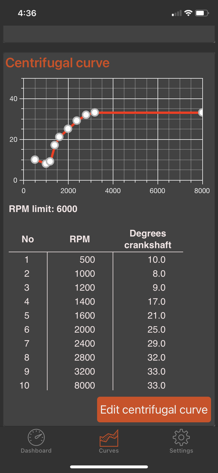

I’m curious if anyone has a curve they can share for the Bluetooth version of the 123 distributor for D Jet 2.0? I know the Bluetooth hasn’t been out very long but was hoping someone had fine tuned the curve over the 123 provided ones.
From what I read, 32-33 degrees total works. Here’s what I’ve been using in my 912, and the additional points smoothed everything out.
Would this work well on the 2.0?
