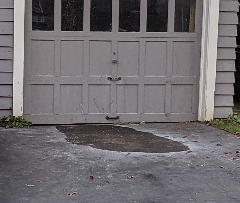

Nobody would ever suspect a 914 is behind that door...

Yup, air cooled VW/Porsche owner lives there. All his time is spent on the car, no time to paint garage door. Just like me. Best, Mark

I don't know what you are talking about. I bought my garage door from Beverly Hills Car Club, it just has light surface rust. It only fell off the garage a few times.

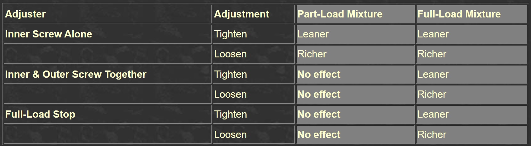

I am working on a date at the dyno as well. Could be this week. Due to the interrelated movements on the MPS, do you have any suggestions on order of operations? Should we set partial load then idle then WOT? Hard to wrap the brain around how changing the outer screw will affect the location of the inner and the stopping point of the stop screw and how all of that will cascade into AFR changes.
ChrisFoley
Nov 9 2021, 10:44 AM
I would see if I can do all the necessary tuning without touching the outer screw.
emerygt350
Nov 9 2021, 10:48 AM
QUOTE(ChrisFoley @ Nov 9 2021, 11:44 AM)
Got it. Do you think pbanders table is useful?
