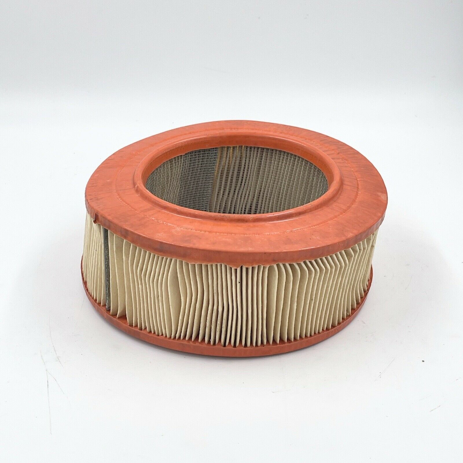

The earlier 1.7s (70-72) use a metal oil bath filter. 1973 1.7s they changed to a round plastic filter. 1.8s use a square plastic filter housing.
The issue with the 73 round plastic housing is finding the proper filter elements for it. You can use the earlier metal filter as they are interchangeable however it would not be "correct" for the year.

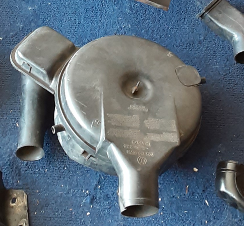

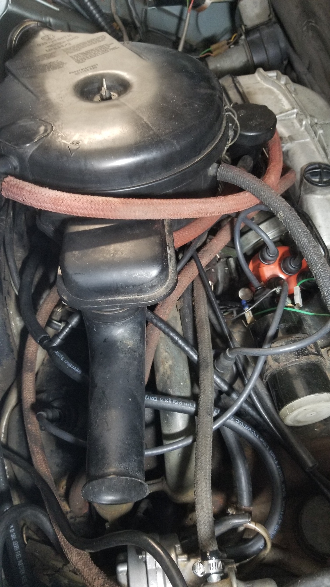

I see. Thank you. My issue is the intake horn is pressing down on the flapper rod that connects both flappers, thus preventing it from proper function. So I assumed I have the incorrect air cleaner.
jrmdir
QUOTE[I see. Thank you. My issue is the intake horn is pressing down on the flapper rod that connects both flappers, thus preventing it from proper function. So I assumed I have the incorrect air cleaner.]QUOTE
The horn should point to the side of the car. See below. You should be able to rotate the bottom of the cleaner (with the horn) when the clips are undone. The top half's orientation is fixed by the rubber connector to the throttle body.
As to the covered up numbers in the trunks, they would (should) be the same as the top number on the Karmann plate: 2639599. This means your car was built on the 3rd day of the 26th week (of 1973.) Or Wednesday, June 27th. This, and the high VIN# (27001) would put it fairly late in the '73 model run, which I believe would have ended in August or September.
The scratched out bottom number is the original paint code.

There was a thread on 1.7 filter elements a while back that has the details, but at that time while there were available replacements that would "fit" in the air filter housing none of the options i checked out actually sealed properly and hence wouldn't be actual filtering any air. The original filter has a raised ring in the center to create the air seal while all aftermarket options even if they are the same factory dimensions lack this detail and allow air over the top of the filter. Others had to large an ID and you could hear them flopping around in the housing if you shook it.
I have a collection of proper elements out in my garage, ill see if i can get a picture later to show you what i am talking about. Or you might be able to find the old thread with the details.
JamesM
For reference this is what the original elements looked like

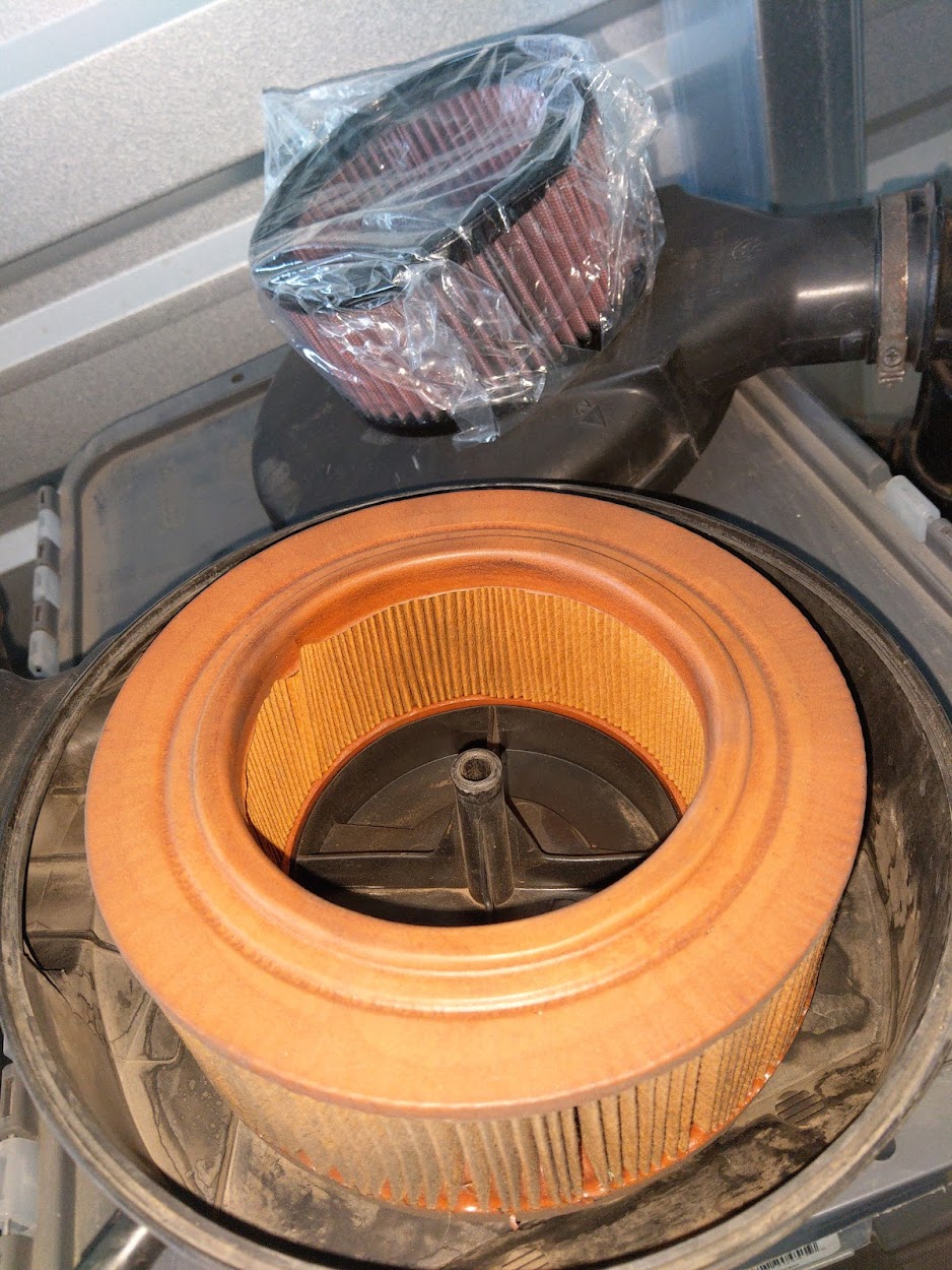

The $7 WIX filter I ordered will be here this weekend. If there's a gap, I'm thinking of trying something like this and will report back.
jrmdir
PSA
Well, unfortunately, the NAPA 2909 discussed above does NOT fit the stock 1.7 round cleaner. It's way off (yellow circle is what the ID needs to be.)
The return shipping exceeds the original cost so if anyone needs it let me know.

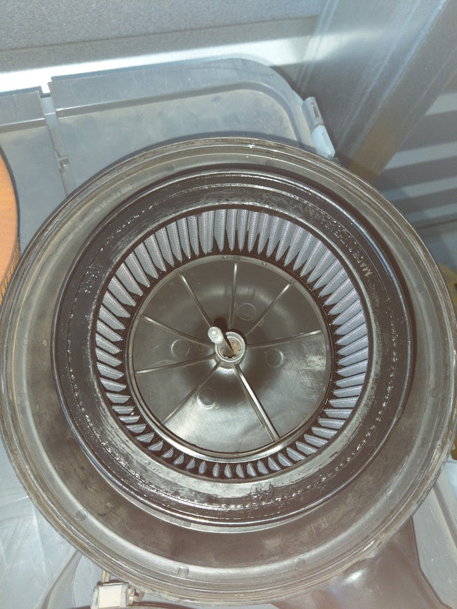

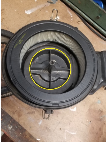

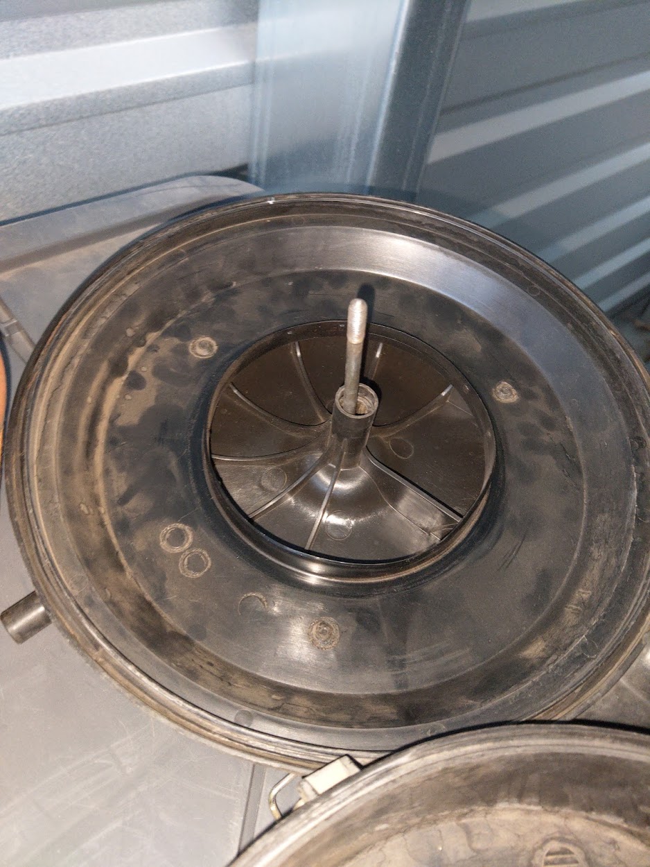

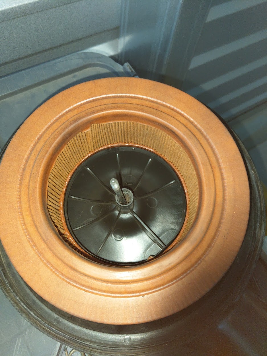

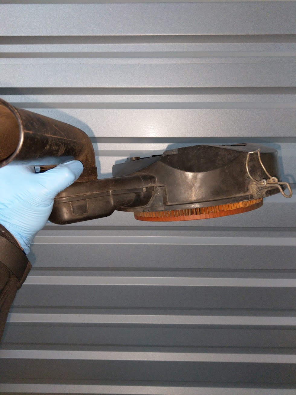

Ok, so my K&N E3270 showed up and I made it out to my 1.7 to take a look at it this weekend.
So... first off worth mentioning is how the factory filter is supposed to fit. snug around the inner ring. So snug that you can hold it upside down without it falling out.
This is how it was designed to seal, not via the top and bottom. Thankfully i recently drove through Redrock country and the remnants of this in my air filter housing make it very apparent. You can see on the top part of the filter housing how little of the filter is actually touching at the top as dirt has made it all the way into the inner most ring

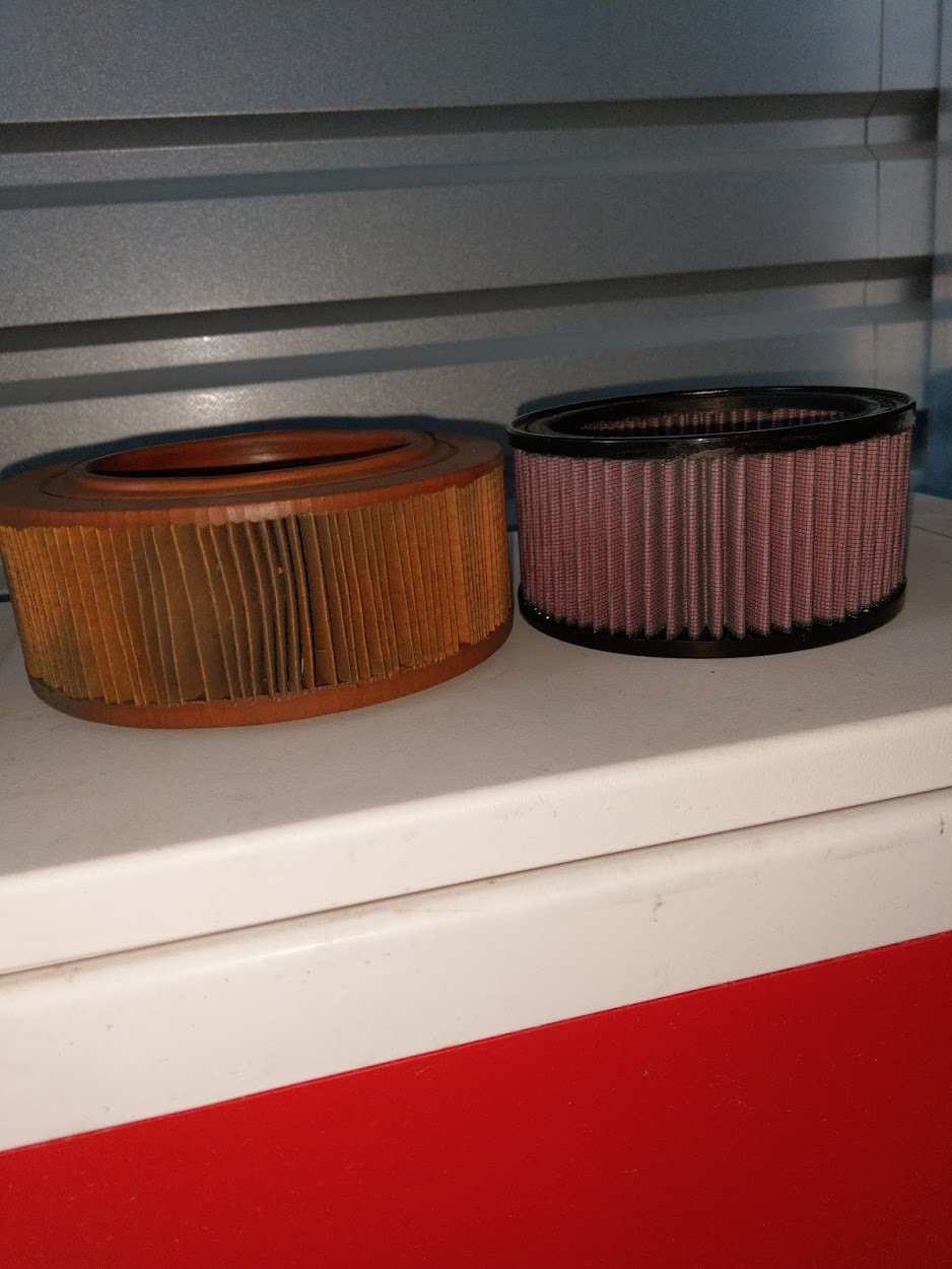

Comparison of the Factory filter and the E-3270
Overall height of the E-3270 is roughly the same height as the inner ring of the factory filter however the OD is slightly larger so it isnt grabbing the inner ring though it is close enough that there are no gaps in the upper and lower contact surfaces. Also the OD is not as large and there are less pleats in the filter material, so I imagine there is considerably less filter material overall, not necessary a bad thing, just means you may need to service the filter more often, but the K&N is washable so that is somewhat of a non issue.
Upon test fitting it the height is perfect. the housing can be clamped closed with only minimal pressure and once the housing is clamped down there is no movement of the filter at all. I suspect this one should seal well enough to actually filter the incoming air.
However after this filter arrived, knowing how they fit now, I decided to poke back into the K&N catalog and found a newer filter that wasn't previously listed last time I looked...
The E-9145 has an ID listed at 124mm (3mm less than the E-3270) and 82mm height (1mm shorter than the E3270). This may be a perfect fit on the inner ring. Biggest possible downside I see is the OD is only 149mm where as the OD on the E-3270 was 160, so its going to be even thinner (12mm vs 16mm) and most likely have even less filter material. Its also 15 bucks cheaper. (actually as I was able to get this one with amazon prime free shipping it came out like 30 bucks cheaper $55 vs $85 )
