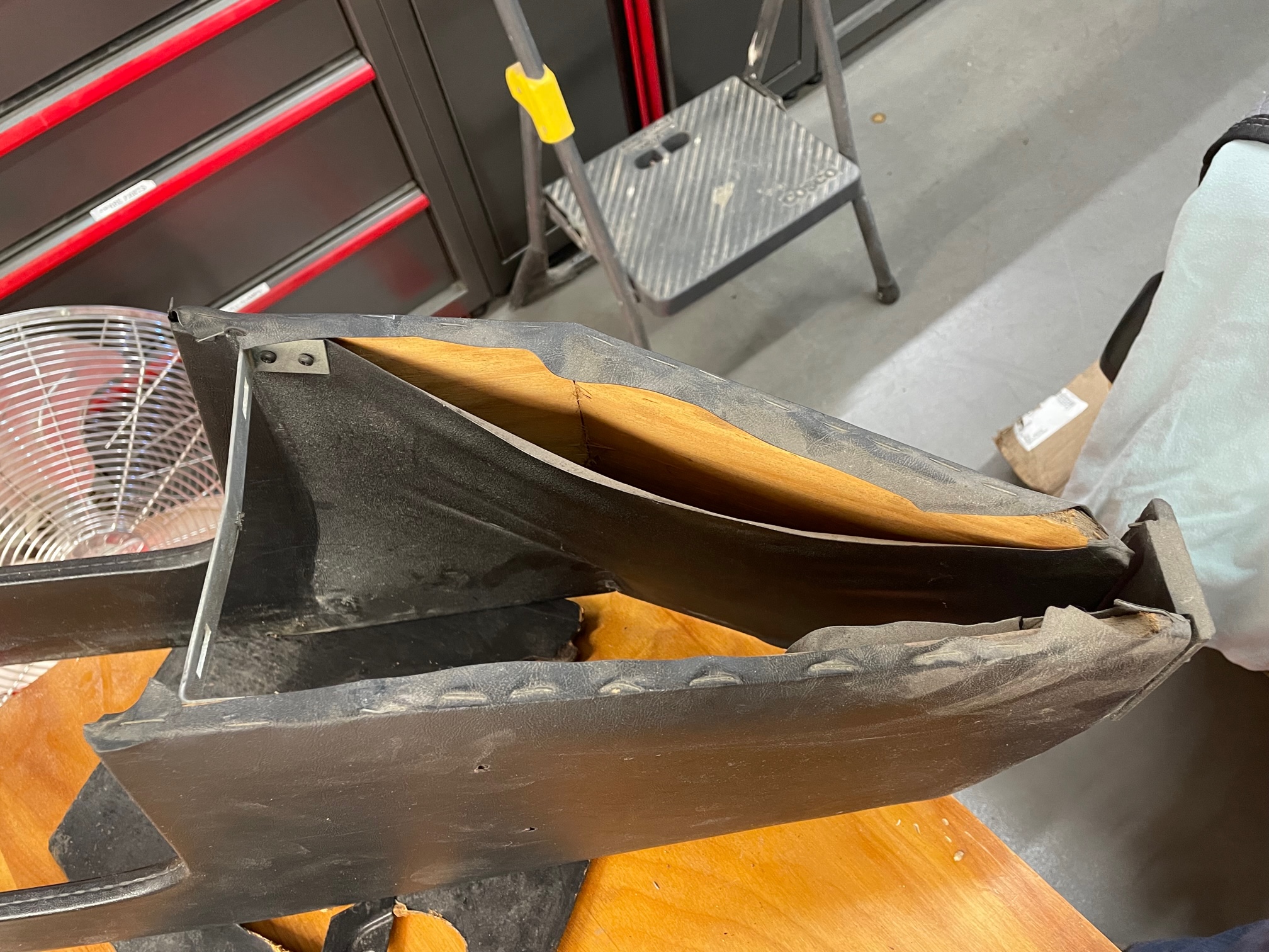

Hey everyone: Moving along on the fuel line upgrade and other related bits. Need some input on how to remove the shifter knob is one. I made a slotted 2x4 block and whacked on it with a small hammer, it didn't move and the block broke. I'm sure it's been off more than once during it's lifetime. How hard can I smack it before I bust something in the linkage? Should I heat it?
And then, the console is in pretty sad shape. I'm pretty good at woodworking and should be able to refresh it. Should I just look for a repro?

Post a pic of the knob. Originally it presses over a crush sleeve, basically a friction fit that should easily hammer off. If that was loose then it likely got glued.
That is a factory console that looks like it was cut down for the under dash A/C unit. I'd make a new one with cup & phone holders & updates.

Thanks fellas, It is most likely the original console cut down, I think I'm going to try to rebuild it. Had not thought about building a new one. What are cup holders?
