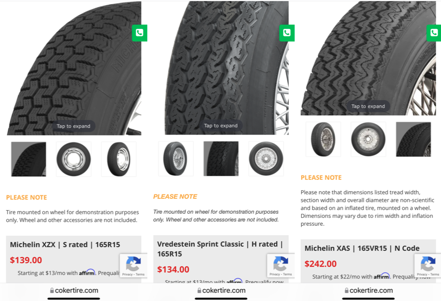

I am looking for some period correct tires for my 74. Wondering if you have recommendations, experience or thoughts about which tire to buy.
There is an 'S' rated tire, a 'H' rated tire and a 'VR' rated tire. Because this car will be driven lightly and the fact that it is stored during winter months I wouldn't think the speed rating is really a factor.
Also, which tread do you like for a period correct car?

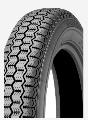

Michelin XZX 165R15
JeffBowlsby
I am going with the XZX when it comes time for my 74 2.0L. To me its the gold standard for our cars of that era.

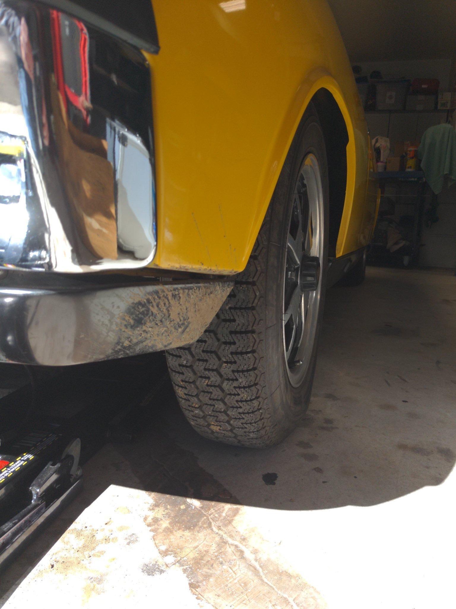

i run XAS on my 74 1,8
no complaints. progressive.
love the feel of the car with the old tall boy tyres.
am back in 1989. no smashing on hard bumps and pot holes.
light steering again.
so far i have not got into trouble.
i'm driving it reasonably hard on occasion but not stupid hard.
but - no good in the rain. i don't drive the 14 in the rain anymore.
eye popping expensive. (in aus ).
the pirellis are more $.
but closer to the original dunlop SPs the car once had.
down here the 911 boys run the pirellis.
seems to be the new groovy tyre of choice.
if you can get your hands on a set.
covid supply chain problems.
the XAS are N code, same as pirelli. ie porsche recommend.
if that means anything.
personally i don't think its all that relevant to a stock 914 small 4.
if you are driving the car lightly go for the vredestiens.
they are a lot cheaper (at least here in aus).
no point in handing out big $ for skinny michelins unless you are going to take corners at a little bit of speed and hold your breath.
all 3 you have posted at top look period right on a 914.
the michelins are period correct.
don't think XAS were so common in the USA but very common on porsches at that time in aus. think dunlop SP were a real north american thing, something to do with being also a reasonable tyre in real winters. i believe the SP was originally developed as a rally tyre. it was also one of the first great tyres to be made in japan. thats where they came from. the japanese dunlop plant.

All three tires look good. Not sure I could justify the additional cost of the XAS over the XZX or Vredestein with limited and light driving.
I like them both but lean to the fact that the XZX were original to the 914 and it looks good… and they are truly period correct since they came on 914’s from the factory when new.

not sure how "correct" you want to be - a XZX (1975) is slightly out.
at best the last batch of 75 cars might have got them.
or you might have put a set on as replacements in the late 70s.
XZX superseded ZX.
914s had ZX (1968) fitted new in some markets.

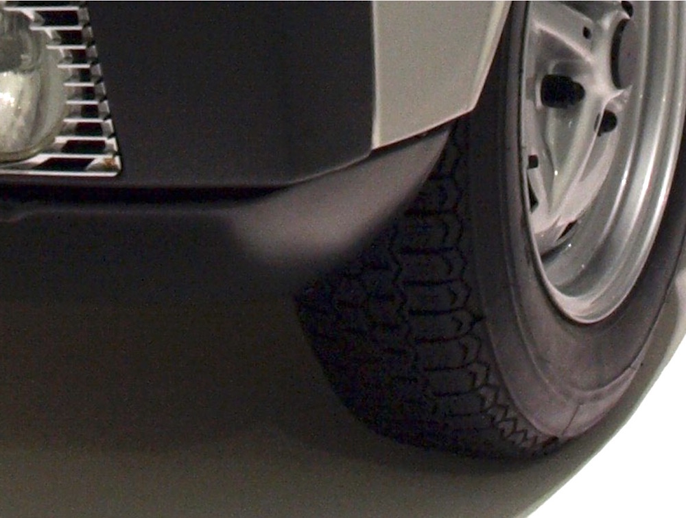

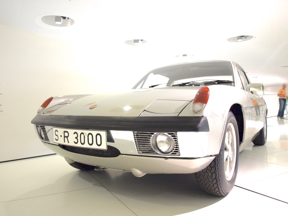

attached an image i took of dr. marchant's 74 1.8 in the porsche museum 15 years ago.
don't know if they are original tyres. if not i'm guessing proper replacement originals. ZX. car is otherwise unrestored i believe. beerchug.gif

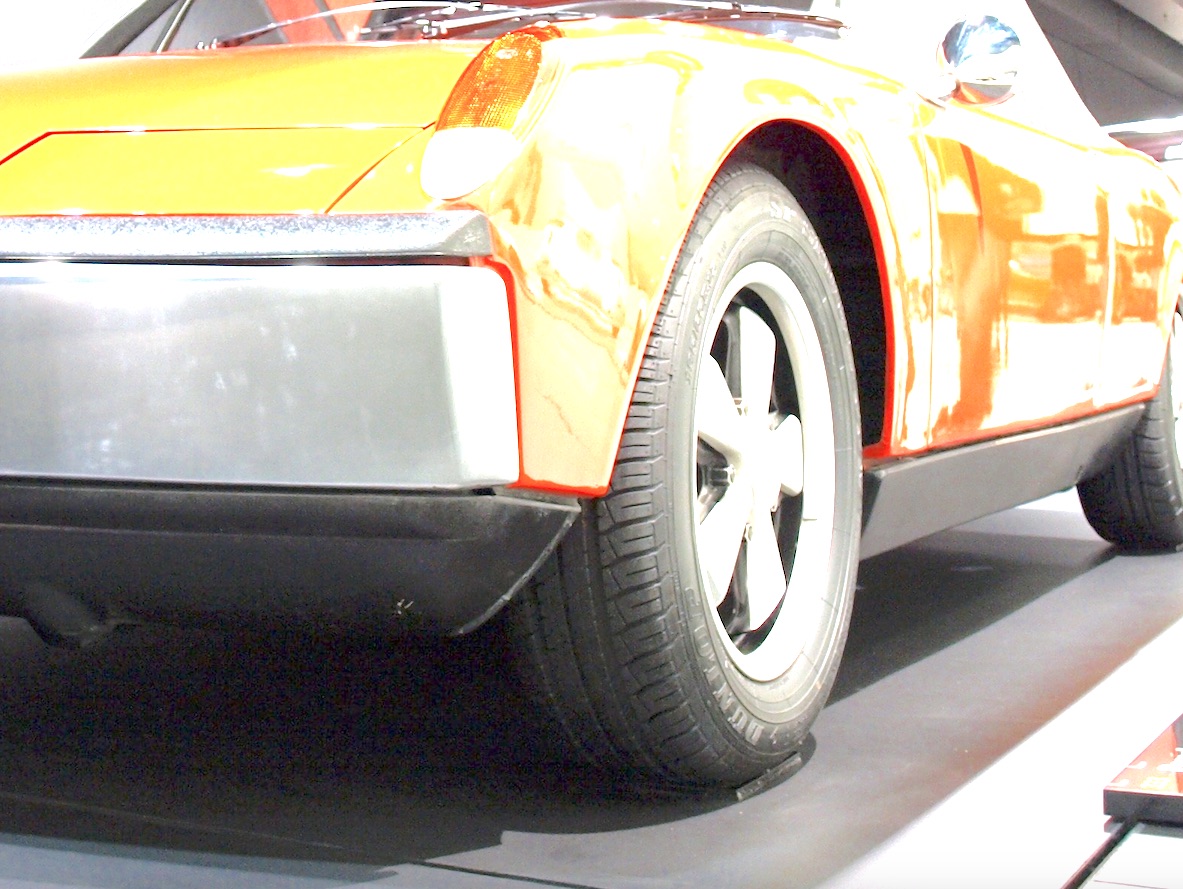

extra tit bit.
piech 8 from same time i took snaps of mr. m car.
looks like it was running dunlop SP sports at that time.
you can buy a dunlop SP classic at present - very similar modern tread pattern to piech car in classic sizes.

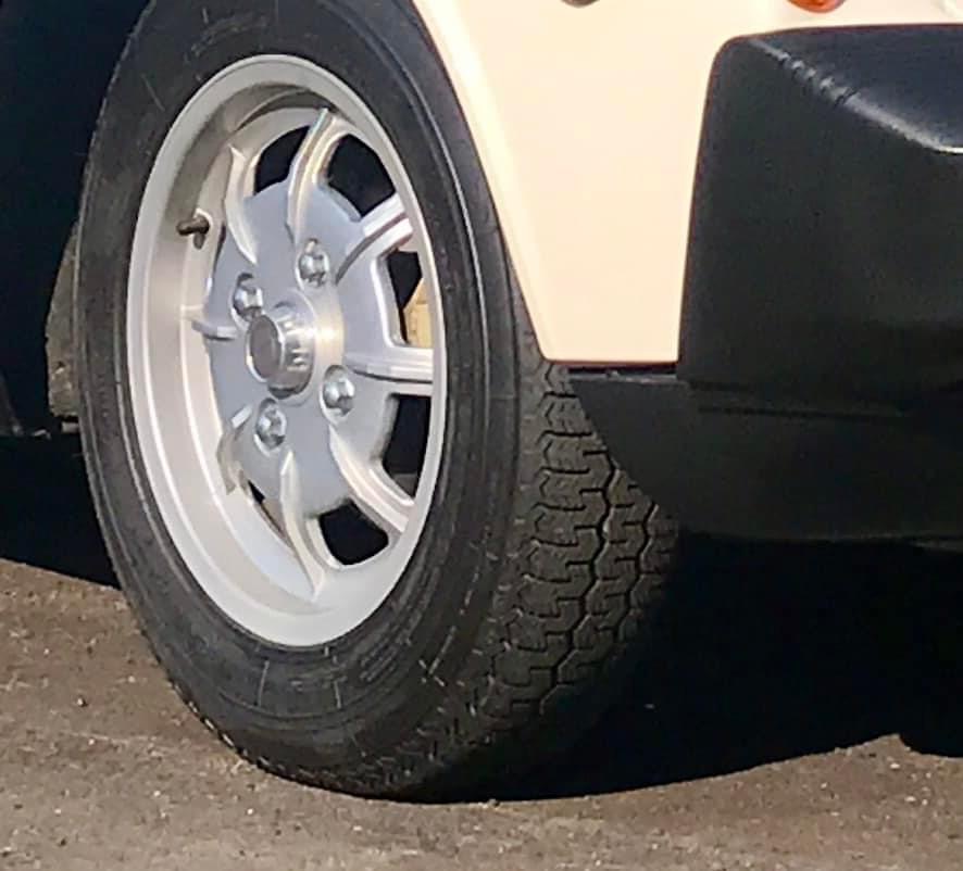

this was with photos of other 2.
dr. f porsche's 8.
was running XWX.
serious tyre for the time.

the XZX are also all tubeless.
wonkipop
QUOTE(Jett @ Feb 8 2022, 03:06 PM) *
QUOTE(wonkipop @ Feb 8 2022, 12:08 PM) *
dr. f porsche's 8.
was running XWX.
checked out prices -- i thought XAS burned a thermo nuclear hole in my wallet! blink.gif
(bum steer on ZX above, period correct but michelin don't do them in the size, only the XZX in a 15 for a 914.)
+1 this is what we use
well --- you won't be complaining about those.
did you get them for a reasonable price?
the $ tag on them here in aus is beyond eye-watering. talking $600+ (aud) a corner.
Van B
QUOTE(wonkipop @ Feb 8 2022, 04:21 PM) *
i don't think you can go wrong with a vred at 185 @Van B
i was set on going 165 wide and getting that steering feel back.
i got a bit nervous and went for the best i could do at that width.
dunno about being cool, dumb maybe parting with the $?
would have been plenty angry if they were awful.
i had to make a few phone calls for reassurance from a couple of guys who run them before making the final call.
the NO version (porsche rated) are tubeless. i think all the other XAS require tubes.
i would not have got them if they had to have tubes. i think that is the sole reason for the porsche rating of NO, it is to do with being a tubeless tyre version.
Good call on tube vs tubeless. I checked again and the XVS is tube type so, that means the vred is my only option if I want to get the speedometer accurate.
wonkipop
QUOTE(Van B @ Feb 8 2022, 04:06 PM) *
the XVS they sell here is tubeless. (pretty sure about that but could be wrong).
you might want to check - it should not have a tube. the XVS is even fancier than the XAS. rated to higher speeds and harder cornering. driving.gif anyhow, the vreds at 185 wide will be pretty good. nothing wrong with them.
all the XAS are tube tyres apart from the XAS NO. NO being that smart porsche approved number. i think the pirellis also carry that NO designation.
