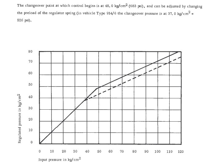

There are different part numbers for the pressure regulators on the 4 and 6. Anybody know what the difference is?
Superhawk996
The difference is in the set point at which the "regulator" begins to proportion rear brake pressure.
914/6 has a lower pressure knee point due to larger rear caliper pistons 38mm vs. smaller 33mm pistons for /4.
I belive PMB can reset a /4 regulator to the /6 set point if need be.
There are also two types (early & late) for /4's where the inlet and outlet ports changed location to accomodate different mounting locations between early and late. If you were going to try to obtain and use a /4 regulator for a /6, you would want the early version.

The previous owner had changed out the pressure regulator for an adjustable proportioning valve, I'm going back to stock. Are there any visible differences between the two, or do I have to hunt down a /6 part to have Eric rebuild?
QUOTE(zoomCat @ Feb 13 2022, 09:54 AM) *
I don’t think there is a visible difference. I think it’s more of a setting on the part to achieve a different pressure release. I would think it’s a needle in a haystack to find the original six part. I would ask Eric directly but I bet he can achieve the exact same performance from an early 914-4 piece.
