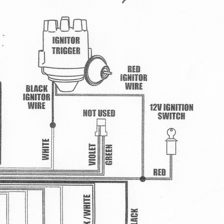

There are 2 black wires joined together coming off the + side of the coil. One goes to the ignition switch, where does the other one connect to?

I am installing a Pertronix digital HP box. They are showing the wire from the ignition switch going to the red wire on my Mallory distributor. The 2 wires black wires are attached together. Just want to be sure one doesn't t stay on the + side of the coil.

Feb 12 2022, 08:49 PM
