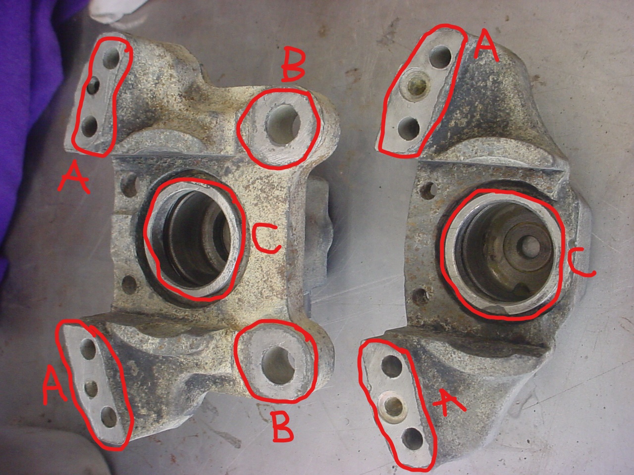

Here's a photo of the cleaned parts. I've labelled the areas I think I need to cover with tape:
A are mating surfaces, so it seems those need to be kept smooth and flat.
B may not be critical, but they are mating surfaces so...Any thoughts and comments?
I'm mostly concerned about the piston bore area (area C). According to the PMB document linked above, this area will be plated, so it needs to be cleaned.
914Sixer
I always cleaned the complete. I used duct tape to cover what I did not want to blast.
Are you getting them replated? Getting the piston bores replated is really the important part to longevity.
Shivers
Don't forget to plug the bleeder ports.
Sycolyst
I glass beaded mine covering all the internal openings. I then wiped them with lacquer thinner and blew them out with compressed air. I took 1500 grit sandpaper to de-glaze the piston bores. I painted mine with caliper paint and installed all new rubber and rebuilt them. They came out great. Take your time, it's not a hard project.
PatMc
QUOTE(Sycolyst @ Mar 12 2022, 08:42 PM) *
Depends...are you going to have the castings replated or leave them bare or paint them?
If replating, don't mask anything, blast everything. Assuming this is a relatively small home based blasting setup and not some 300 PSI deal where you can blow holes through things, nothing will be damaged or hurt at all. Aluminum oxide or glass bead or whatever media you choose will work fine. All calipers at the commercial level rebuilders are blasted with steel shot, and nothing is masked....and if they don't leave them in the blaster for 3 times as long as they should, there is zero damage to the casting or any machined surfaces.
If you're not going to be replating the castings, then I'd mask off anywhere that plating still exists...like on the mating surfaces between the halves. I'd also follow up with a wire brush on a drill or grinder to polish the bore and seal groove as best you can after blasting, then coat the bore/seal groove with a good caliper assembly lube (containing rust inhibitor) ASAP. The caliper will still likely be short lived without any plating or surface conversion treatment of the bore (when my customers request painted calipers, the castings get a zinc phosphate treatment for at least SOME protection and better paint adhesion).
