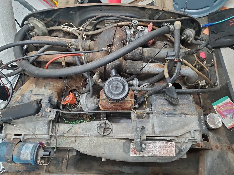

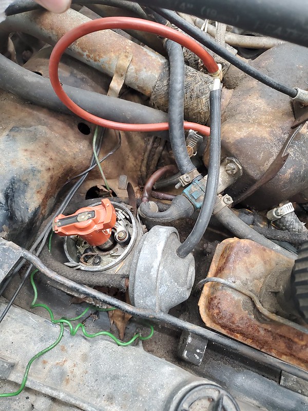

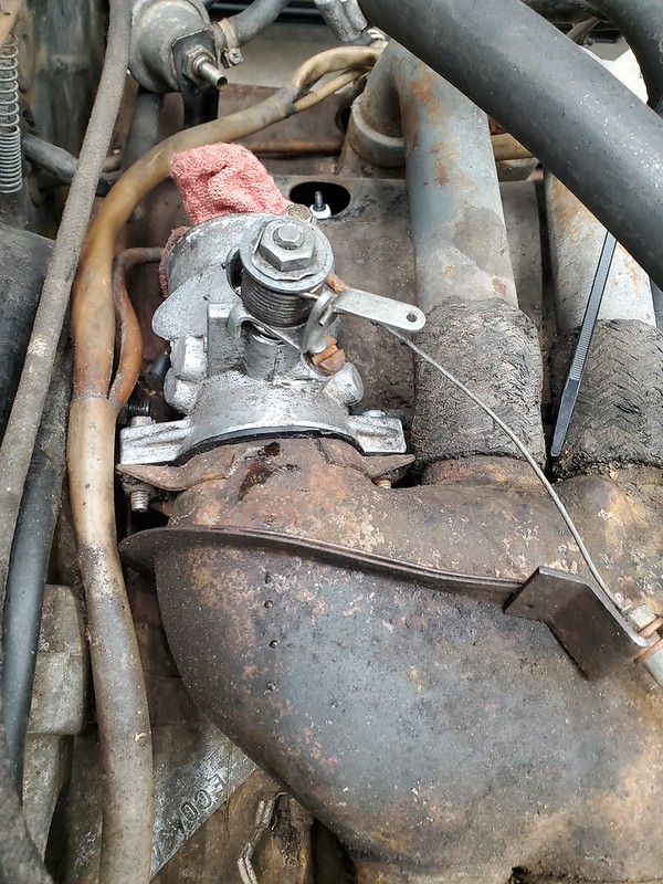

I'm missing number 2, but have the other items pictured. Also already have the pushrod tubes out on the 3/4 side. Going to reseal those and the temp plate, then give this underneath a bath.

wonkipop
hey @nditiz1
thanks
thats fantastic.

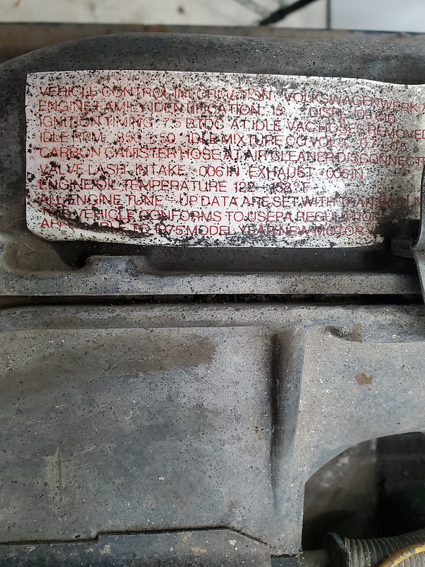

i see its a 920
there are two circular plates on the bottom of the engine sump.
one is on the front end (fan end).
is that a plate for an oil temp guage sensor connection that takes the electrical wire?
or is the plain type which just has a bump in it and no capacity for a temp sensor?
you got yourself a 49 state engine.
and it looks pretty intact with all the components there.
what state they are in is another matter.
but the photos are good.
a few other members can pipe in now and give you some opinions.
your intake plenum looks a bit suss, but you would know all that yourself.
i assume you got an aircleaner/afm/intake boot and ECU with that and are just not in photos.

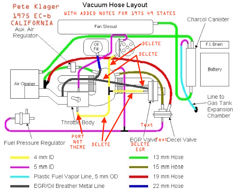

wonkipop
@nditiz1
correct vacuum hose diagram posted below.
courtesy of pete klager who drew it years ago - was posted on pelican parts forum.
for the 75 calif spec car.
that engine you have is the 49 states car.
did not have exhaust gas recirculation.
i made some notes to assist with what is different.
this will help with hoses.
