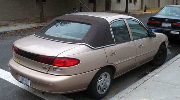

I have a 74 914 wondering if the original targa top was covered with a skin the way that the sails are on either side ? I have always thought the finish on my targa top was original but now I am questioning this
Superhawk996
No "skin" or bad landau top. Basically a gel coat type paint directly on the fiberglass.
Hopefully you don't have something like this

I believe that's what I have some sort of gel... It looks really good though.
infraredcalvin
bkrantz
Some PO did cover my top with vinyl, rather thick and not matching the sail panel vinyl. And they did a REALLY good job of gluing it on.
