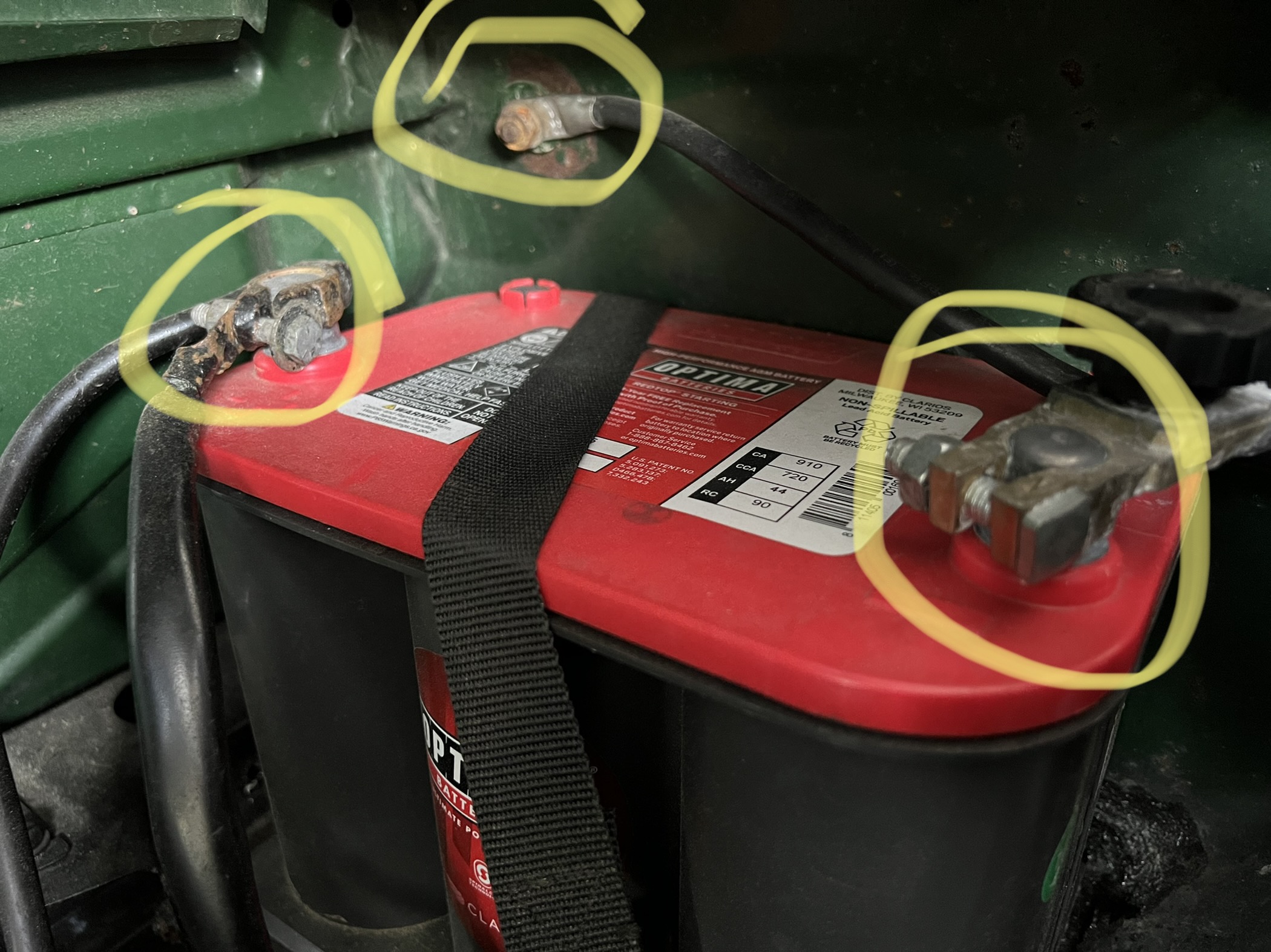

Hmm, I hadn't thought about voltage drop off affecting the FI system. The battery on my car is on a trickle charger and seems fully charged when cranking the starter. No red alternator light in my case. Question: does the FI system run off the battery, in other words, if the battery is fully charged but the alternator is sub par, could the FI system be affected?
Also check all the grounds. Easy to do and while you are doing it, you may notice something else.
Lockwodo
QUOTE(mepstein @ Apr 12 2022, 12:49 PM) *
Thanks Mepstein, you're right and that's related to the potential voltage issue. My understanding is the most important ground points for the FI system are the negative battery cable to chassis connection, the connectors that are on the top rear of the engine under the air cleaner, and the transmission to chassis ground. I've taken care of the first two and the tranny to chassis ground point is on the list.

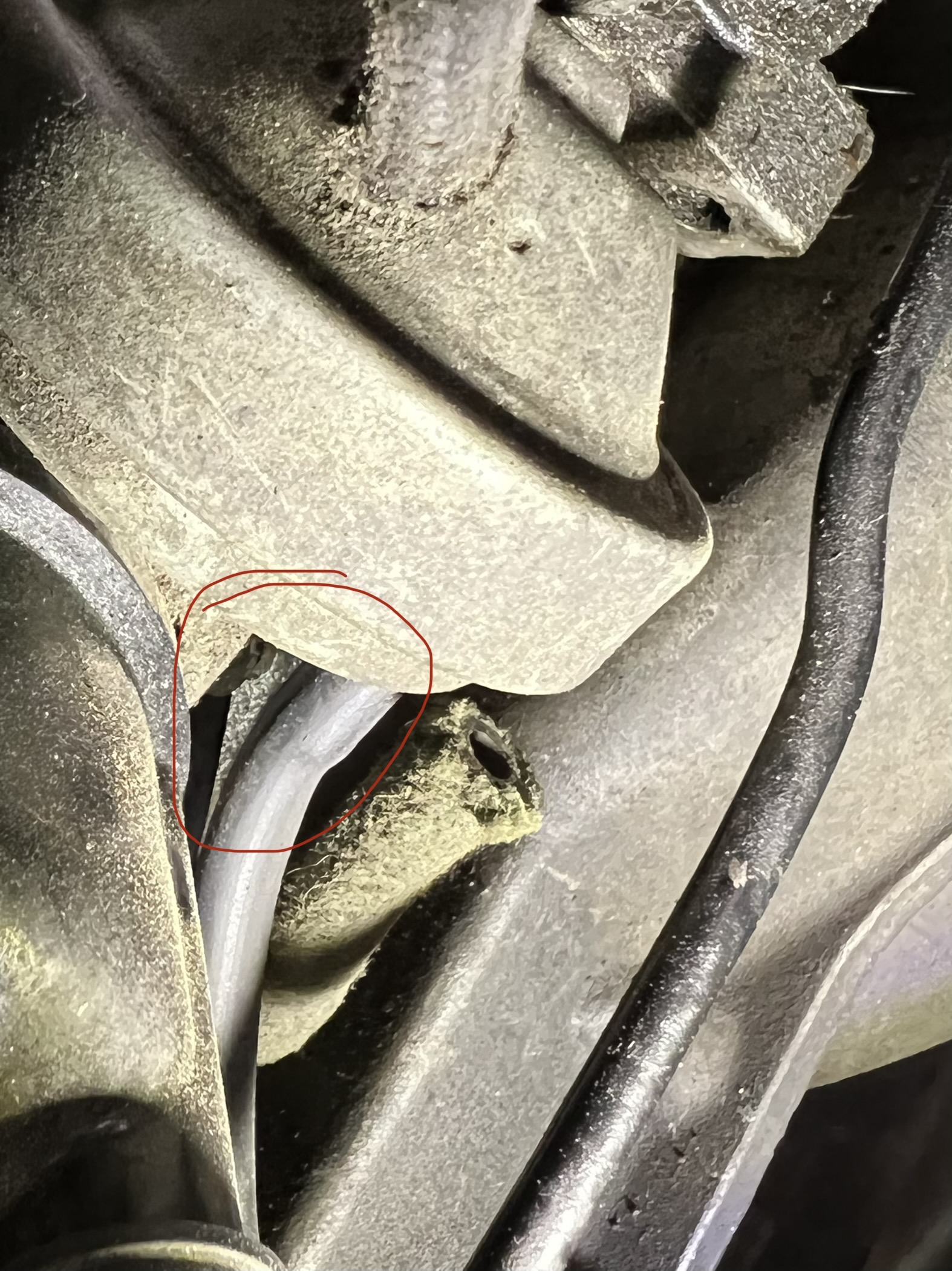

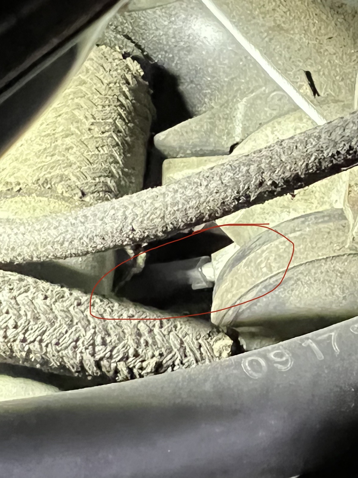

I changed the 4mm line (yellow in the diagram) after the fuel filter change and took the car out for a 10 minite run and there was no bucking at all.
Here is a picture of the new line:
At the throttle body
At the vacuum can
I welcome your feedback.
What is the function of the 4mm vacuum line that I changed? I don't know what it does. Could this have been the problem?
Thank you for all of your help.
wonkipop
if its anything like a L jet, its the vac retard line from the distributor to the throttle body.
not sure exactly how they work with D Jet but know in L jet its to retard the ignition at idle mostly. it retards timing when there is engine vac, in L jet its on the manifold plenum side of the throttle body so its functioning when the throttle plate is closed at idle. mostly there to assist with emissions on L jet.
D jet guys would be able to tell you exactly how it works on your car.
but aside from it possibly affecting the retard which i don't think is significant in terms of sitting there idling it would have been an air leak into the system.
combine that with your fuel pressure or fuel restriction problem and your mixture leaned right out. why it wouldn't idle, hard to start and was bucking.
you have probably been driving around the minor air leak (and it does look minor) for a while and not even noticing it. i think your main problem might have been fuel restriction. the air leak would have exaggerated it, perhaps not a lot.
good work solving it.

I have more data to report on this issue.
The car has driven flawlessly up until yesterday when I started it cold and it ran rough and when I drove it it was bucking.
I drove for about 1/4 mile with lots of bucking and then turned it off.
About 30 minutes later I tried to start it and it was completely dead no click, no lights no nothing upon turning the key.
I opened the hood and manipulated the battery wires.
I've included a picture with yellow circles around the wires that I manipulated.
I turned the key and it started fine and no bucking.
This would suggest that this is an electrical issue, yes?
Is there a map on the web somewhere of the ground wires that I can check?
Any other suggestions?
