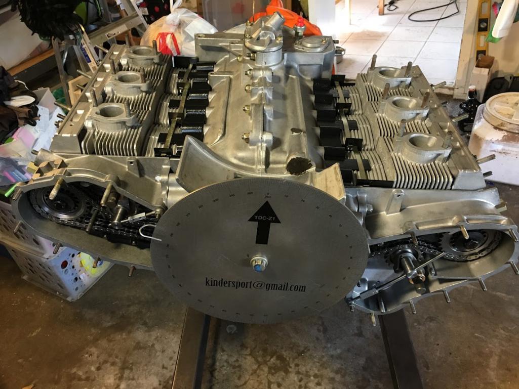

burton73
Cam timing on my 6
This is not so easy and you need a number of special tools to do it.

Have you checked the valve to piston clearance ? This is a step you can't miss if you swap out cams. What engine size are you working with? E cams into a T engine?
Like stated above, it sounds like the valves hit the pistons. You may want to take a look at the pistons and valves. If the rockers broke more then likely a valve or piston maybe damaged as well.
I've done cam timing on several 911 engines. By far the easiest method/tools I've found is by Stomski Racing. I use their digidix tools and I can get dead nuts results.
https://www.stomskiracing.com/products/digidix
If you're gonna just do this once the price of the tool may or may not be for you. I've used this tool on two engines and have one more to do. Watch the video on the link if you haven't already seen it.
ClayPerrine
I have lots of experience with setting the cam timing on 911 engines. I always suggest that you remove ALL the rockers on both sides, then put in just the intake rocker for the side you are currently working on. Once you have it set, then put in the one on the other side and set it.
I always use two digital dial indicators, and once I have them both set, I go back and make about 4 more rotations to verify that the valve clearances are correct and the cams are timed right.
Only then do I put the rest of the rockers in the motor.
If you do this, and are careful about not forcing the engine to turn when you get resistance, you will not bend any valves.
Just my $.02.
Clay
