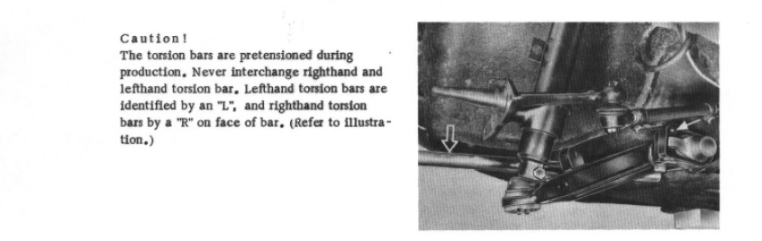

I took the two torsion bars out, neither of them are damaged, all of the paint is fresh (RED) HOWEVER I was a bit confused.....
1. There is a blue strip on the torsion bar, should it be towards the front or rear?
2. BOTH of these rods are marked R as in RIGHT. There are two RIGHTS....pretty certain that these have never been out. Lot's of reasons but my question is there really a Right and Left for torrsion rods or would they put in what they have?
