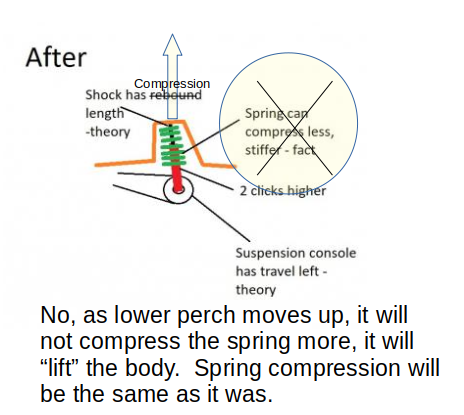

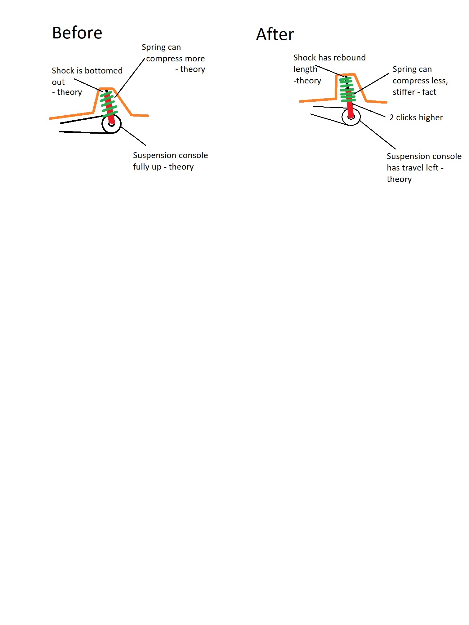

Check out my crude drawing to see if logic is correct.

The notches on the rear of Bilstein's with the snap ring retainer are for adjusting ride height. Has no effect on spring rate and/or the amount of spring compression required to hold the car up at curb weight.
I'm not sure if I'm misunderstanding but want to clarify definitions:
Upward (in Z height) travel of the wheel is called compression or jounce. [Tuning terms are defined from the perspective of wheel motion]
Downward travel of the wheel is called rebound.
Sag -- this is the amount of suspension travel used to support the vehicle at curb weight.
So what you have is basically a situation where the rear damper ride height is set so low that what you have used 100% of the available compression travel for the damper and have no travel left on the damper road. Another way to think of this is that you have 100% sag. i.e. you used all available rear suspension travel just sitting at curb height.
By raising the rear spring perch, you'll gain back some of that compression travel.
I'm going to stop there or this will be come a white paper on spring selection and where the damper should be as a % of its travel at curb ride height. As a general guideline - you want more compression travel than rebound travel. If / when you start hitting the jounce bumpers, the suspension changes character quickly (in a bad way). Bottoming the suspension is also drives very high spike loads into the chassis and leads to component and/or sheet metal fatigue.
Bottom line: Make sure you have plenty of compression travel. If the rear ride height ends up being visually unappealing to you, then you'll need to step up the spring rate.

Ahhhhhh, ok so the lack of compression in the rear is:
Common per Mark
and
Could also be due to %100 Sag
Now, by clicking up 2 spots on the Bilsteins I will in theory gain some compression due to Sag being at 75% which will also increase my ride height hopefully not to a "raked" look.

Not at all, will increasing ride height, increase shock travel? Compression?
Also, in terms of a formuala
Compression travel = Rebound travel - just realized the idiocy of this formula - if the body were to lift then there would be less rebound travel than compression
I should have said I don't want excessive rake
Superhawk996
For simplicity sake, let's say the motion ratio between wheel travel and shock travel are 1:1.
So for 1" of movement of the wheel you get 1" of spring compression and of course, 1" of damper rod travel.
Assume; added 200 lbs for /6 engine, lines, oil, oil tank etc. (assume it was all added the rear corners - won't be true but let's assume for simplicity)
So with 100 lbs/in springs that extra weight would result in the car sitting 1 inch lower than it would due to the 200 extra lbs has to be supported. Each spring will compress 1" adding 100 lbs of vertical force x 2 springs = 200 lbs. This means the car will be sitting 1" lower at rear.
But, you also LOST 1" of compression travel.
By pushing the lower rear spring perch up 1" you get your compression travel back and you're back to the original ride height. There is still an extra 1" of compression in each spring that is there - it was needed to support the "extra" 200 lbs of weight added to the vehicle. You've just moved the whole compressed spring upward (and the body with it).
Now let's look at 140 lb/in springs:
The added 200 lbs from the /6 engine would result in 0.71" lower ride height since you're now using stiffer springs to hold the rear of the car up.
The Bilstein rear ride height adjustment notches are about 0.5" apart.
So now, you would probably only have to push the rear spring perch up 1 notch (instead of 2) to offset the lowering caused by the extra 200 lbs. Overall, you would lose 0.21" of compression travel, the car would be at 0.21" LOWER than the /4 position and you would have less rake vs. the /4 starting position.
This is overly simplistic because the assumptions I've laid out ARE NOT true. But it gives you a general idea of why you might want to move up to 140 lb springs if you can't get the rake of the vehicle where you want it with the 100 lbs springs.
