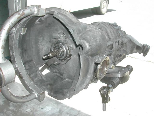

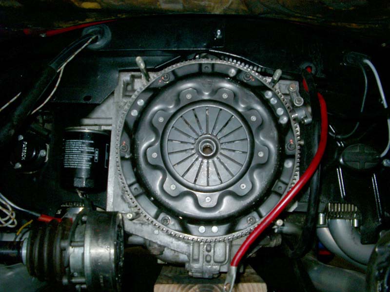

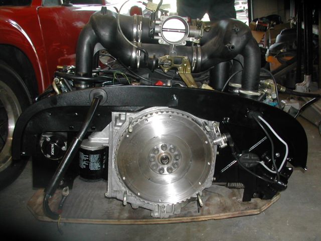

Not the best pictures but i don't remember this being especially difficult.
Test fit the trans, mark the sensor location, cut.

All I did was slide the 914 gear box onto the 3.2 motor as far as I could and then mark with a felt pen where the trans hit the two sensors and cut out a notch with a dremel tool.

It isn’t that hard. Angle grinder, sawzall, file. Your choice. I lined things up on the studs and semi-measured and eyeballed. Of course I didn’t want to look like an amateur, so I drew lines with a Sharpie. Fit just fine without letting too much of the elements in. Good luck with the search for your parts stashed away!
