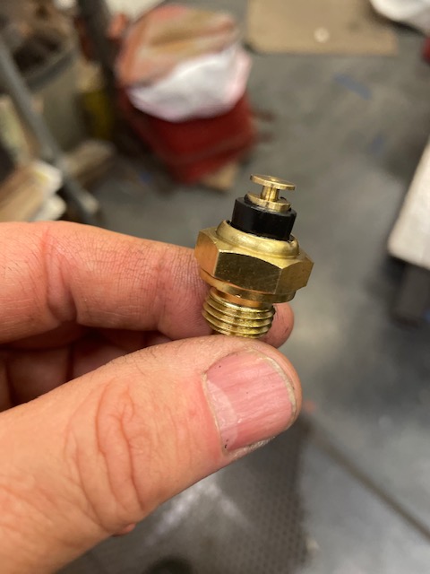

I'm thinking to add a 911 oil temp & pressure gauge to the center console of my 914. I have a gauge from a '69-'74 911. Recently got the correct temp sensor for it. But it looks like this:
I'm stumped on what kind of electrical connector Porsche used on this. All my Googling brings up nothing. Can't find anything on the main 911 parts sites. Any ideas?

Usually a female 1/4” spade terminal will work on these.
Dave_Darling
Does the end of that connector unscrew? I think it might... If so, a ring terminal would work. The fork-shaped spade terminals would also work, and even just putting bare wire in there and screwing the end on tight would also work.
--DD
Retroracer
So the top of the sender measures 8mm in diameter; a 1/4" female spade connector can be made to work, but you'll need to widen / reform the mouth carefully using needle nose pliers and a small screwdriver to get a good fit. Might take a few tries to get right, but can confirm a good reliable contact can be made.
The Porsche wiring looms have a the proper connector, but not sure if this is available to buy - others may chime in here.
The end of the sender does not unscrew. It is designed to work with a slide on receptacle for any orientation of the sender once torqued home.

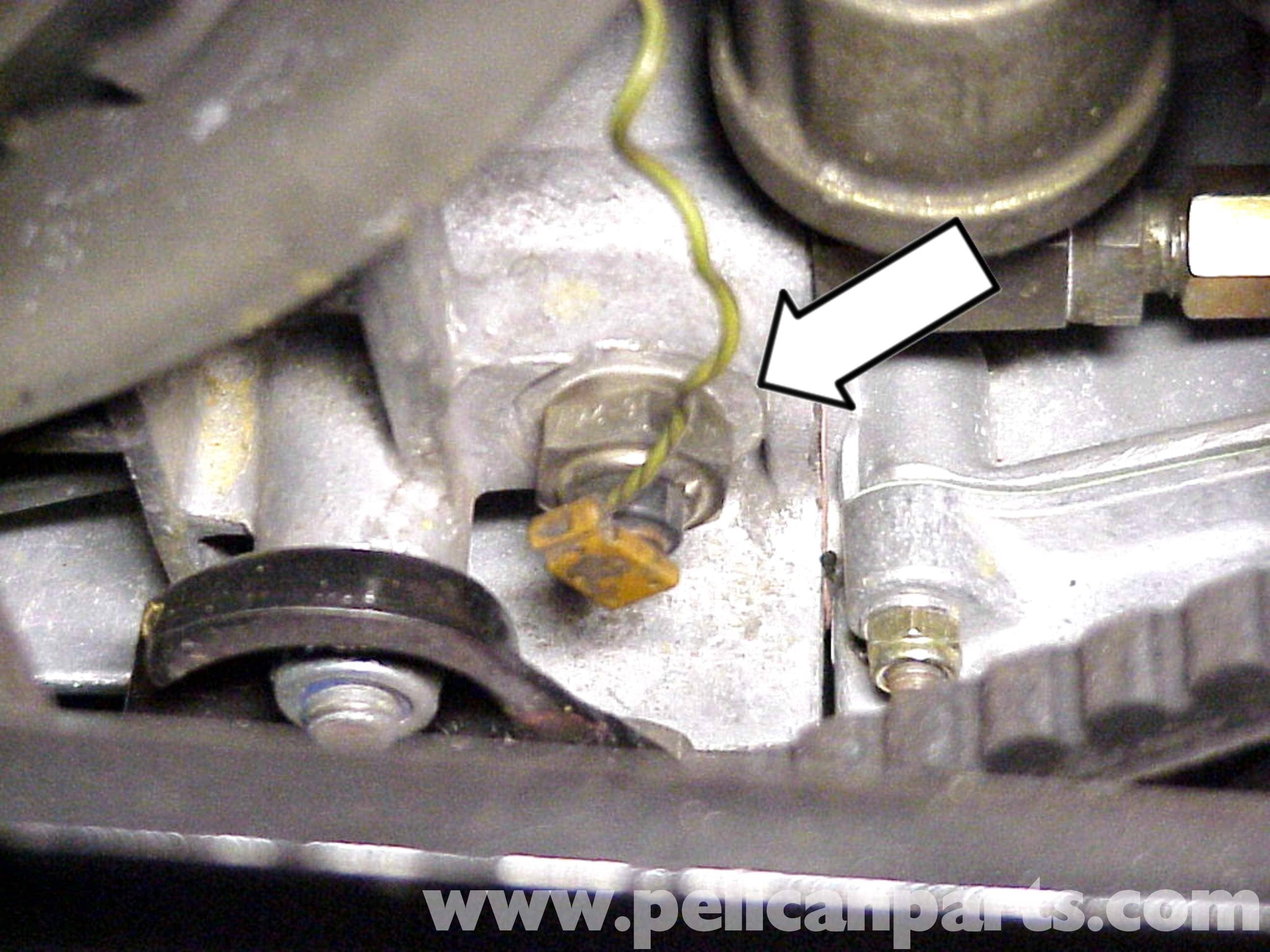

Can someone who has this original wire terminal/connector post a photo of it? I may be able to locate it
Root_Werks
QUOTE(michael7810 @ May 19 2022, 04:58 AM) *
Just push the female spade over the little circle thing. Works fine.

Retroracer
@Montreal914 and @JeffBowlsby :
- Tony
Krieger
QUOTE(Root_Werks @ May 19 2022, 01:14 PM) *
Has worked well on both of my 914s for years.
Montreal914

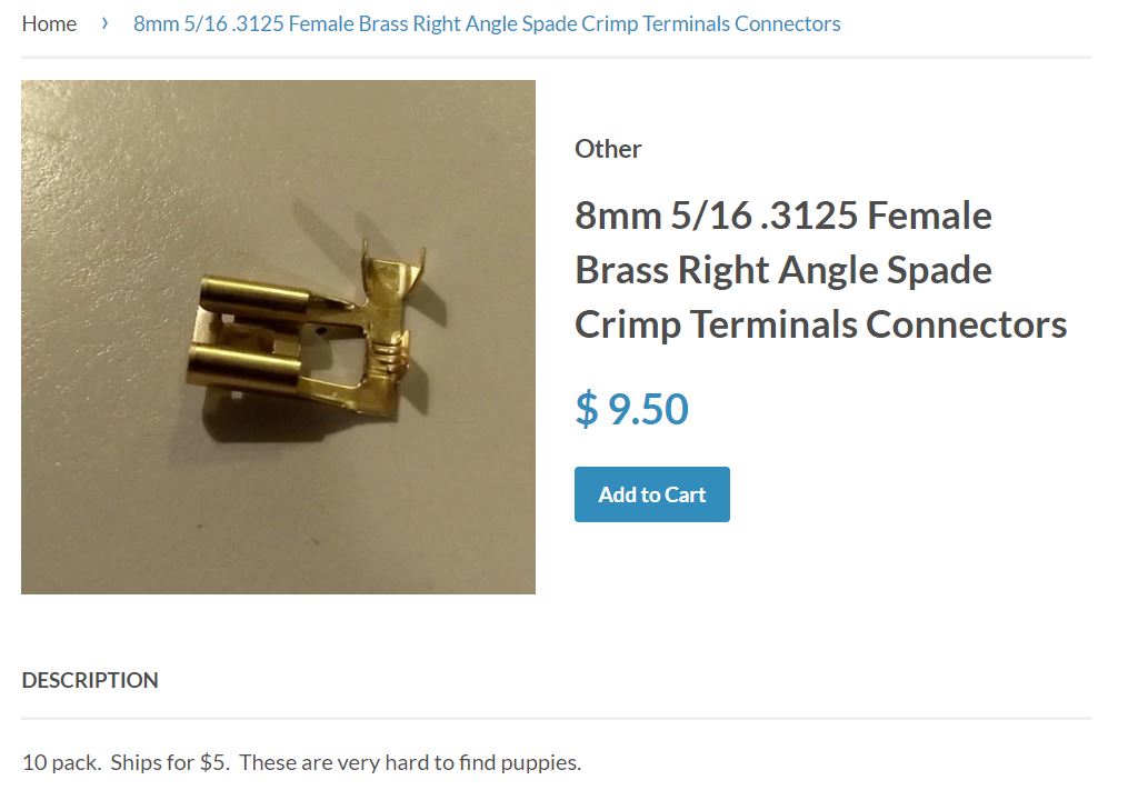

Thank you for the picture Retro. Sort of a larger spade connector.
EDIT: Doing a quick search for a 5/16" spade connector, I found this.
https://inlandappliance.com/products/8mm-5-...crimp-terminals
