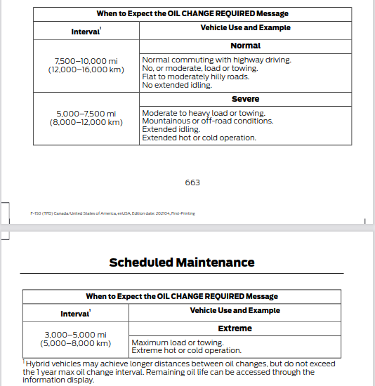

Google all the major OEM's and see if you can find anyone recommending oil changes every 3,000 miles unless there is severe service. As @bbrock stated, even back in the day, the recommendation was 5,000. Most OEM's are right around 7,000 - 10,000 miles for normal use with Dino oil (see graphic pulled for F150). You will note there is a recommendation for a 3,000 mile interval only if Max towing is the normal service, and/or if the vehicle operates in severe hot or cold environment.
Let's also ask who is recommending 3 months or 3,000 miles. Turns out that is largely the Quick Lube place, or your mechanic. They even put a nice little sticker on your windshield to remind you to come back. Think they might have a vested interest in selling oil changes?
Finally, you can do some independent research and you'll come to the conclusion that there is a general consensus that changing oil every 3,000 miles is unnecessary.

Exhibit 1
2021 F150 Maintenance Schedule.

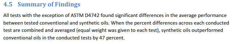

By now there is no dispute. Synthetics are superior to Dino oil.
Synthetics are superior in the following way:
Resistance to oxidation -- this is the most compelling reason to use them.

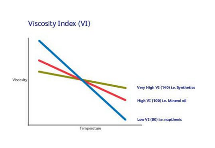

Synthetics have a more consistent Viscosity Index. This means they don't change viscosity as much as a function of temperature. DO NOT confuse this with viscosity itself (i.e. 5w20, 30W, etc.) This is a measure of viscosity stability as a function of temperature.
Again, don't believe me. In 2017 AAA did a pretty decent 3rd party assessment of the synthetic vs. conventional oil debate.
Results:
Complete study:
https://newsroom.aaa.com/wp-content/uploads...AL-EXTERNAL.pdf
I'll leave it up to debate as to whether the cost delta is "worth it".

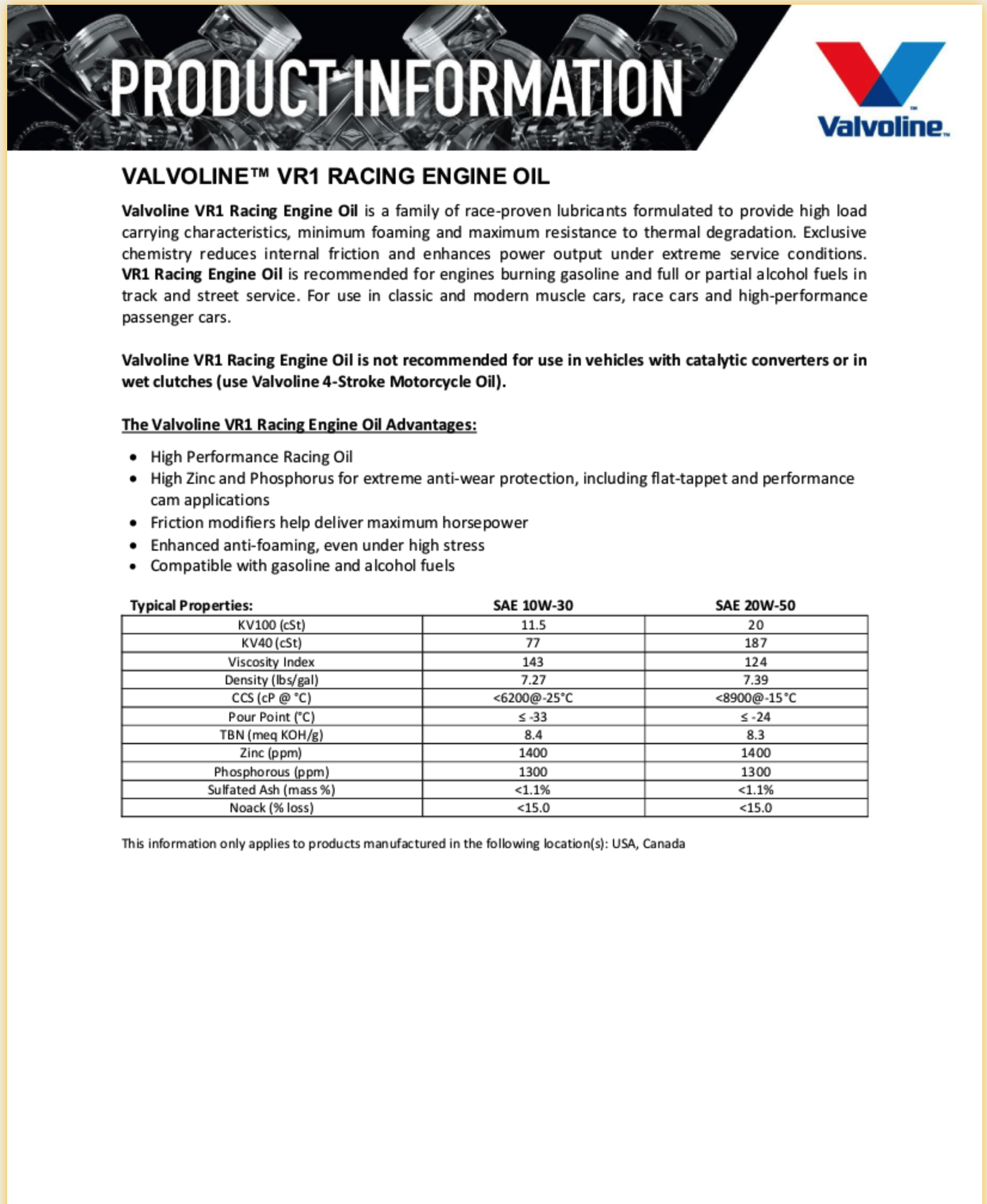

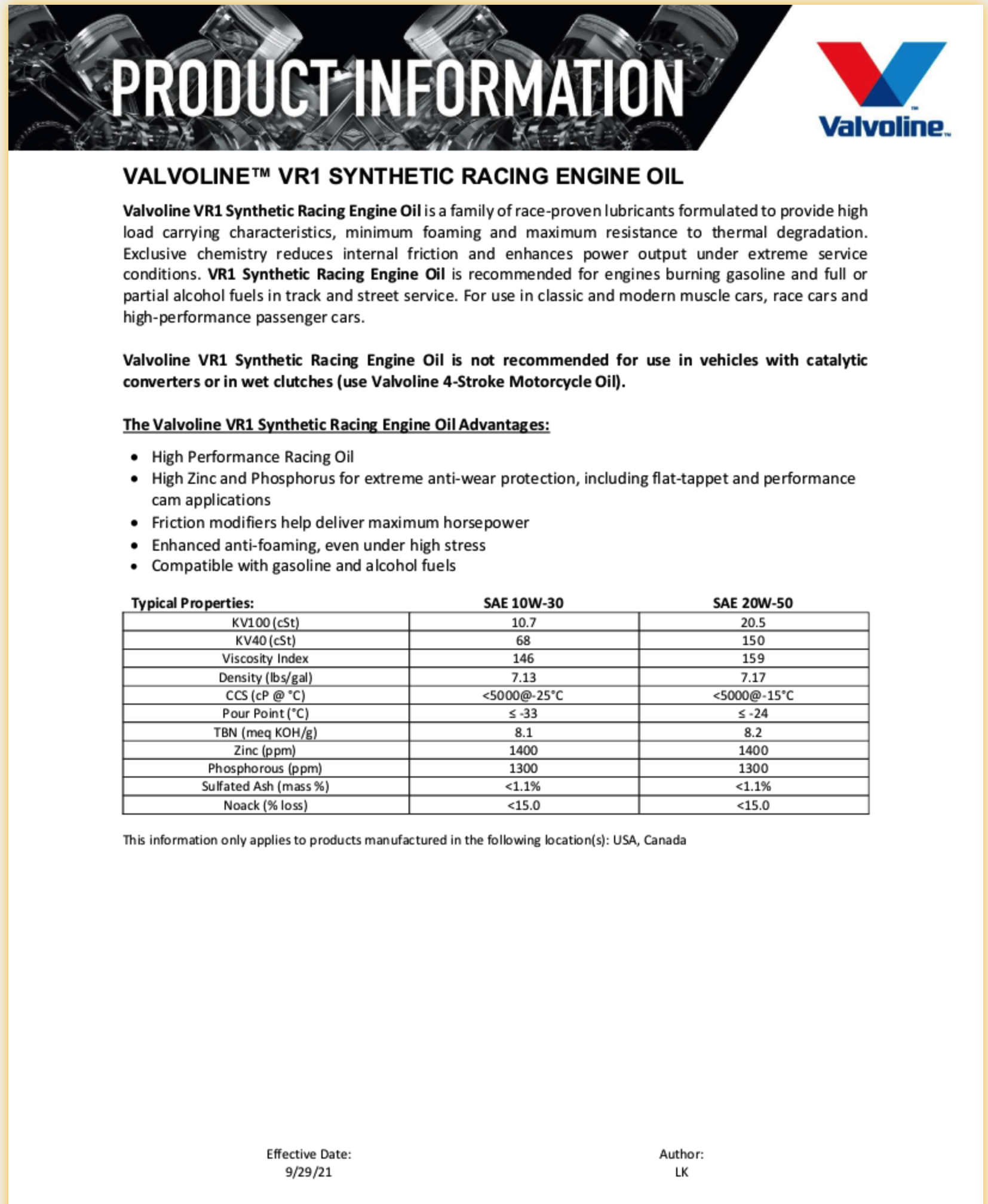

vitamin914
I realize we are drifting off the too much oil question (a bit extra not likely, a lot more yes), but...
What is the tribol knowledge (yes, pun) on VR1 Dino vs VR1 Synthetic?
I have been told by the high priests of the oil religion that our 914s were made for Dino and should always have Dino oil... Never use anything other than VR1 Dino!
I think this comes from "everyday" synthetics that reduce the zinc and phosphorus for catalytic converters. I agree that these typical synthetics should not be used in tappet engines without an additive ZDDP additive..
The VR1 Full Synthetic should give our air cooled engines the best of both worlds.
Looking at the spec sheets they have identical Zn and P amounts, Dino or Synthetic.
I have both on the shelf and as soon as I run out my Dino stock I'm moving on to the high temperature benefits of synthetics (VR1). I don't want to "coke" my Dino oil by getting stuck in an unexpected traffic jam.
r_towle
For me, and my rare driving of any aircooled motor, I change the oil in the spring, and just before winter storage, or 3k miles, whichever comes first.
It’s not common fir me to put 3k per year on mine anymore.
Always will do it this way in my oil cooled cars with air assist.
They are all oil cooled.

Van B
@vitamin914
In addition to the better temperature resistance demonstrated by synthetics, they also have less sulfur and don’t become as acidic as they are used.
IMO, the most important perspective to remember here is that all these attributes or advantages are found in the margins of use i.e. extreme use conditions or duration. The additive formulation is where oil becomes specific to particular use cases.
Hence nerdy engineers like @Superhawk996 gathering for a conference just to come up with certification codes to use as shorthand for these formulations and performance requirements.
