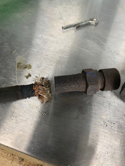

As we all know getting the brake hose disconnected from the hard line can be a pistol on older cars,
Heat always works, while doing the front end of the 914 (shocks and bushings) I am replacing the hoses - of course\
I needed to heat and started to torch blowtorch.gif this connector when BANG!
Turns out there was a very tight fit between the hose and connector, enough to hold pressure to an explosion point.
Who Knew!?! Fortunately, I was wearing goggles.
No, there were no blocks within the hose, this was not from what was IN the hose but between the hose and the connector.

ctc911ctc
**********Perhaps I was NOT clear.*********
The Line (hard line and hose) was out of the car, on the bench....
There was NO Fluid in the hose nor in the Brake-Line. Both were clear end-to-end
The pressure was from the fluid that was in the fabric of the flexible brake hose which was trapped within the connector as in the picture. perhaps less than a drop or two of liquid.......if that.........
Thank you for all of the advice, but.........
The hose and the brake line were on a bench in a vice and I could not get them to release with a box wrench and penetrating oil,,,,so I then put a torch to it, and the hose popped!
I have never seen anything like it......so I thought i would share........just in case you have a similar situation.......
