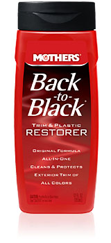

VegasRacer
May 20 2022, 09:08 PM

PanelBilly
May 20 2022, 09:21 PM
My most difficult part to make look good is the vents for the defroster. I tried painting a set and that didn't look right. Haven't tried back to black yet
