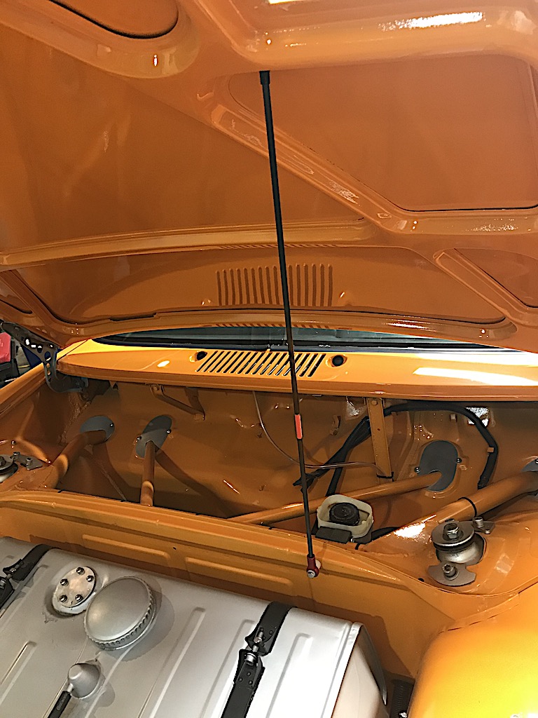

Thanks tygaboy, that is a great solution. I install a carbon fiber rod, works good and the wind has not been a issue yet but it is with a steel hood also. Thanks for sharing. MarkClick to view attachment
