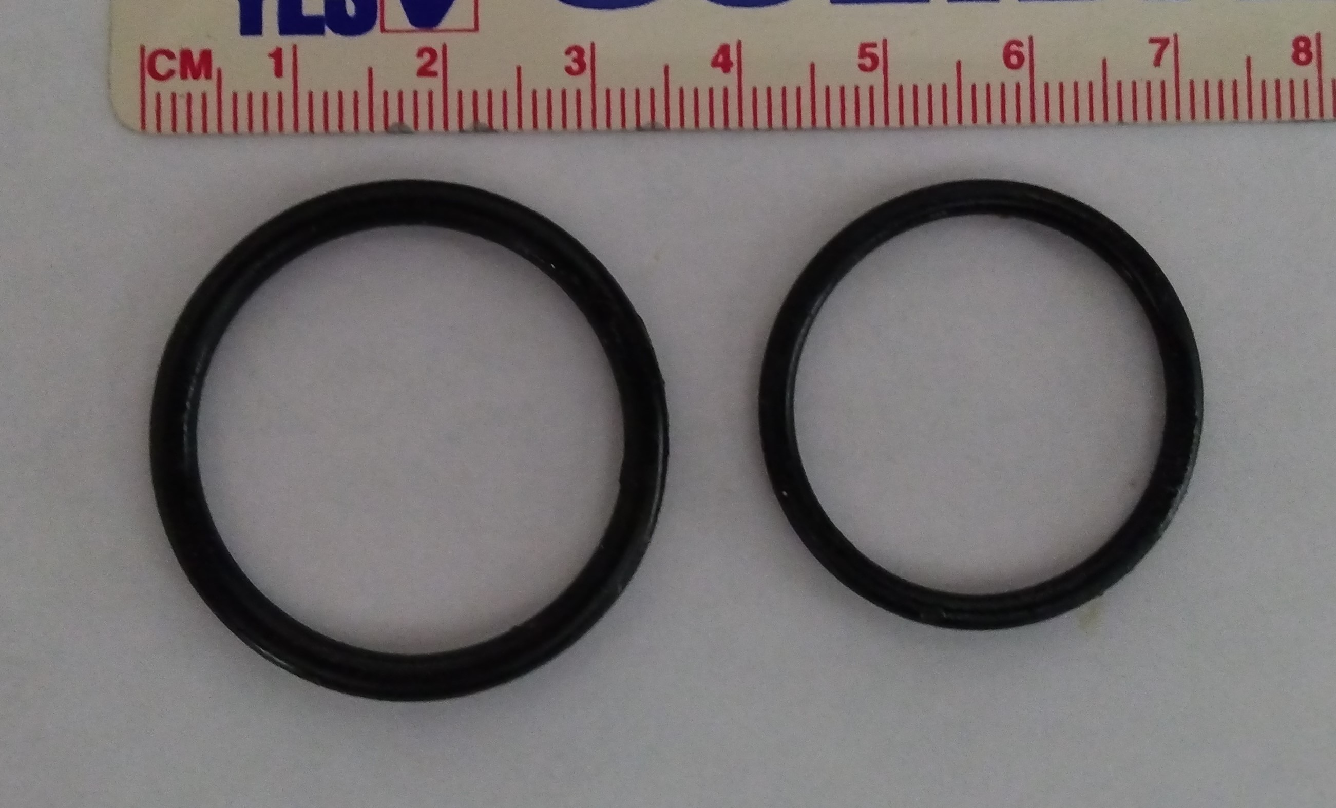

I have 2 O rings that fit over the nose of the crankshaft behind the front seal. I see no purpose of this o ring as it just sits at the front of the crank shaft. What is it supposed to seal?Click to view attachment

It might keep moisture out....

This O ring is critical. Without it oil will wick between the morse taper of the crankshaft and the crank hub. This results in oil being slung about in most cases. You can't skip installing it.
Geezer914
May 26 2022, 10:32 AM

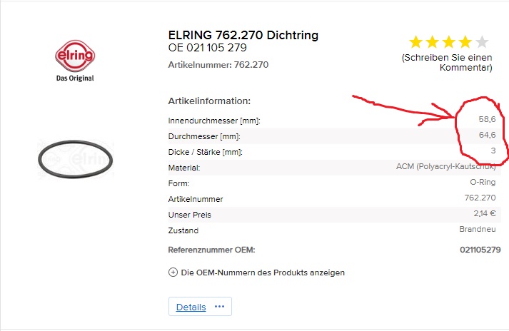

Which o- ring is correct?
914fahrer
May 26 2022, 11:46 AM
I hope this the correct one .The vw nummer is 021 105 279
