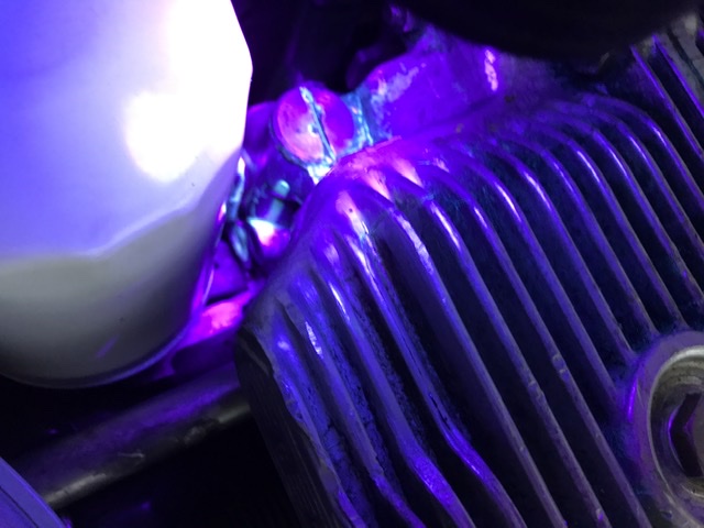

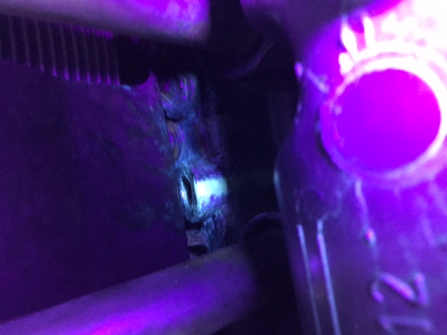

mgphoto
I’ve had a good bit of success using dye and a uv light to trace oil leaks.
