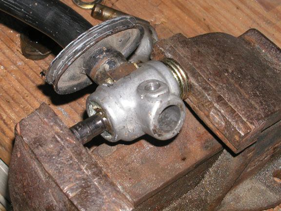

Pulled the boot cover back at firewall and this fell out. What is it and where should it go?
And what are these "cone screws" you guys are referencing? Thanks guys!
Rick986
Sorry I'm being lazy! I'm doing my homework and see the piece that fell out is the bushing from the coupler! And I think the one on the other side is gone completely. Checking...

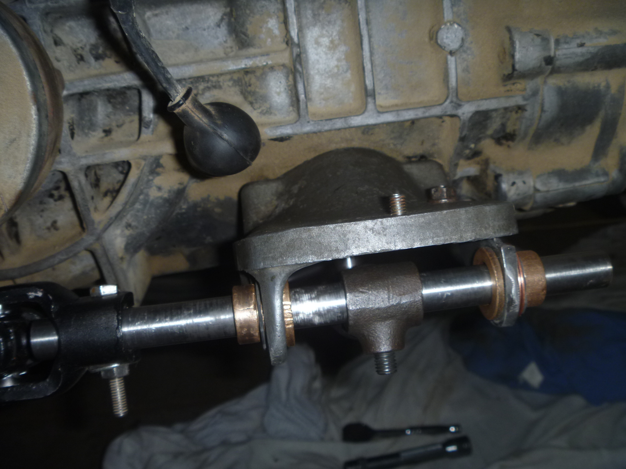

Dave_Darling
QUOTE(Rick986 @ Jul 21 2022, 02:18 PM) *
See the Allen-head fastener in your second pic? That is the cone screw. Or rather, one of them. The other screws in through the shift rod head that goes on the rear end of the rear shift rod, hiding up above the plastic boot on the side of the transmission.

The bushings in the front coupler. One was totally disintegrated and the other missing a chunk. $40 fix (thanks @dr914 ), including two new cone screws. Took me about an hour. Getting that pin out is a bit of a bitch! Impressive difference in shifting!

Why brass bushing ? never seen the point of them,same effort to fit the stock plastic ones ,admit there is some great aftermarket parts to improve shifting with our cars but IMO these are not one of them.
My system is far from stock and is custom built due to 6cyl motor but I found the Tangerine bulkhead bush was the best improvement from the loose fitting factory stock one,second best was going to oilite metal bushes in the shift console after going to dual bushes and rear shift rod uni-joints x 2.
This setup isn't for everyone but certainly look @ the oilite bush from 914worke for the rear console and the Tangerine bulkhead kit ,both of these remove lost motion from the system which can hardly be described as perfect even when new.
Good luck
Click to view attachment.
P.S. the pic is early development of this conversion,somewhat refined later on.
