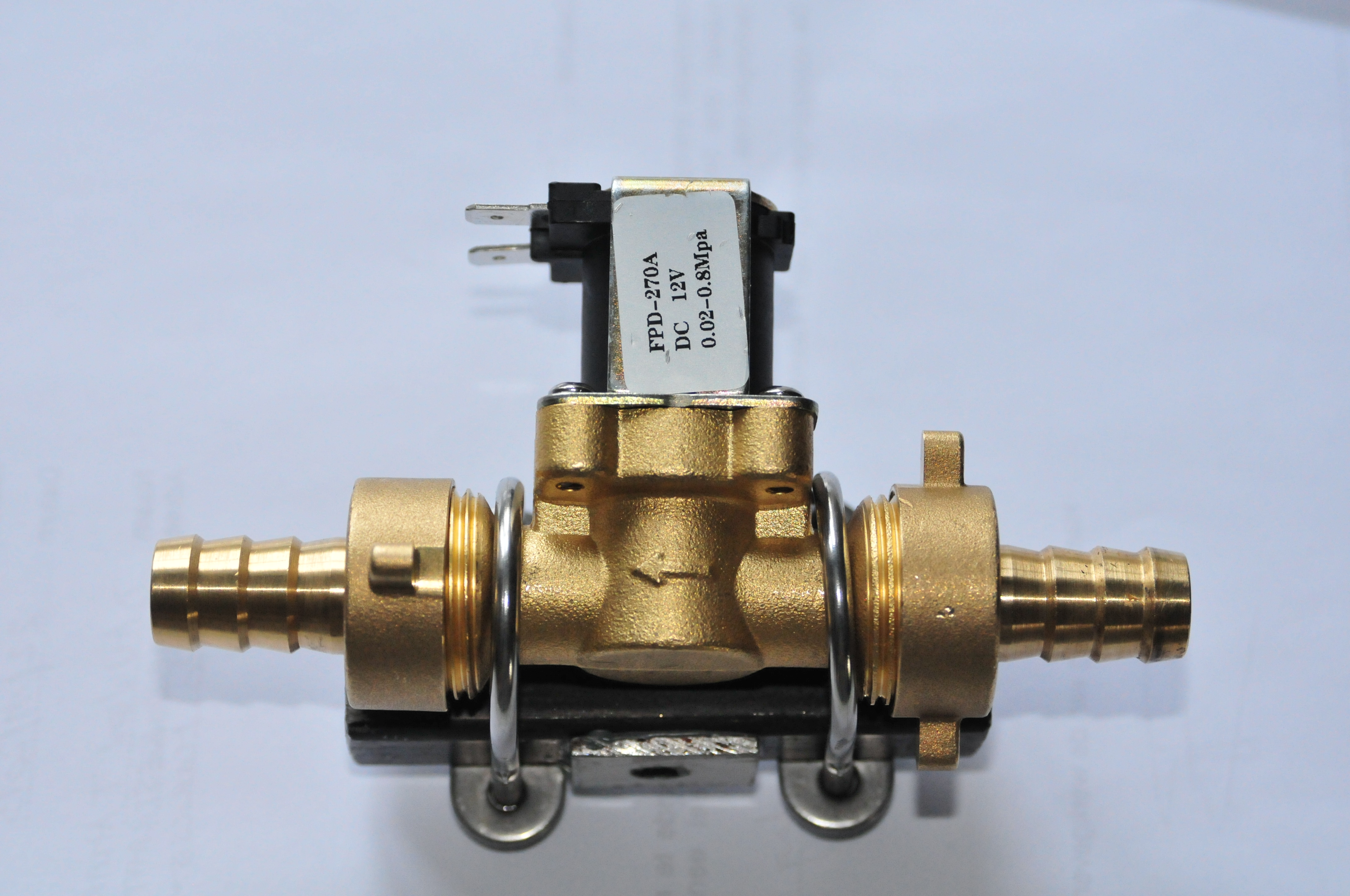

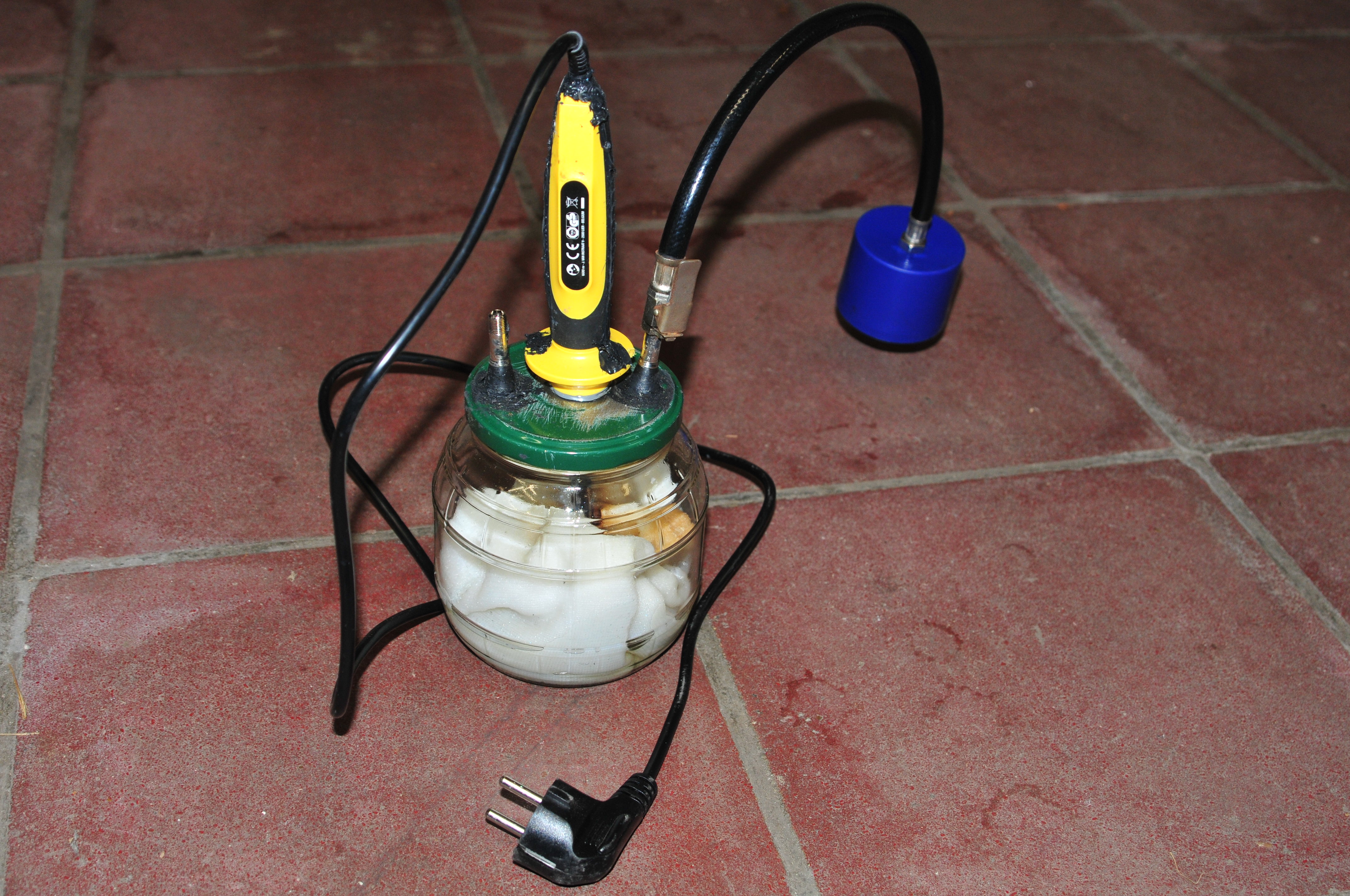

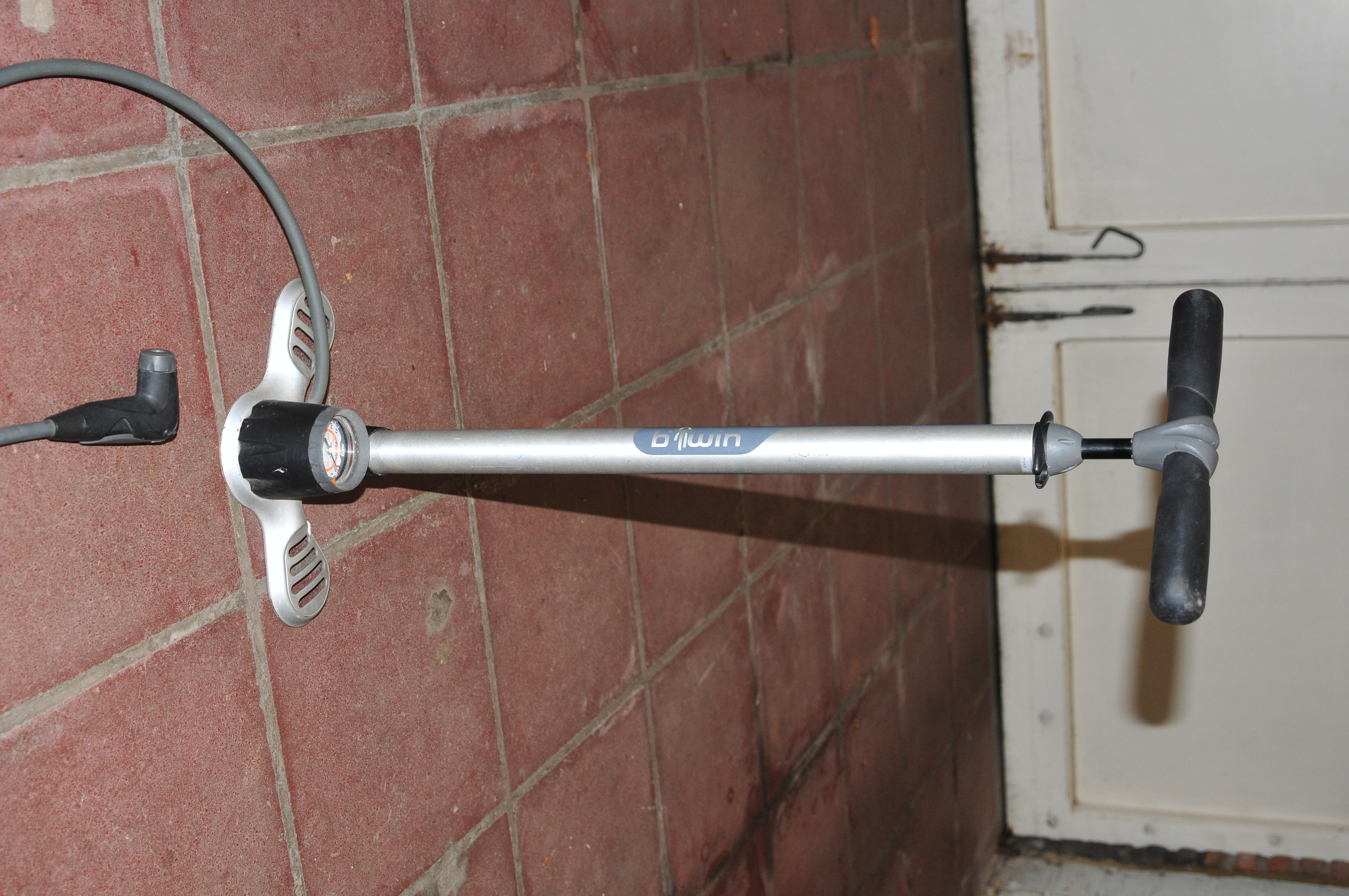

slotty008
Mar 18 2023, 04:55 AM
Now that I'm retired, I've finally found the time to finish the smoke machine. I used a pickle jar, 2 car valves, an old bicycle pump, a 10€ soldering iron and an old tube from a tire pressure pump. I had to seal the car valves and the soldering iron with Tec-7 because too much smoke escaped there. I mounted a lid from an aerosol can on the tube of the tire pressure pump. It fits exactly on the throttle body.
Yesterday we did the test and a little smoke is escaping along the axle of the throttle valve. So I will have to look for a better throttle body or find someone to repair it. All the vacuum lines were tight.

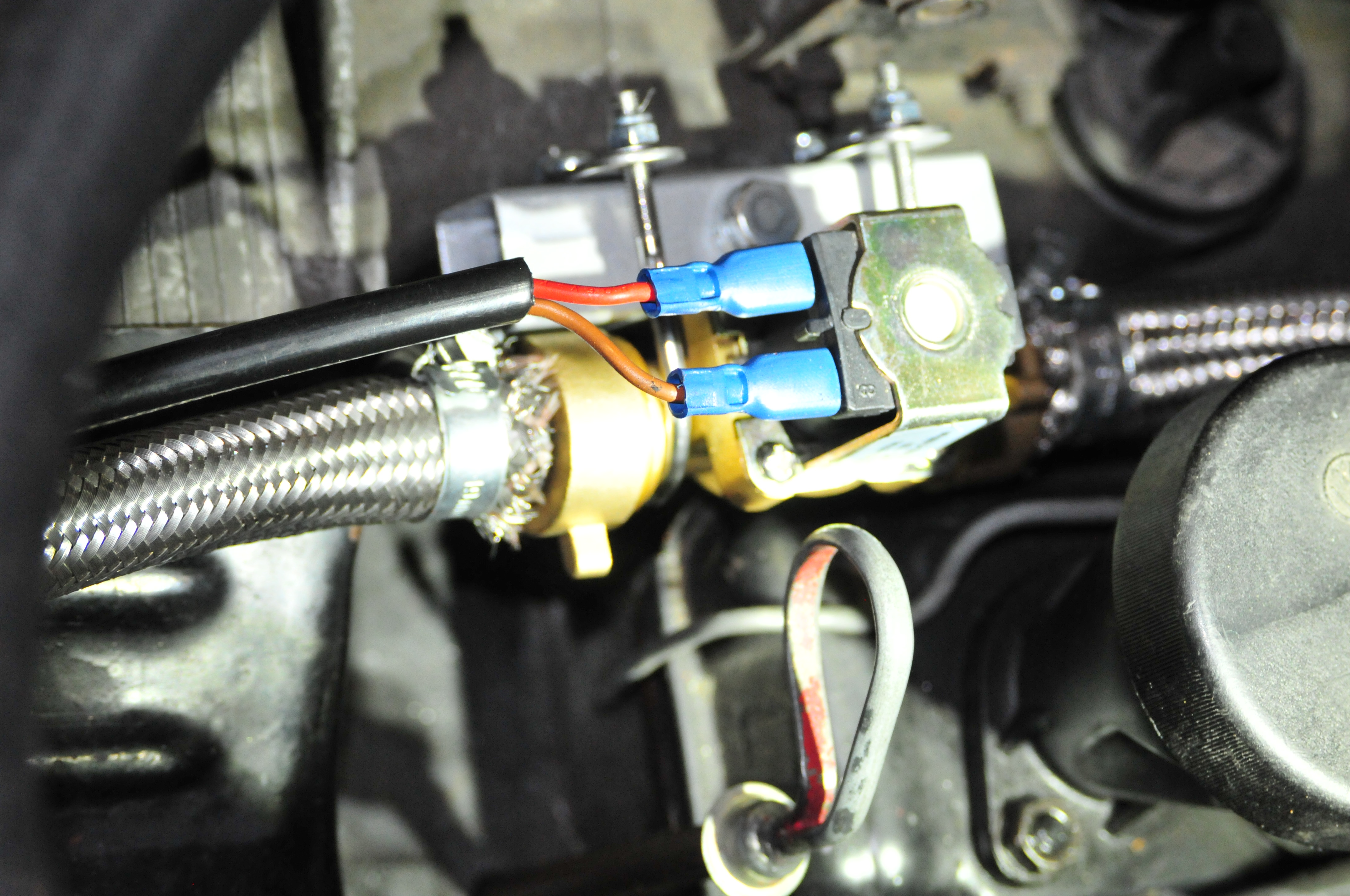

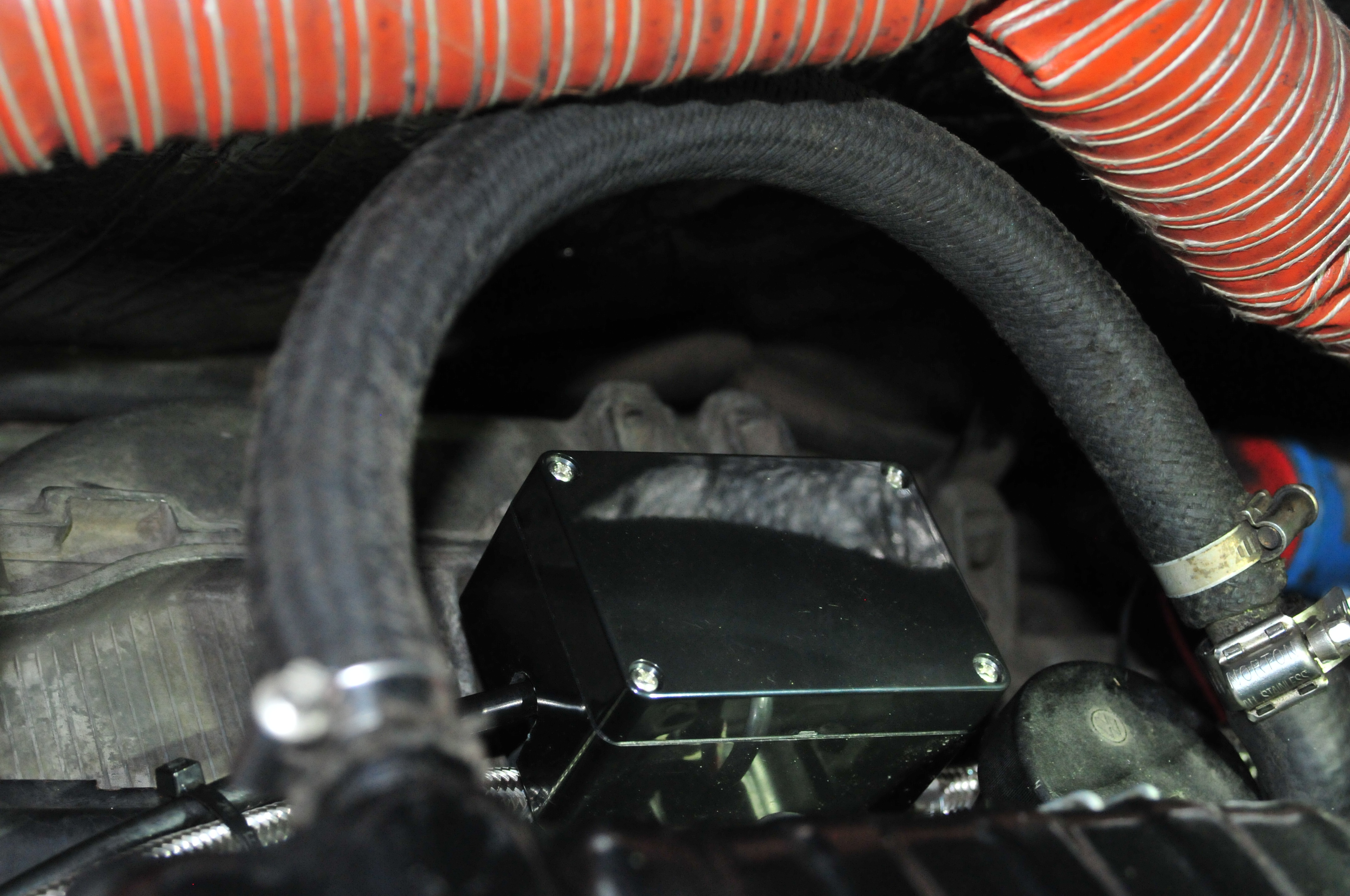

After disassembling the AAR several times, I gave up. Once installed , everything went fine until the next day and then it jammed again. So I constructed a system with a solenoid valve instead of the AAR that I can open or close from the cockpit. I open it when I start the car and after two minutes I close and I have a 1000rpm idle. It's not perfect because it's all or nothing but certainly better than an unreliable AAR.
slotty008
Mar 24 2024, 09:25 AM
slotty008
Mar 24 2024, 09:28 AM
I've put a box on it to protect it. The bottom of the box has been cut out.

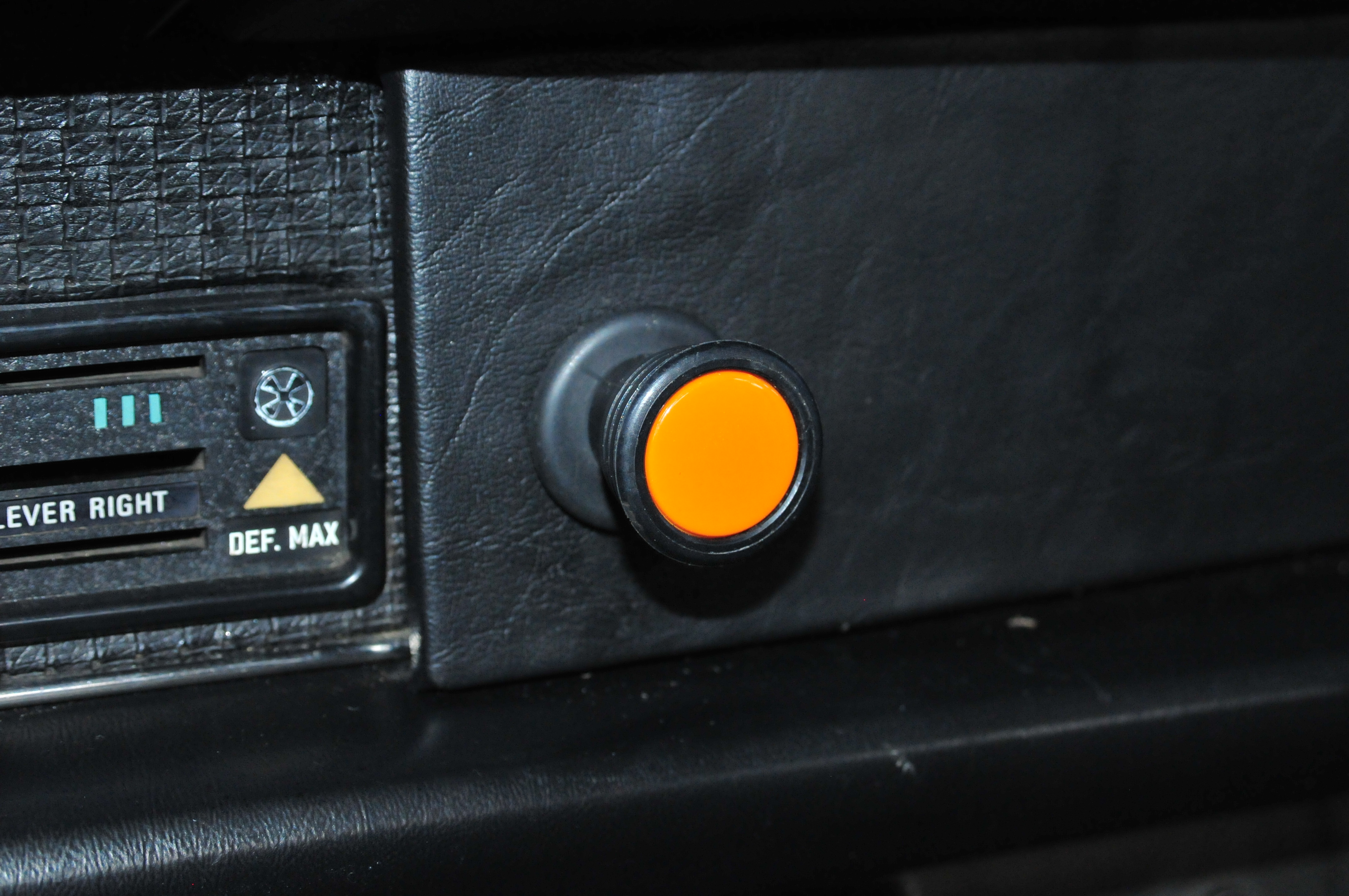

slotty008
Mar 24 2024, 09:33 AM
And this is the knob in the cockpit.

emerygt350
Mar 24 2024, 02:59 PM
QUOTE(slotty008 @ Mar 24 2024, 09:33 AM)
Click to view attachmentI like it!
