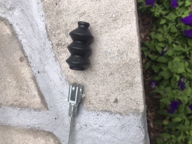

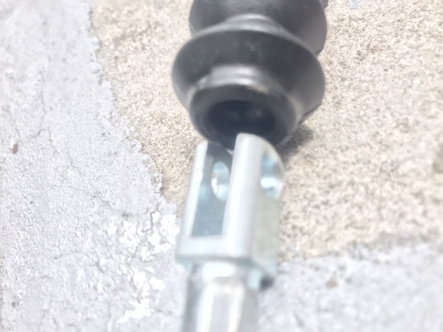

Finally bought two of the rubber bellows that fit onto the rear end of the parking brake cables, next to the calipers. The cables are in place but cannot figure out how on earth to get the bellows over the much larger end clasp - or even the smaller hole on the other end could ever get over the clasp (with the cables in place there isn’t much geometry to assist leverage).
Any tips or tricks to doing this?
See pics.

I haven't tried this specifically, but I think if you soften the boot up with some glycerin, you'd be able to expand it enough to get it through without tearing the boot. I recently did similar pushing the side marker connectors/wires through their boots.
FJ1200
Needle nose inside. use them to stretch the boot and pop it on.
Mikey914
Lots of lube, It will stretch. The really hard ones are the ones at the firewall. That's why we started making the cables too. Not much more to just replace rather than fight them. biggrin.gif

Dont forget to install they cable first before the bellows. I dont think the cable will fit through the trailing arm with the bellows already installed.

Thanks, all! Great suggestions, especially needle pliers - I have really long thin ones.
