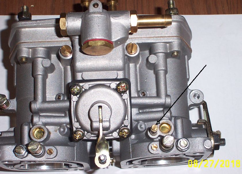

2) I have Weber 40 IDF 19 's with no vacuum port

Look at my carb! no where to drill, i should be able to add the vacuum port to the intake on both sides, right?
bbrock
You want the vacuum port for advance to be above the butterfly on the carb. That way it pulls vacuum as you open the throttle. Ports below the butterfly are for vacuum retard.

I guess i'm screwed. Can't really drill into the carbs!
bbrock
Check out this thread and especially the last post: https://www.thesamba.com/vw/forum/viewtopic...e08bc9f7ed5c6dc
There is also some good info on this thread but it also goes on a confusing, and I think misleading tangent about ported vs. manifold vacuum, but there is some good info on drilling carps for ported vacuum that don't have the boss. http://www.914world.com/bbs2/index.php?showtopic=162620
Bottom line is that you can still do it.
