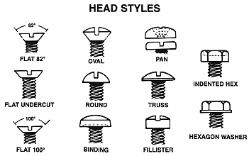

914Sixer
This is a pan head screw. Parts were generic items off the shelf.
NARP74
That's what I call a pan head screw too. When i look up the part number in the PET I find a socket head bolt. It looks like the word description and the part number are two different items.
So which is correct? Does this happen a lot in the PET?
