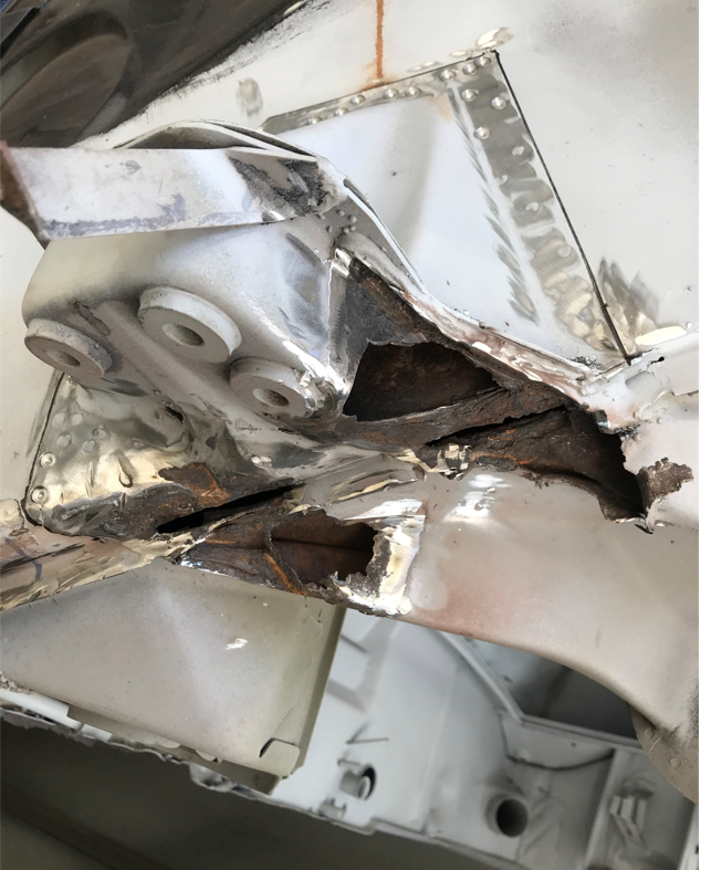

I'd just hold off till you get in there and check it all out. Mine were really bad but both were repairable. I soaked them in a bucket of rust remover. That really did the trick for the insides. Any holes were simply repaired with new metal. The most important thing to remember is the piece HAS to go back in the exact position not just left-to-right on the panel but also vertically, on the panel. I would recommend creating a jig the bolts into the outer's suspension "canisters". That way you know for sure, 100%, that it's going back on in the exact same position.

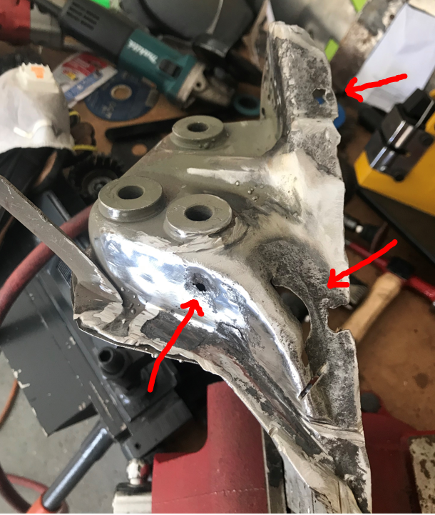

Passenger side (with holes that were repaired):
Click to view attachmentDrivers side:

I made some progress today. Removed front and rear suspension. Im not discouraged like I was yesterday. The inner console definitely will be replaced. I think I can get away with welding g the outer in place. Overall it seems pretty solid. There is a nickel size hole that doesn't go all the way through and is solid surrounding it. I think I can fill it all in and grind it smooth. Here is a picture of what I'm looking at. The bug gaping hole will be partially replaced by the new inner console and the rest I will cut back and weld in a plate. Thoughts??

Hmmm. I'd cut/pull/peel that gusset off. That's the only way to see what's really going on between the inner and outer console. You can buy a new gusset kit for cheap - $35 -

worn
Sep 1 2022, 04:25 PM
QUOTE(Wadesbrain @ Sep 1 2022, 02:25 PM)
Exactly where mine rusted away.

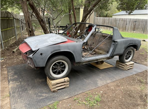

Got to do a little more yesterday. Right now I'm stripping everything out so I can blast what is left. Im bracing everything I can before it goes on the rotisserie. So far it is all straight.

930cabman
Sep 11 2022, 07:52 AM
QUOTE(Wadesbrain @ Sep 9 2022, 02:03 PM)
Lookin good. The lengths we go to for our 'entry level' sporting machines??
Keep up the good work and continue to post your progress
